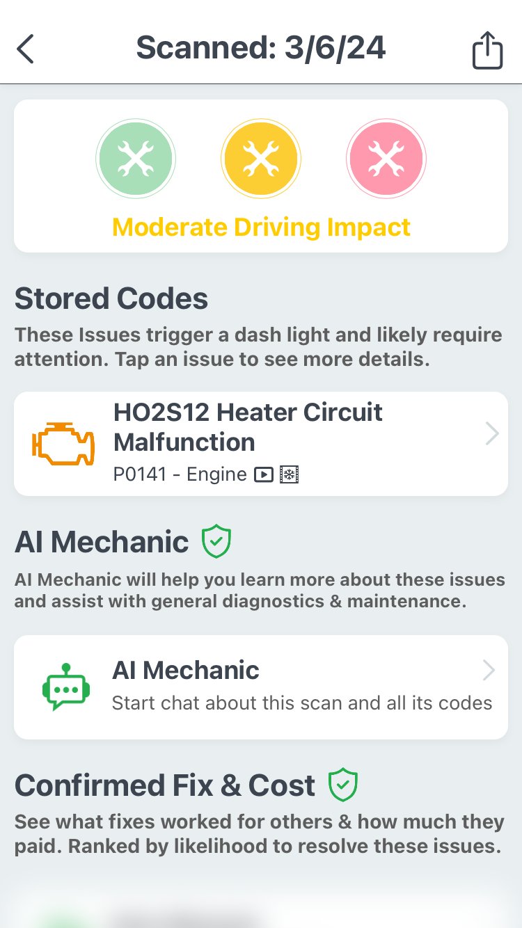

    Yes, relatively easy DIY if no rust involved. Crow's foot is handy for removal and replacement of the sensor. I would just do them all at this point in their life cycle. Soak them with some penetrating oil for a couple days ahead of time to make removal easier.

    Yeah to add to my last I rented an O2 sensor socket from a parts store to get the two up-stream sensors out. Came out no problem just a bit of a tight access point. I'd consider new M6 nuts for the downstream sensors, mine were almost non existent from rust.

    Now to find the part numbers.
    My truck has minimal rust but I’m game to replace my nuts, always best to keep those fresh :)

    I went Rockauto for mine but you may confirm part numbers on the Denso site @shifty` always recommends

    Oh we can’t order from a dealer? I only see pigtails.
    For my v8, it looks like maybe 2 each of
    234-4169
    234-4162
    Is that right? Left and right sides, upstream and downstream? Then hunt for deez nuts?

    I thought the heater circuit was only on the downstream sensors?

    All of them are 4 wire O2 sensors I believe.
