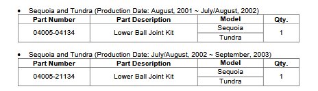

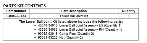

    Here's some information from the recall letter for the smaller lower ball joints, they don't give a "parts list" for the recall kit like they do for the bigger ball joints:
    https://static.nhtsa.gov/odi/rcl/2005/RCRIT-05V225-9101.PDF
    http://media.fixed-ops.com/Toy_Campaigns/50Jdeal.pdf
    Per @BubbaW 's research, the early recall kit may not come with castle nuts and cotter pins.
    Here's some information from the recall letter for the bigger lower ball joints: http://media.fixed-ops.com/Toy_Campaigns/70b.pdf
    They give parts for the ball joints, but this kit seems to be no longer available mostly. Additionally, I can't find these LBJ parts numbers separately, and the current LBJ numbers don't say whether they're a supercession of them. I'm not gonna dig any further right now.

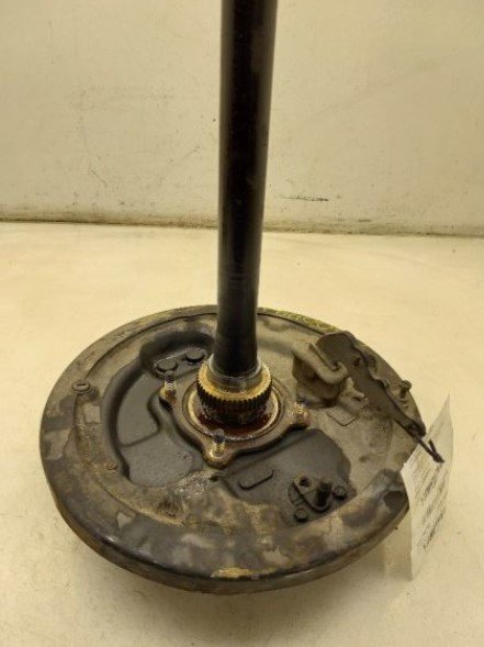

    So are the rear bearings part of the axle or something? I did not see rear bearings listed on the parts website

    They are pressed onto the axle half-shafts along with the tone ring for the wheel speed sensor / abs. Many a good man has lost this fight. If you're off by even a little, the seal won't make contact well enough to keep the gear oil from filling your rear drum.

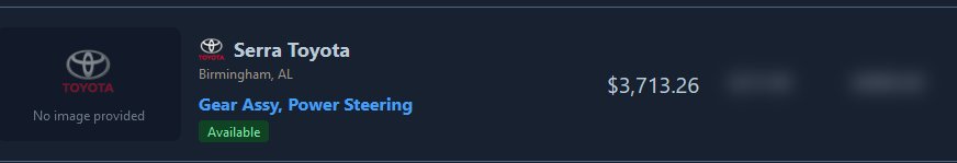

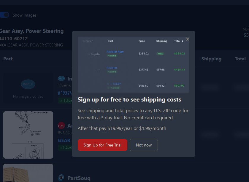

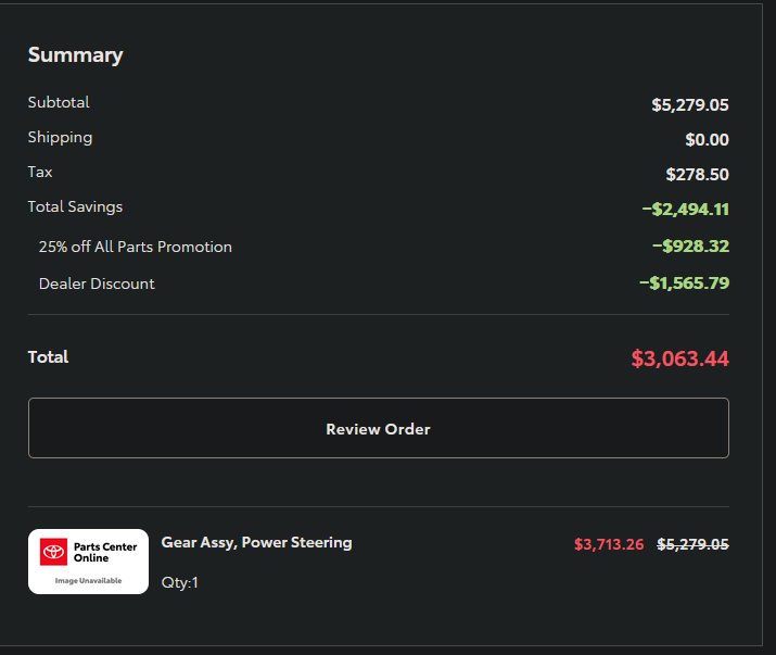

    Sounds like you'll still have to do some homework to compare shipping and tax between sellers. Also it doesn't take into consideration promotions like the 25% off Serra Toyota is offering.
    This is the price with the current promotion once you add it to your cart and go to checkout.

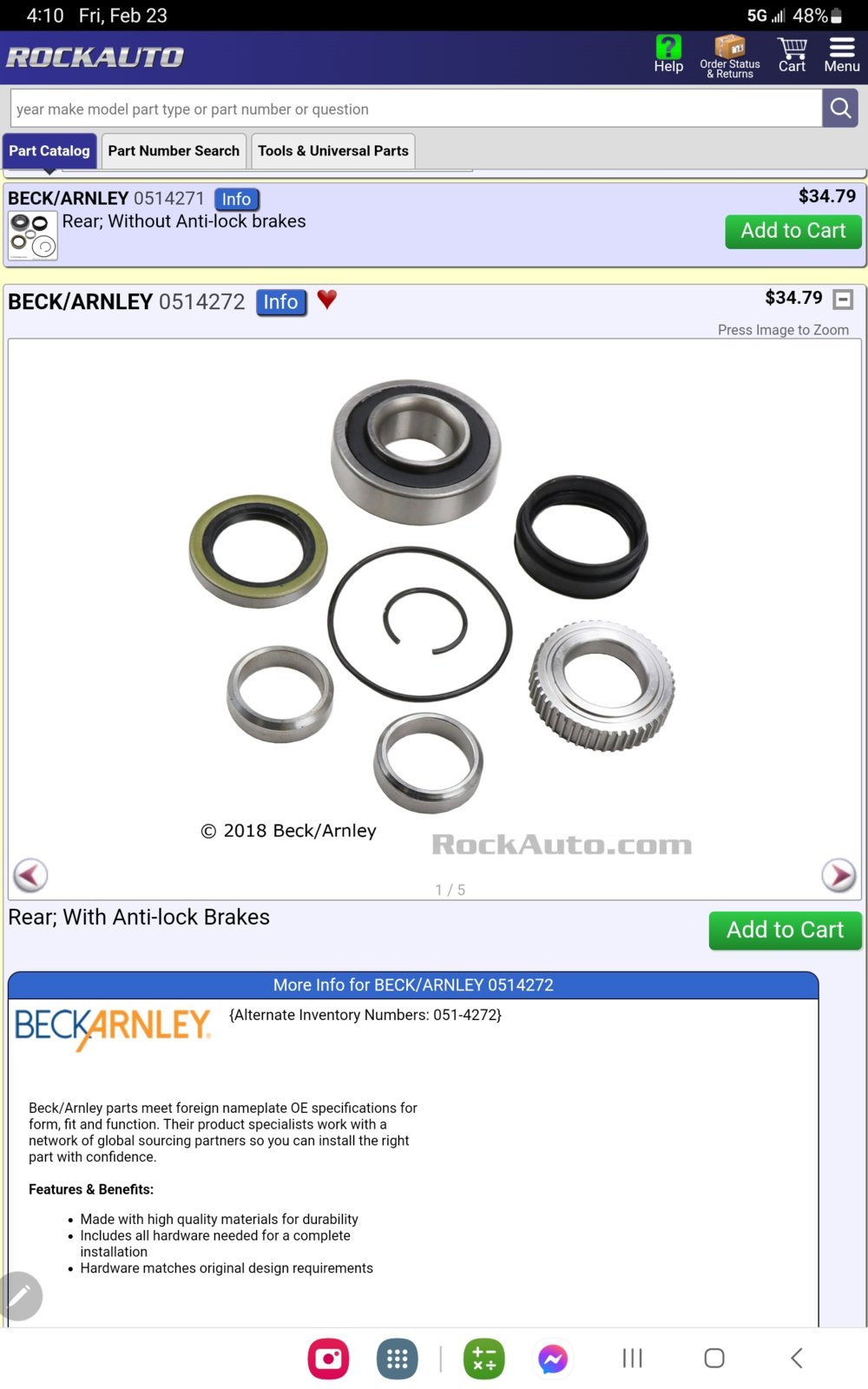

    This is what I used, even though it's not the recommended bearings.
    In that thread you were reading, I posted about my adventures with the rear bearings. I'd read through that too as a what not to do guide and what happens when you take it to the wrong shop.
