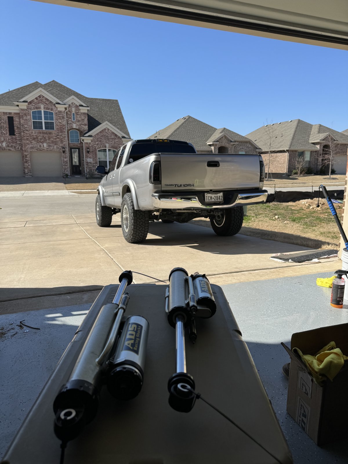

    Yeah this should be fine. Fresh rebuild and now we’re waiting on the fab shop.

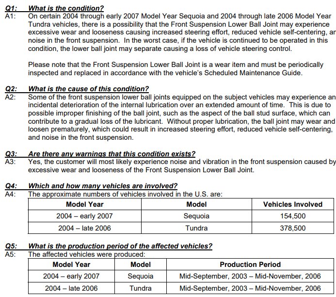

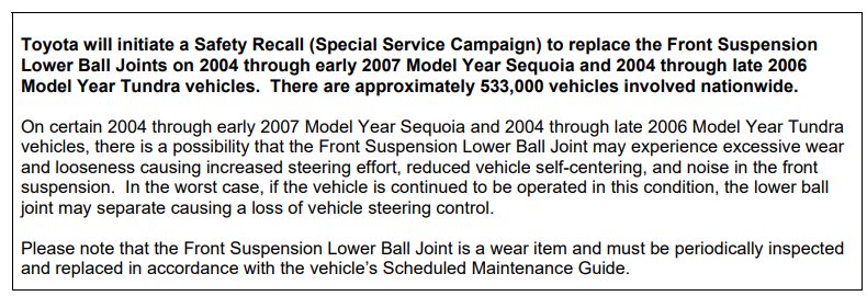

    I had this convo separately with another '00 member. We couldn't find a recall that included the '00. But several recall campaigns for subsequent years.

    The recall wasn’t due to poor design, that remains. It was due to poor finishing of the ball and cup surfaces and grease that prematurely became ineffective as far as I read. The 2000s were not affected by the recall, the bad LBJs were produced after.

    But they did redesign the ball joints at some point to make them slightly better right? I still see the newer first gens having LBJ failures though. I wonder if those are OEM that never got replaced or aftermarket.

    They made them slightly larger with newer knuckles, but the design remains the same.
