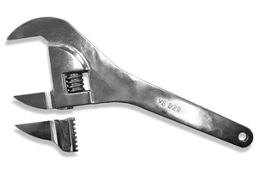

    I did mine around 230k miles and I’m still on my original rack. Not hard to do, need a skinny wrench to tighten the inners. They have a large 6 sided nut molded into them but it’s up against a shield that keeps you from using a wrench large enough. Needed a wrench that was 1/2 as thick to fit in there. Very easy to swap them otherwise.

    Did you have to go buy a skinny wrench or grind one down to fit?

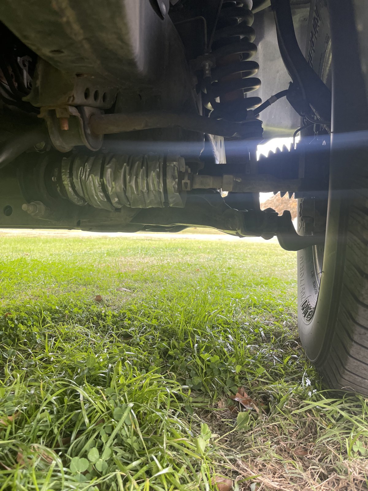

  18. Dec 19, 2023 at 2:03 PM
    Mr.bee
    Mr.bee King Turdra
    Jun 4, 2022
    #79178
    6,424
    SATX
    '02 AC TRD
    Duct tape bellow holding up just fine. Been aboit 2500 miles.

    Some day I’ll buy a v8 tools skinny wrench…
    FrenchToasty and KNABORES like this.

    Hard to justify a $48 wrench you use once every few years.

    Thats why you borrow a buddy's. In my case I have 17 buddies with tools like that.

    Or once ever. Cheaper to get a spare single wrench in that size and grind it down skinny.
