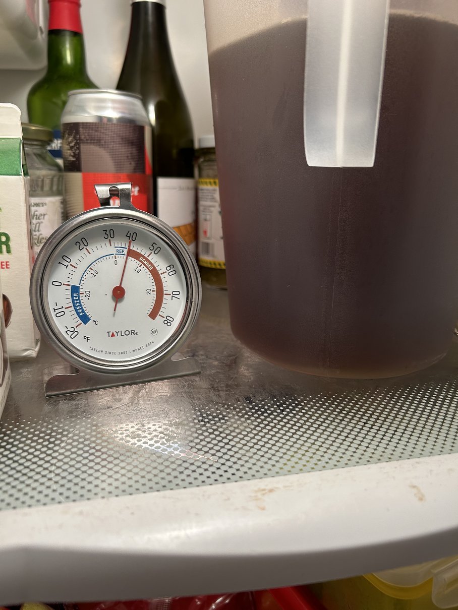

    Possibly. I'm keeping eyes on it. Temps are continuing to drop. This day has led me to drink, and when I just went in for another beer - gotta drink it before it gets warm! - it was down to 50°F, so I'm really hoping there's nothing else to repair. Just need to limp thru for a few days until I can get a new fridge in. I'm good with 21 years of service for the shit-tastic appliances available these days.

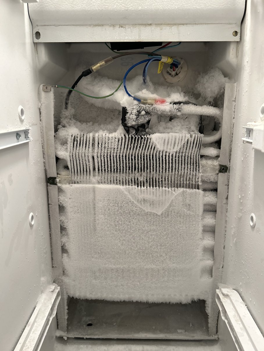

    @shifty` is it a sxs fridge? My garage fridge would freeze up like that. And i had a pizza box or somethimg blocking a hole down by the fridge drawers so fridge air couldnt circulate back to the freezer side. But once a week i'd pull that back panel & defrost it with a space heater. Also didnt help that i was freezing gallon jugs for the fish tank

    Side by side and it's remained pretty packed up. Down to 44°F now. I'm hoping I bought us another couple days. Freezer is already freezing, got some cubes in a tray starting to skin over.
    It's totally possible I fixed the immediate problem; just glad we've got a deep freezer. Just pissed this has eaten up most of my Saturday.

    @shifty` - check the defrost timer, defrost heater for continuity and if those check good check the defrost thermostat and defrost sensor. My 20 yr old Whirlpool stopped cooling couple years ago and I found some good troubleshooting vids on YouTube. It was during Covid where could not find a new side by side. I think I fixed it for about $30 and still working today

    I spent my Saturday morning doing the same thing to my Samsung. They are notorious for this failure. In case you decide to buy a new one, I suggest you avoid Samsung.

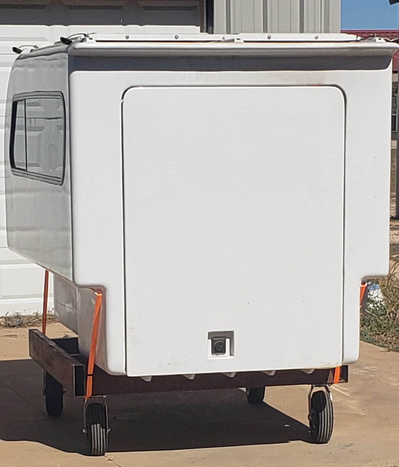

    Slapped together this cart for the camper, should have done this a long time ago.

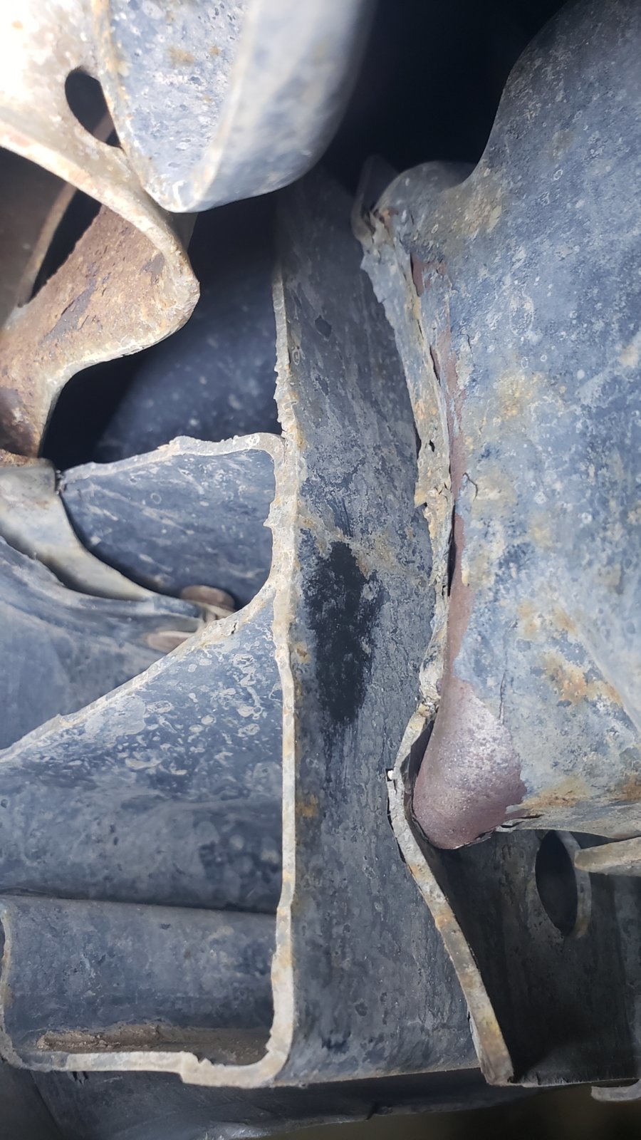

    Took the truck by a trusted locally owned body shop earlier this week, their estimates guy took all of 30 seconds to say "yeahhh this thing is likely totaled" His concern lies with the forward most frame ends. They are crushed/deformed for the first 1/2 to 1 inch. Not really a big concern for me as ill just trim them back and cap them for mounting a fabricated tube and plate bumper. Something like the addicted off-road design with some tweaks.
    Truck goes to the bodyshop with the "in house" insurance adjuster on Wednesday. Seems like a weird setup to me as I've always just had an adjuster come to me, but its been 10+ years since I've dealt with insurance in this capacity.

    Welp, overnight of running and things were under 40 until I rearranged some crap in the fridge...
