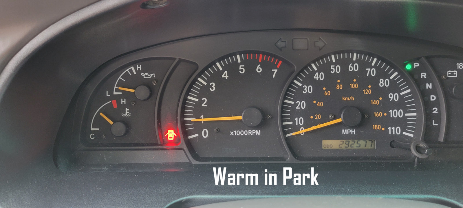

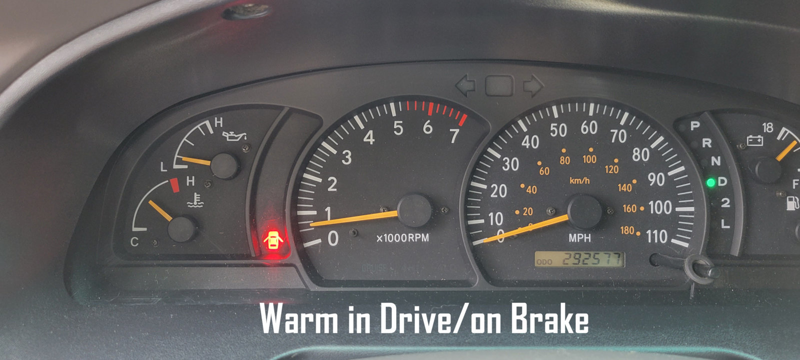

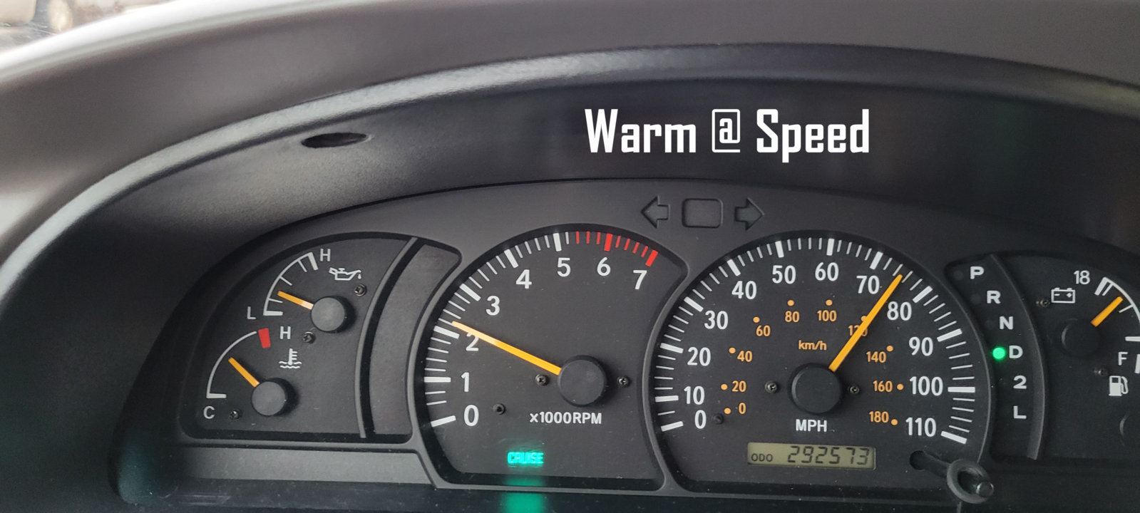

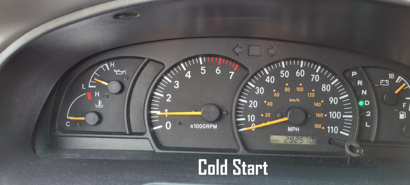

    Just for the hell of it I snapped some pics of what mine actually reads just a few minutes ago. I know it's an over beaten horse, but it was interesting. About 9 min on freeway, according to the pics name tags. I gave up on figuring out my 900 fkn Idle... o_O

    if you've got 3.90's i must have 4.10's because i'm closer to 2400 @ 75mph. 2200 is 69-70.

    You clean your throttle body and MAF? Make sure all of your vacuum lines are good?

    There is a TSB out there regarding the OEM oil pressure sender reading low...

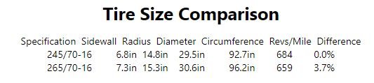

    Could be tires too.

    You think the 245 trucks have a different speedo gear than the 265 trucks?
    but mine is a 265 truck, so should have the lower whatever.

    Yeah 3.93 i think it is?

    Yes, but i have a stethoscope now, so Prob wouldnt hurt to poke around those lines again. MAF was changed, which I realize could be it too (picky about some sensors) I could throw the old one in and just see.

    265/70 16s

    Just to make shit difficult, there is a 3.93, a 3.91 and I believe a 3.90 but you'd have to fact check that last one
    @empty_lord would know

    THX Shifty, yeah I looked for that couldn't find it. I swear I carb/brake cleaned that sender out last oil change.
    fuck you do so much shit you forget wth you did. I'm not a detailed record keeper.

    Guilty here, yup. I dunno how old you are, but it gets worse with age.
    I tuck away notes everywhere. Which usually works, as long as you remember where you stuck the note.
    I'm attaching the TSB here, it's for 00-04 Sequoia, 00-02 Tundra.

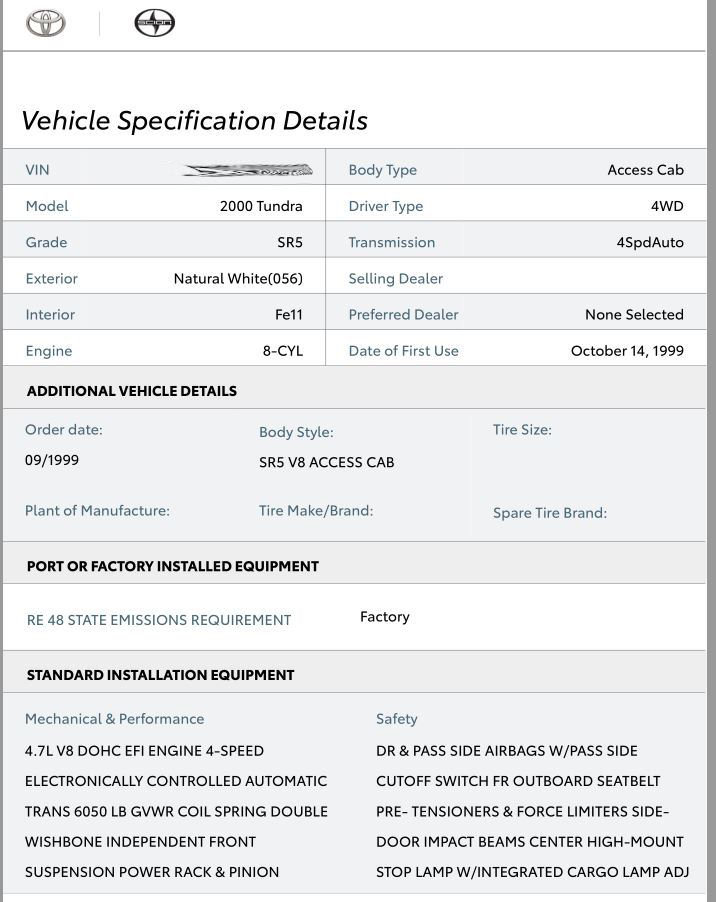

  17. Oct 16, 2023 at 7:48 AM
    BroHon
    BroHon Bitch in the Mitten
    Sep 19, 2023
    #104169
    2,790
    Bro
    Location: Bitch Mitten
    2000 SR5 AC 4x4 4.7
    Sketchy street barnacle
    Here is her birth certificate

  19. Oct 16, 2023 at 11:39 AM
    assassin10000
    assassin10000 New Member
    Oct 27, 2020
    #54157
    2,276
    Andrew
    Northern CA
    '05 SR5 AC 2wd

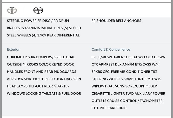

    3.909 (4wd) & 3.916 (2wd) iirc.

    Have to factor in that I'm running 265s instead of stock size 245s, according to calculations that is a 3.7% I need to add to speed reading/gas mileage calculations etc...
