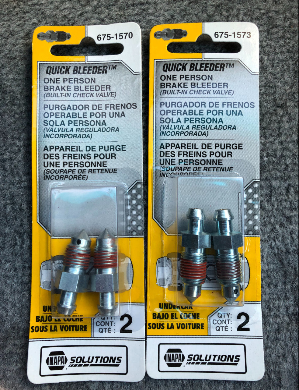

    NAPA has them. Two sizes. One size for front and one size for the rears. Remind them you upgraded to the WL13 on the fronts as they have a different size bleeder.

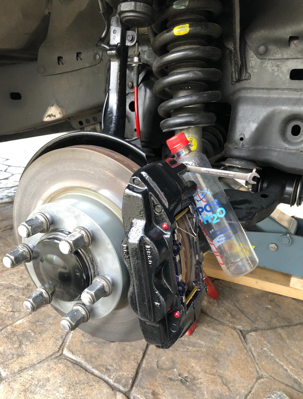

    These are one man bleeders I am discussing, as well. I’ll post up a pic of them. Make sure you confirm with NAPA the proper sizing because the WE13 and WL13 have different part numbers. I use a plastic bottle with a hole punched in the top and slip it on the bleeder with the wrench already on first. Turn the nut about a quarterish turn which releases the internal valve, but does not let air enter. Its a one way valve.
    Go and do a few pumps (5-10) on the pedal and come back to make sure things are good. Repeat. Clear bottle helps see if the gookies go bye-byes.

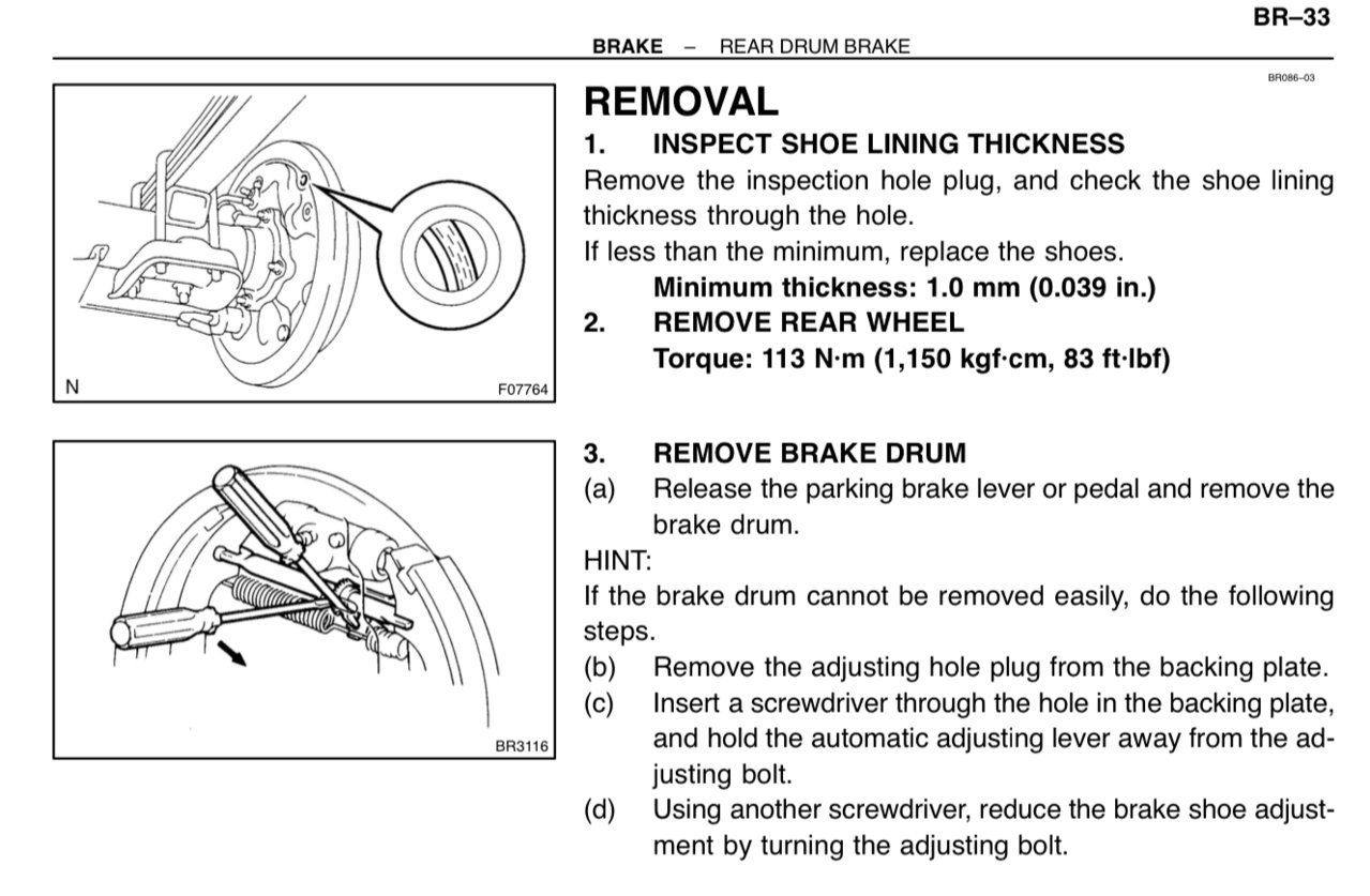

    I just posted some pics from my physical copies I made, In the oil seal section, it’s kinda fun to search by hand, get cut, find new thing you didn’t know only because you were wrong section, lots of exploded diagrams W legible torque values. I mainly lerk from a small phone so it’s hard for me to do things others do with ease. We have a tv w an apple device hooked up, but I can’t be using that all the time to be ok here, it’s a hassle. I printed what I thought I’d need the most, I printed a lot, I thought I was going to be “talked to” haha but nothing ever came from it.

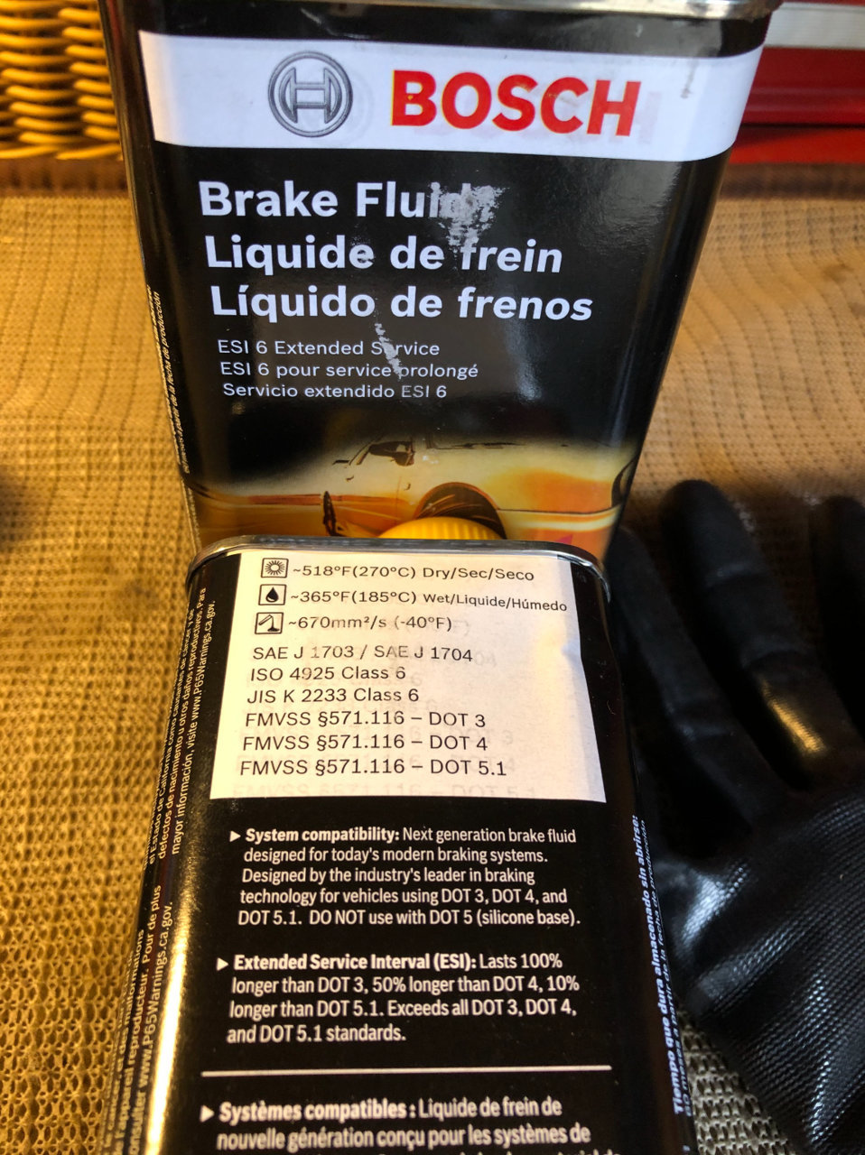

    Do a sacrificial flush with cheap DOT3 and then follow up with the Supremõ.

    Confirm the bleeder with the store before you buy because that one pictured set I posted was prior to me deciding to upgrade to WL13. I posted the pic so everyone can see how they look.

    The bleeders are high dolla at about $20 per set IIRC.
