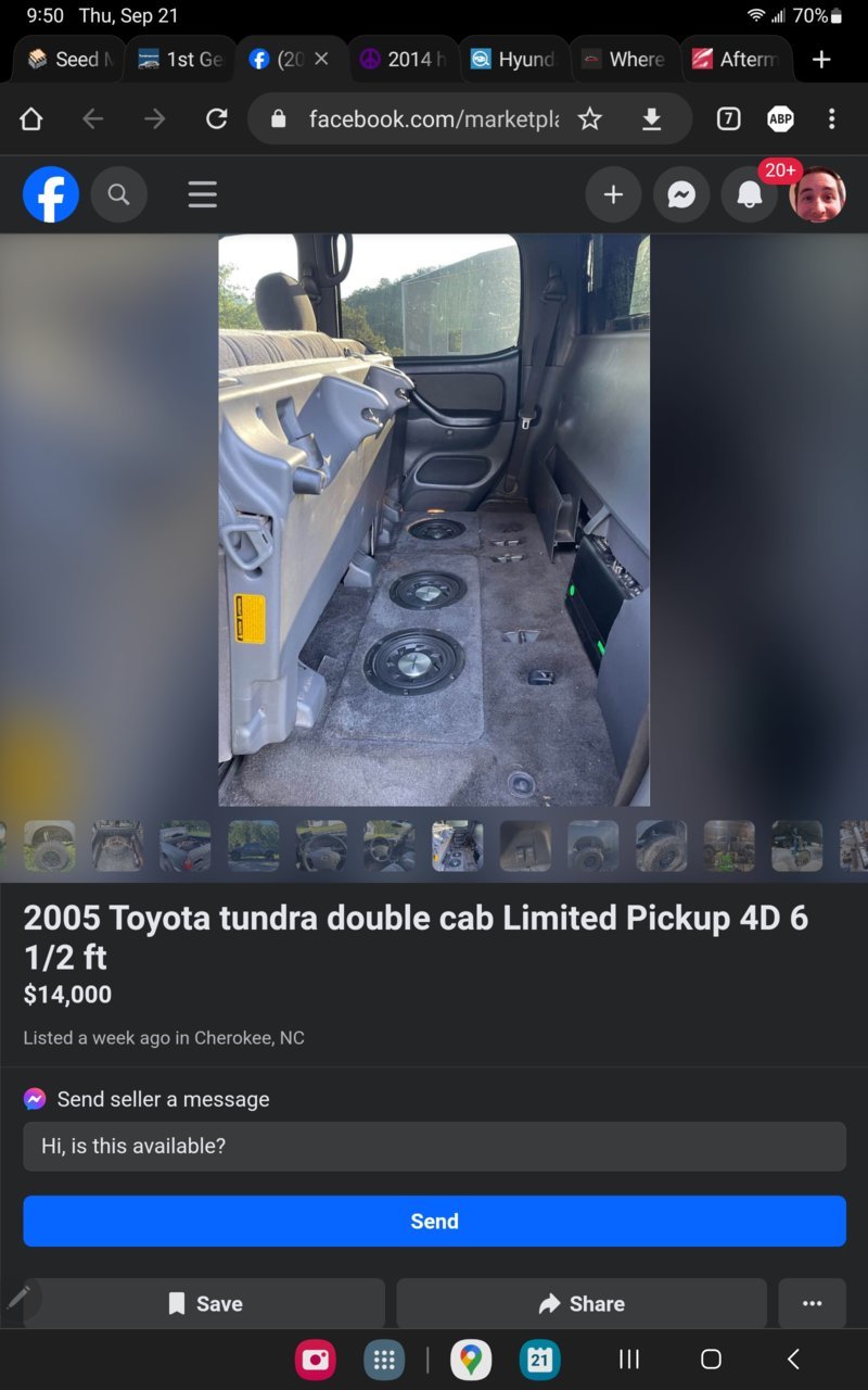

    AC bed with DC tailgate? Also the rear cab corners are dented, maybe the original bed was part of a mishap? Wreck or off-road wise.

    Nice catch on the tailgate. I missed that on my first viewing haha

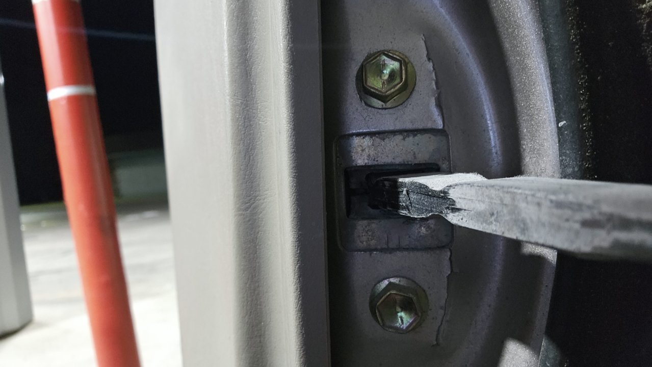

    My door check sheet metal is busted on the virus. Time to throw the whole car away :rofl::rofl::rofl:

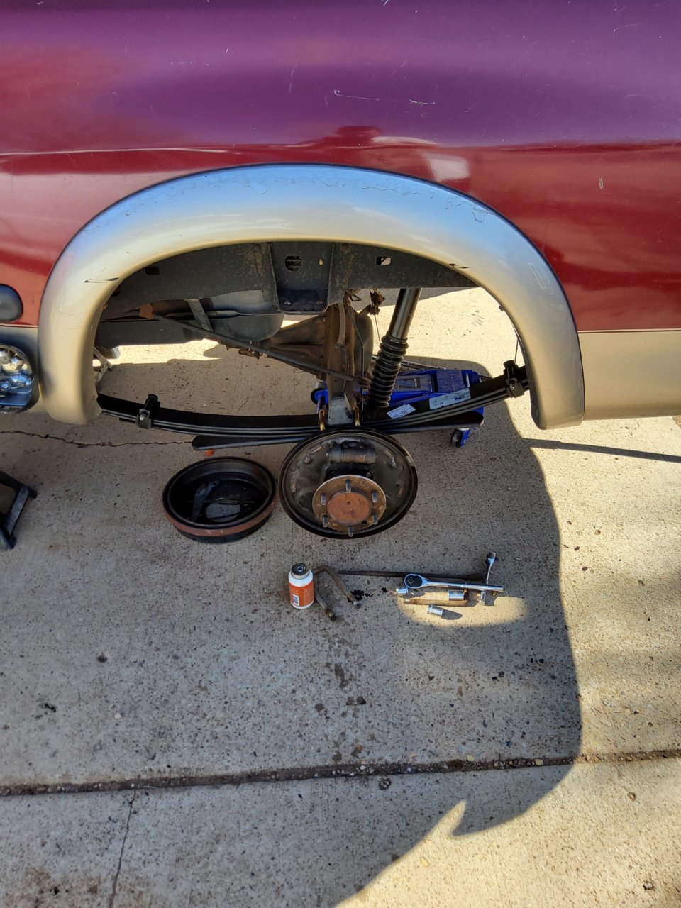

    I had to employ 3/4 drive breaker bar with a 3 foot cheater pipe to get my ubolts to either break or loosen. I picked up fresh ubolts from ATS. I hear ya about the LSPV and how heavy the springs are. I am happy with the ride though.

    Center of front through the shackle bolt to the bolt that holds the springs together. Then from back shackle bolt to through spring bolt.
    From memory, 29 1/2 front and 31 1/2 back. Simple straight line measures..

    And those numbers are ballpark in the vicinity. One side is about 3" longer than the other, and it's not immediately visible to the naked eye.

    And stupidly, ATS put the leaf retainer bolts thru on the same side, I'm gonna hafta flip one b/c I'm OCD, and maybe draw an arrow. :D

    I found that I needed to trim the ends off the bolts holding the springs together so that my rubber bumpers weren't being impaled. LOL my OCD isn't that bad... about some things... I left the retaining bolts as installed. You might want to hit them with a rattle can of paint as mine rusted pretty quickly.
