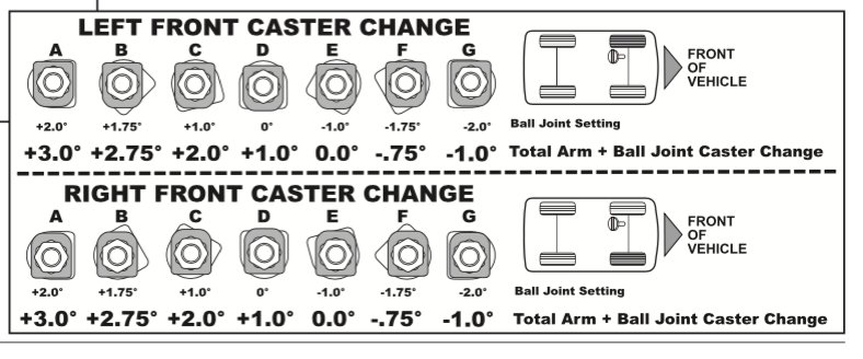

    I still say adjust the caster forward n your SPCs by one or two notches

    I didn't check to see where he had me clocked yet. I also didn't check to see if he torqued down the top nut to spec. I haven't driven the truck since I got it home, actually.

    SATX
    '02 AC TRD
    how did they change the rear toe?
  4. Sep 14, 2023 at 4:04 PM

    Even with the rear wheel sliders locked with the pins, ours will shift with a little pressure. So it’s possible the truck shifted during front end adjustment. I’m sure ours with the pins in will more an 1/8 of an inch in any direction.

    Right idea, wrong direction.
    I typically do 1 or 2 notches towards the rear of the vehicle if looking straight inwards.
    A lot of the time I'm cranking the lowers as far forward as possible for tire clearance at the back/footwell. As most guys have cut their bumper or have an aftermarket.
    They didn't.
    It's normal for it to shift a bit. Even a mild breeze blowing will cause the rack and/or tower to sway enough to change a couple hundredths of a degree. Its negligible and nothing to worry about.

    Explain plz. Because that's what I did and it worked.... Flawlessly
    Why would you go backwards toward the firewall when that's where you rub????

    Options B & C. They give more caster without clearance issues at the bottom.
    Because I push the lower arms forwards.
    We may mean the same thing but are wording it differently lol. I mean the joint pointing slightly backwards. Not the 'face' that says SPC.
    Since the center of the hub is near the lower ball joint and not the upper, you can tip the spindle back without causing rub issues. Movement forwards or backwards at the upper ball joint makes minimal difference as far as clearance goes.
    Edit: sometimes I flip the joint around so the flat face is outwards and the joint is inwards. This gives better coil clearance. Depending on the setup. This is of course not any of the settings on their sheet.
