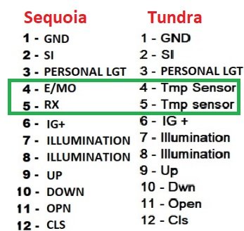

    Your challenge will be there are 4 screws instead of two like the regular console. However, the real challenge or road block actually, is that the Sequoia Info Center electronics is different. The connectors are the same but pins 4/5 inputs are different between the 2.
    Tundra uses 4/5 for Ambient Temp Sensor and Sequoia uses 4/5 to be able to display DTE, Average/Instantaneous fuel consumption, Cruise info....etc. That info comes from the Combination meter on Sequoia.

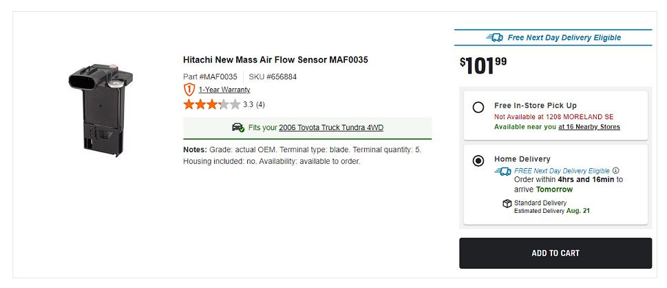

    That's the first thing I checked; the vacuum hoses. This would be a massive leak, as I had drastically decreased braking as well. Shouldn't be the intake manifold; gasket is new.
    Plus, when I pulled the connector off the MAF it went into limp mode. So with that change I'm 90% sure it's the MAF itself.

    Yeah, symptoms are pretty classic air metering/air intake fail. If you haven't replaced the MAF in the last 100k miles or more, I'd be pretty confident pulling that MF and replacing. Most LAPS carry the Hitachi MAFs.

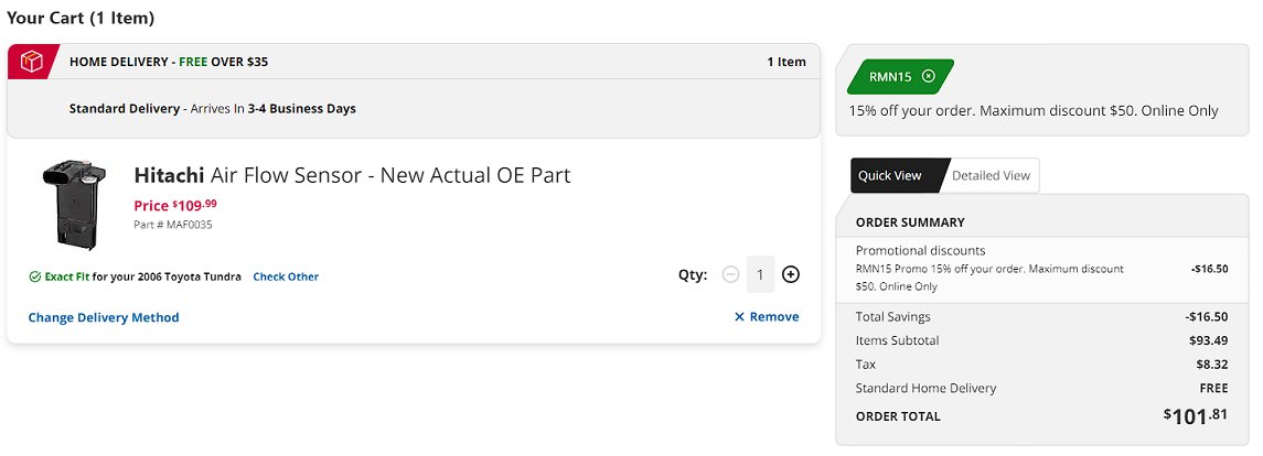

    Advance Auto Parts is offering up 15% off for online order/store pickup right now, code RMN15, MAF may or may not apply.
    AutoZone is doing 20% off for ship-to-home, but you gotta order an absurd amount ($125) to be eligible.
    Yep, coupon works...

    Have you considered for troubleshooting purposes putting your Tundra MAF in the Sequoia ?
    McGeorge says their the same.

    Why the hell did I not think of that? Thanks for the idea Bubba! I'll do it when it's not hotter than the underside devils ballsack outside. Currently 105°.

    RA shows it for $80. I asked vatozone and they had one for $67. Probably off brand.

    SummitRacing has it for $57.99 but only 4 left: https://www.summitracing.com/parts/hta-maf0035
    Vatozone for Hitachi $101. 20% off if you do home delivery would get it close to RA before shipping.
