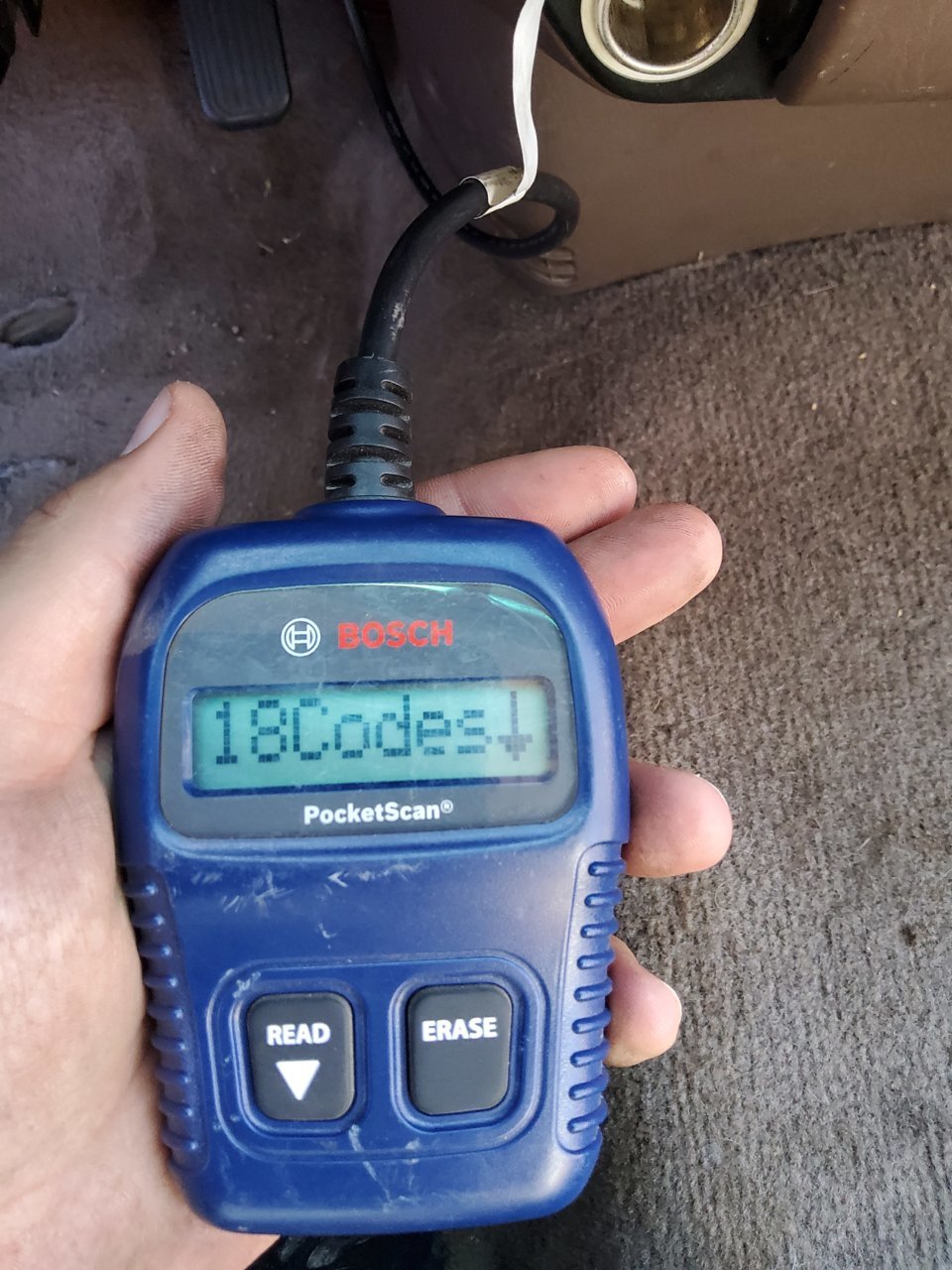

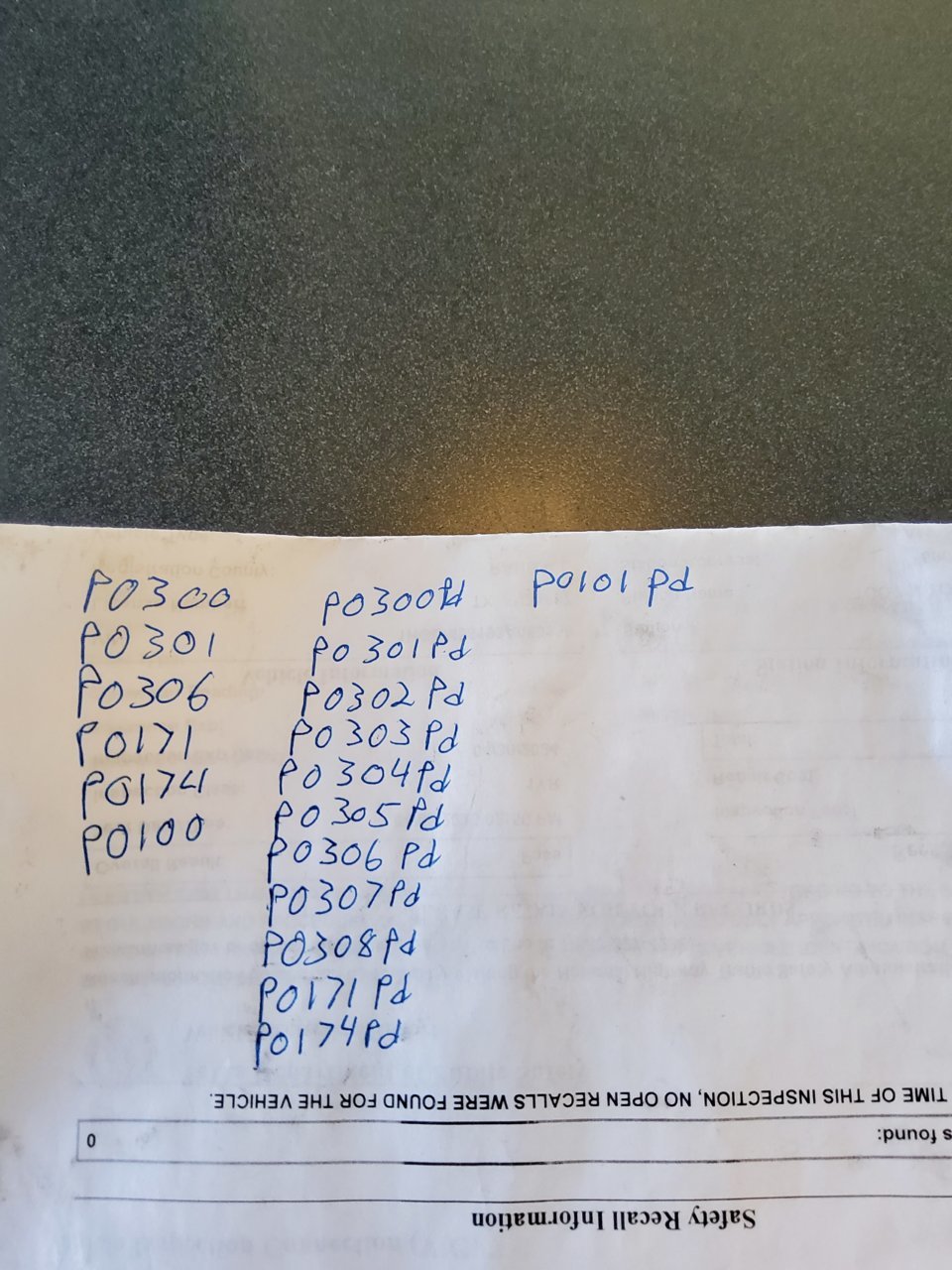

    So we're taking my daughter's tree in to get my old tires put on it. I fire Ironman up and he started smoking and jumping around idling. I took it anyways since I had the tires in the bed, and it started bucking at 3k rpm. Well that's not good. We drop the tree off and I pull the codes.
    I broke my old record!
    Here's what I got:
    I unplugged my maf and the idle went back to normal, well, shakey, but that's my normal. Still doesn't like 3k rpm. Went to vatozone and got some maf cleaner, no dice. I guess MAF sensors can just up and die randomly? Weird. New denso or Hitachi will be ordered if y'all concur.
  10. Aug 18, 2023 at 10:42 AM

    All of a sudden? How many of those are temp? Bad gas?

    Out of the blue. It's all misfire, lean, and MAF codes.
    Oh, and I haven't filled up in weeks.

    So MAF, O2 sensor and maybe vacuum / intake leak are good possibilities?

    Check the fuses under the hood mine idled like shit and wouldn't go above 3k when the oxygen sensor heater wire grounded out and popped the fuse. I think it was ECU2 on my 04.

    True, but it's only been parked a few days. We got the tree tagged and plated Wednesday.
    I think vacuum and intake are ruled out. Its lean on both banks.

    I'm going with air metering/air intake issue. But spray to check for intake manifold leaks! Maybe you blew gasket again.
    I'd pull neg battery cable, get some CRC MAF cleaner, clean MAF, let it come to room temp, reinstall, fire up, idle for 5 minutes and make sure your crackhead neighbor doesn't steal the truck, then go for a ride.

    Wouldn't lean mean more air than fuel? Vacuum leak at the intake would draw in more air than the MAF is seeing, so less metered fuel. Not saying it’s that, but something as simple as a large intake vacuum line being broken or chewed through could creat a lean condition. I would suspect MAF or O2 sensors first, but it’s free to check all the intake and vacuum line connections.

    Yup, this was my thought as well. Either MAF is reading 'off' and reporting less air than actual, thus injectors aren't firing as much fuel in, thus lean all banks.
    Else, air is entering the system improperly after the MAF, either from something off at TB, catastrophic failure of the intake ...
    But to add to that...
    Or it may just be none of the above, and fuel pump died, thus it's not pushing adequate fuel into the injectors. Or fuel pump relay isn't kicking the pump from low- to high-output. Bypassing the fuel relay could potentially resolve that.
    I'd be checking pressure to fuel rail also.
    While I could see how O2 could play into this, I'd be shocked to be seeing it on both banks simultaneously. Bilateral failure of O2s would be pretty impressive.
