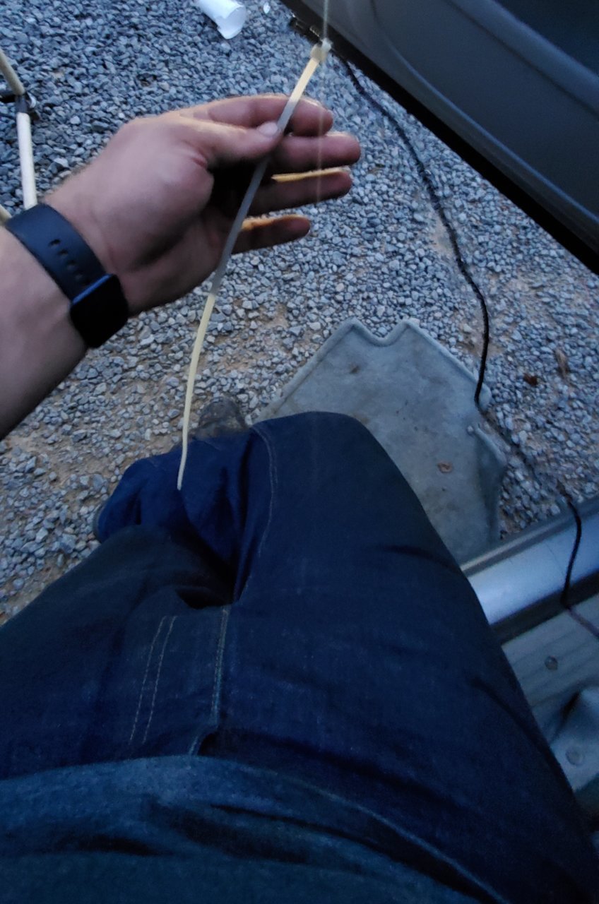

    Heres how I'm running it through the dash. Real long zip tie wrapped around the end.
    Someone used all my electrical tape after I got done with it for rear wiring harness. Will use masking tape.

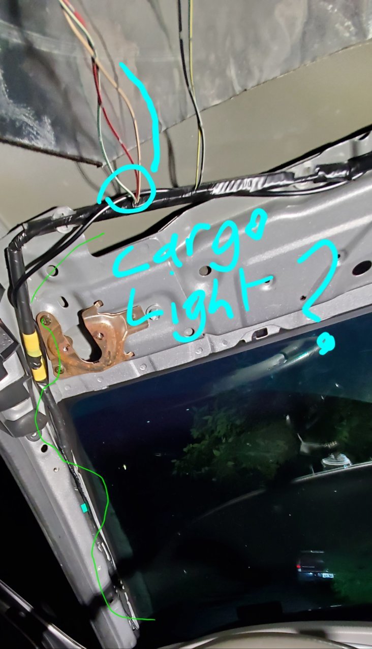

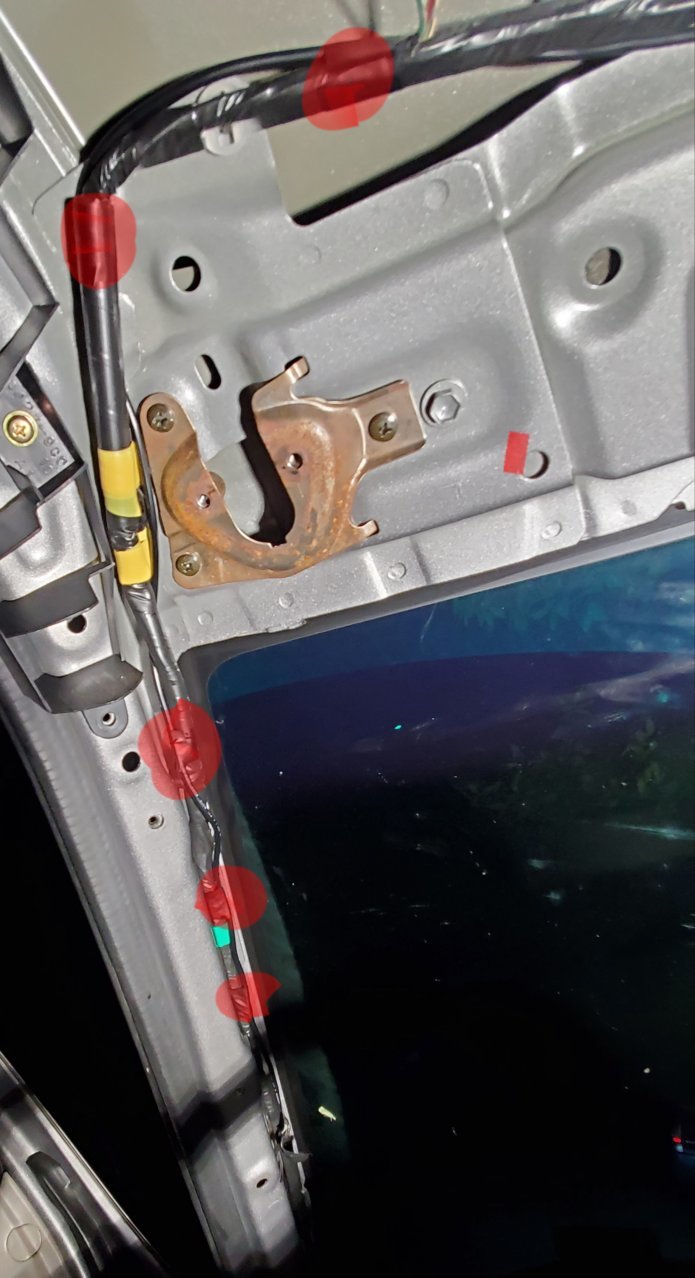

    My masking tape sucks, and this is happening tonight. Tired of my terrible cord management in the pass foot well.
    Elected to wrap the new cord around existing wiring harness in a manner similar to the thin green line.
    Blue circle is origin of high mount stoplight. I'm assuming the wire i have "traced" in blue is cargo light.

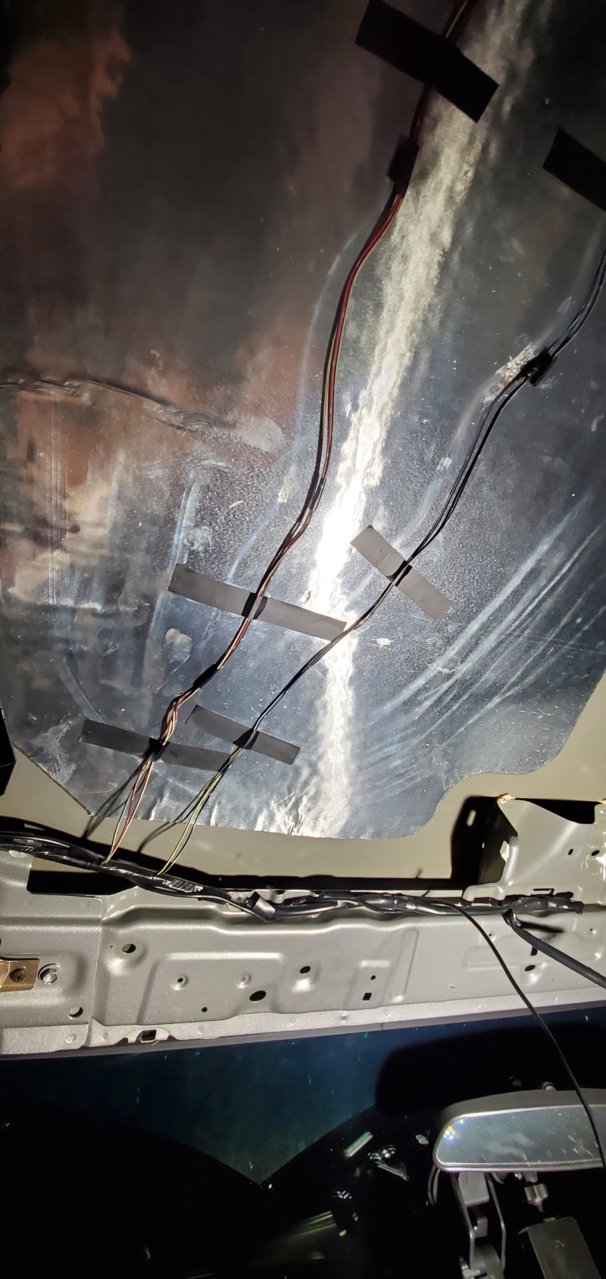

    Found some electrical tape. Wrapped around OEM harness in designated spots.

    Taped center cab light, and high mount stop light harness to the heat shieled thing.
    @Professional Hand Model, for your records, and to urge you to do this job.
    The silver pieces had fallen down off the roof of the cab slightly. Pushed back into place, and original adhesive seems to hold it just fine.

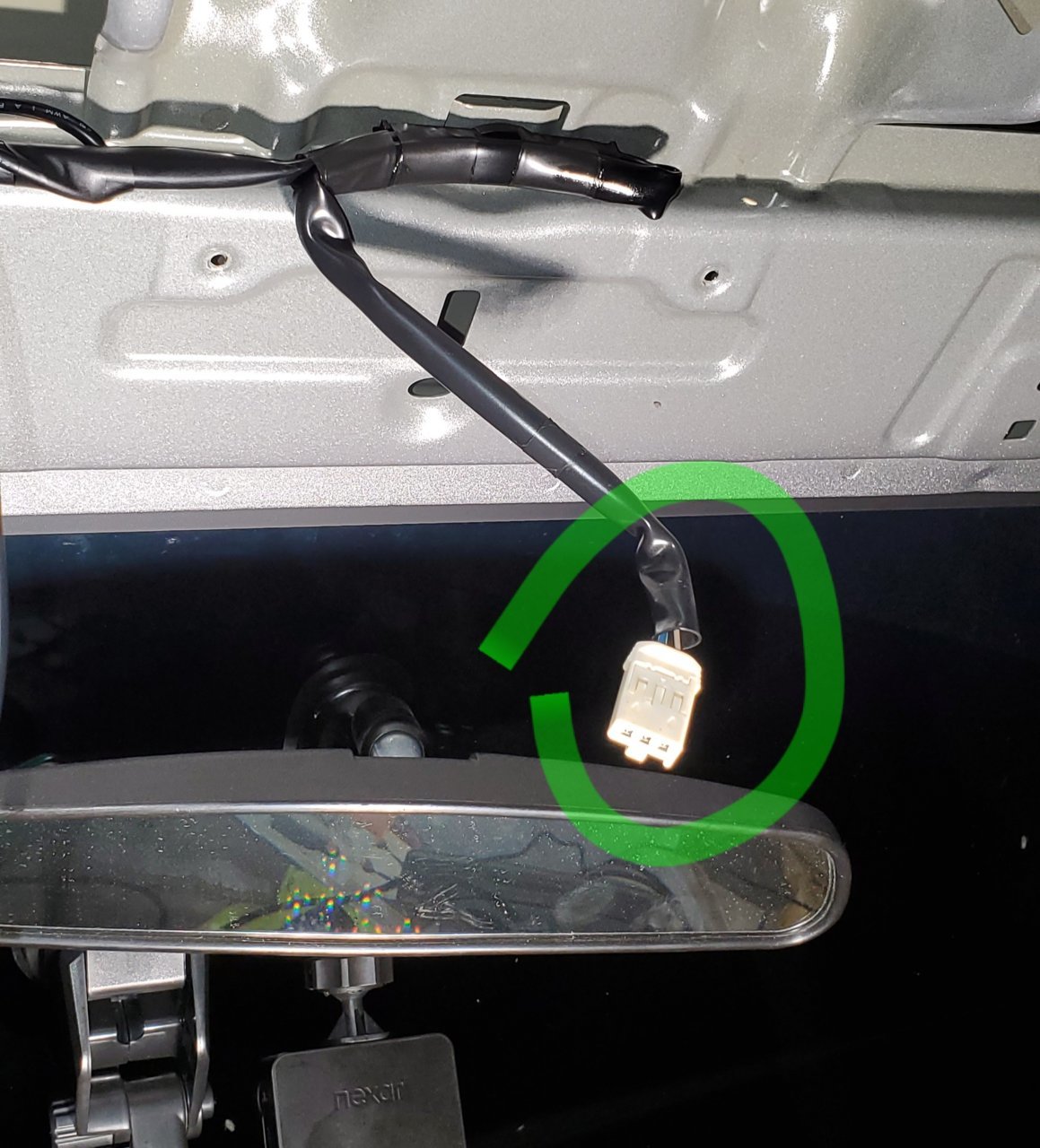

    Why 3 pin harness for front cab lights? Could I get the powered rear view? Not sure of the harness for that one.
    Any thoughts?
    Mid-cab light only has two like I expected.

    constant power, ground, and the signal from the door switch.. hence 3 wires.

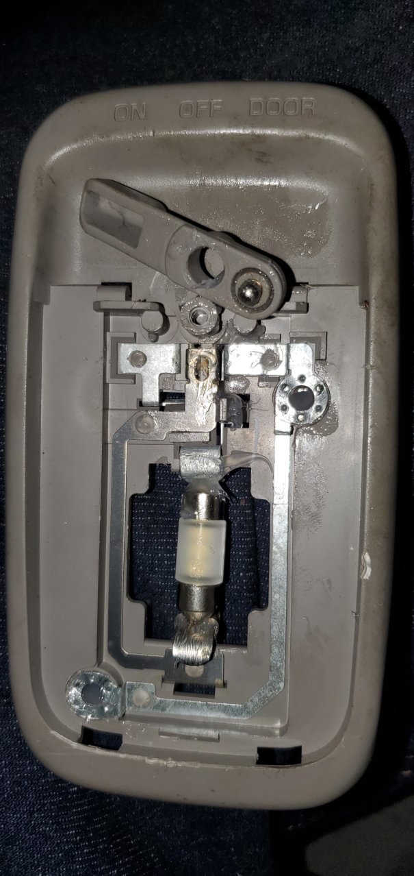

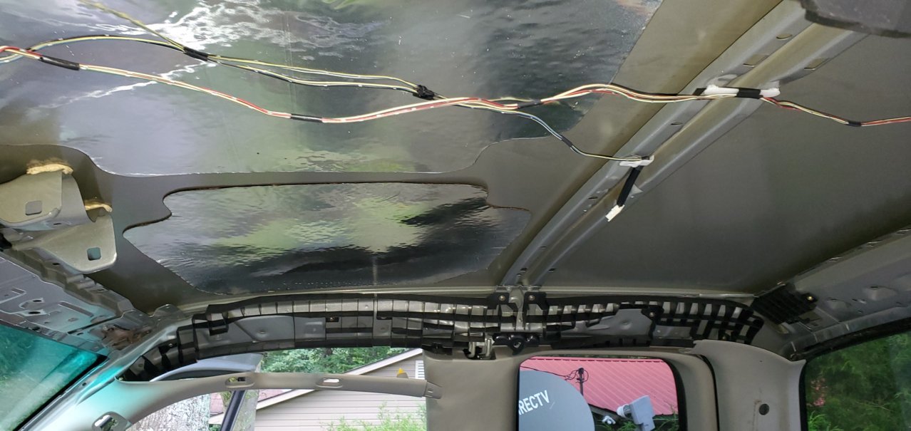

    Okay, here's where I'm at.
    I'm not @empty_lord, but I think I can manage.
    Might be one worth investigating for AC peeps.
    This is the dome light in the center of the roofs. Remove the dome light with 2 Phillips screws, remove the switch arm, and lubricate ball. This is a trial picture, and was cleaned up before going back in. Do not be fooled by lack of "ON" operation when the dome light is out. The two mounting screws are the ground.
    I'll admit, it had me fooled for a minute.
    NUDRAT[OP] and bmf4069 like this.

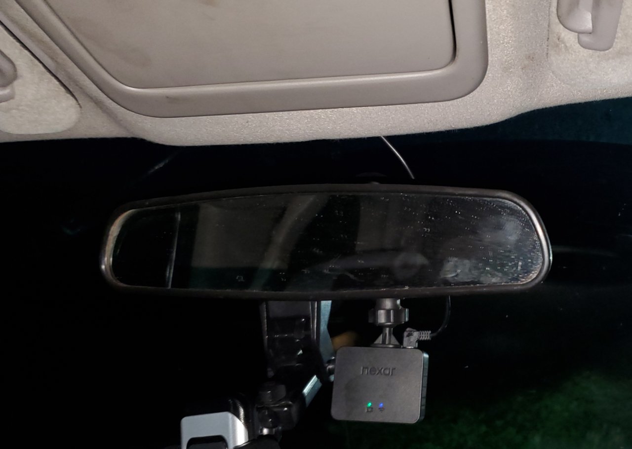

    Western Kentucky
    I like Nexar brand dash cams. Mine is the beam.
    Records travel log, speed, audio in cab if you want, and is on all the time when key is on.
    Connects to your phone through an app. No need to mess with SD cards if you don't want.
    Only downside for me is that the clips you can make are at maximum 4 minutes long.
    I would have T-tapped in, but I wasn't sure of power requirements so I went with this route. I tried googling PR, and on Nexars website. No luck. Went with this the fuse block kit.
    I didn't want to burn up my fancy camera
