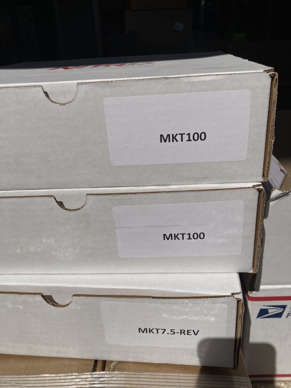

    daveeasa
    Dec 2, 2020
    #55605
    4,192
    David

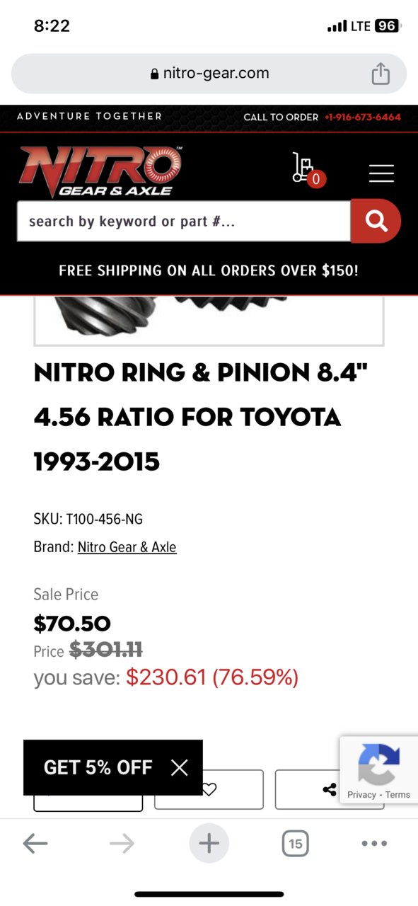

    Just took this pic, still on sale…

    Can you please try posting a link, or send it to me via pm.

    Never mind! I got through to it.

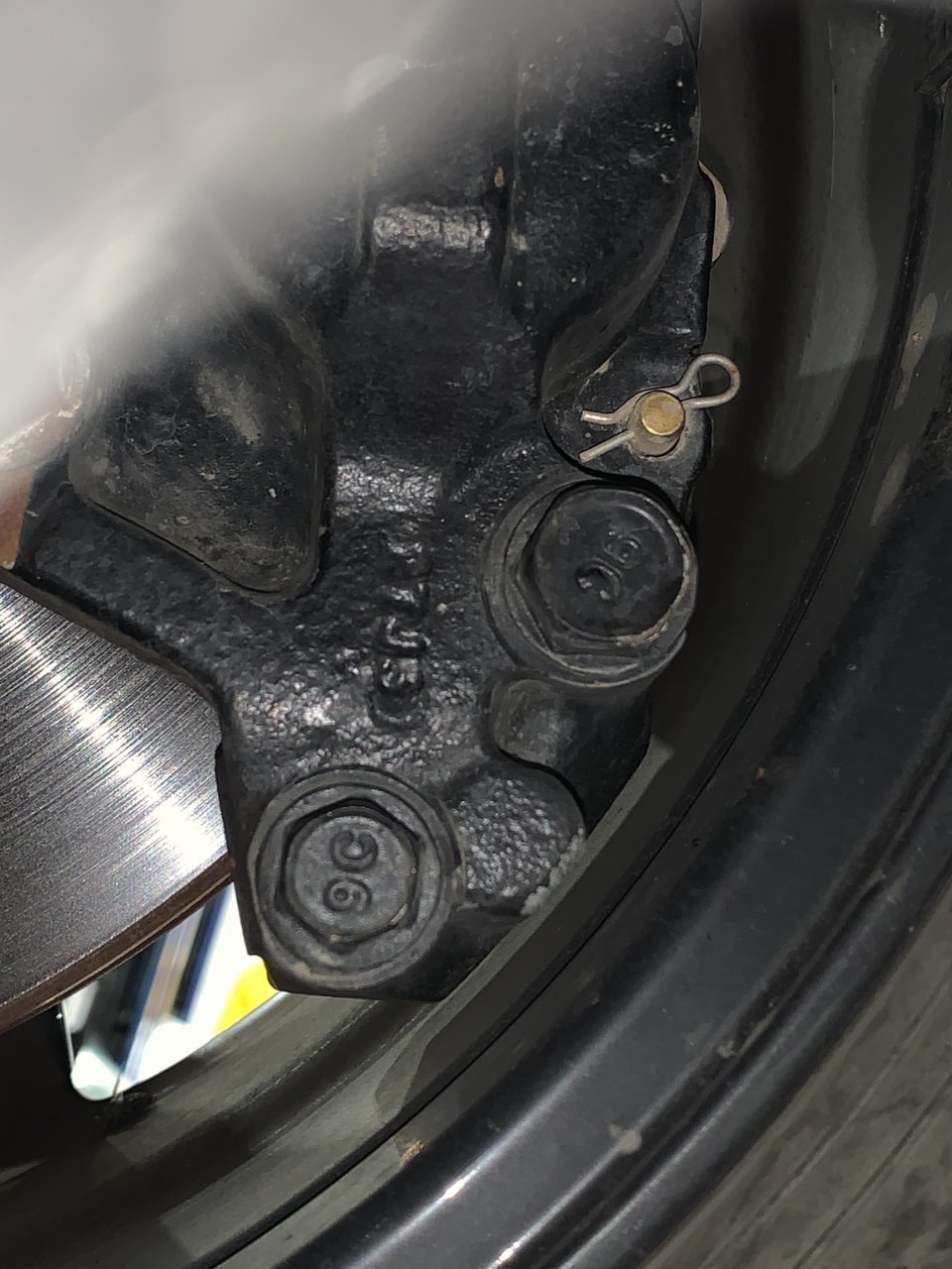

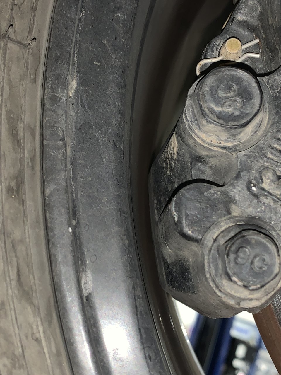

    Got the tunda up on the lift, check out the brake caliper clearance on these 16s. Wheewww :cookiemonster:

    Ok, so, will one of you that knows please verify, can I run 8.4" ratio on my 2002 AC 4x4? I noticed Dave's boxes and the link he posted are for 7.5".
    I gather that 8.4 will be stronger for off-road stress, and there's a "conversion flange", but I don't know how I'd know this stuff, bolt pattern and anything else. Add solid pinions spacer(s)-- is that 1each, front and back? And I've seen what looks like forward and reverse. Is that one of each, front; one of each back (like that's how they work, fit together-?).
