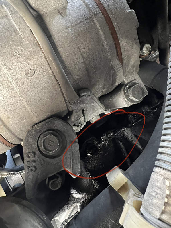

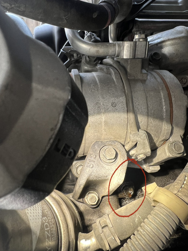

    I have an oil leak above the a/c compressor. Not enough to drop oil on the floor. It just leaks above the oil pan and paint the back of the steering rack. Anyone have a clue what I’m looking at. 185k miles
    Update: after doing some googles it looks like an oil filter adapter seal leak. Looks like a simple figure 8 o-ring
    This will be my second $1.50 o-ring fix on this truck.
    Part number below
    Engine Oil Filter Adapter Seal - Toyota (15692-50020)
    looking at this thread.
    https://www.tundras.com/threads/2006-oil-filter-adapter-seal-leak.121277/
