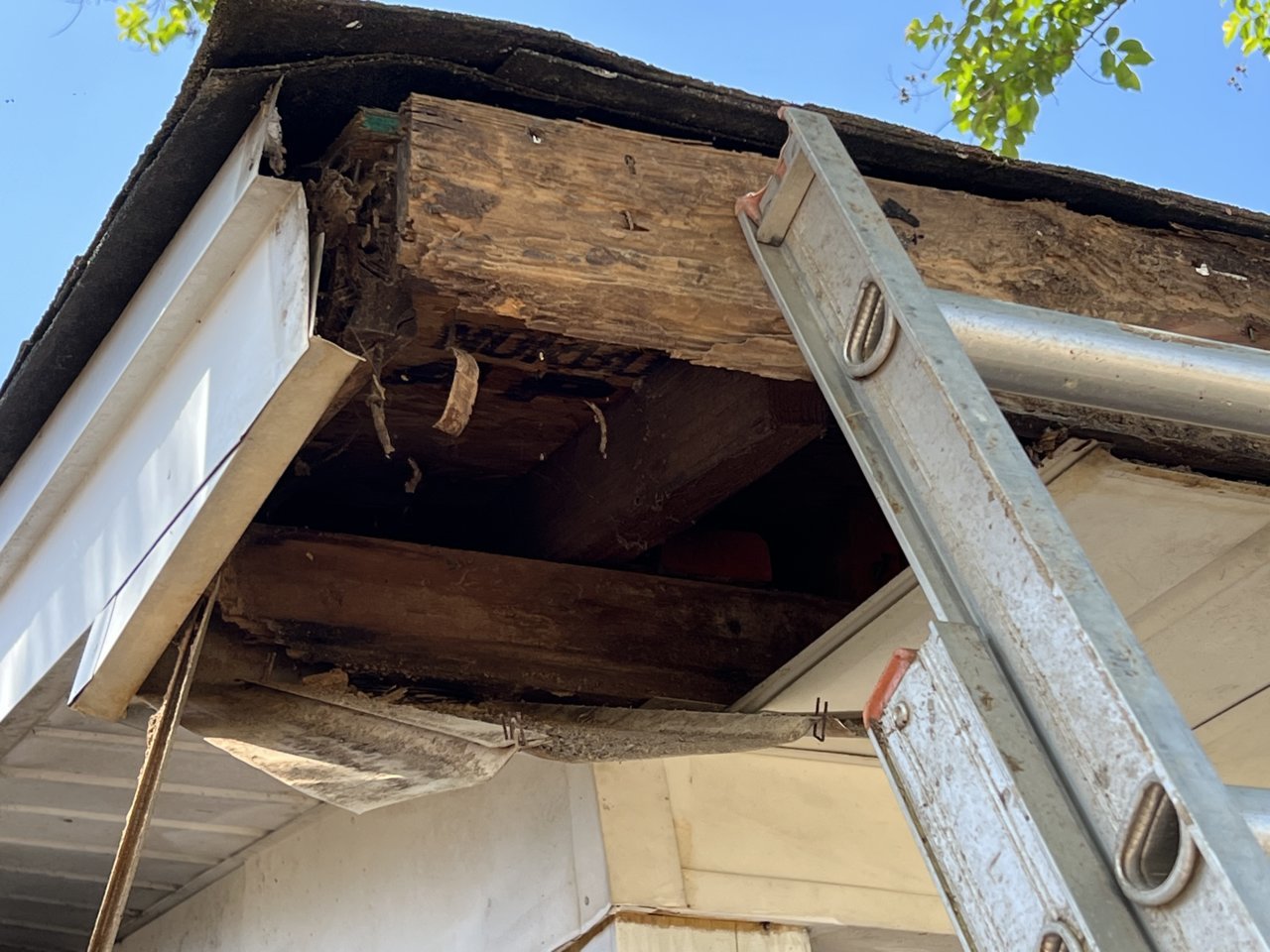

    Had a similar repair recently. Some siding came off in a storm. It fell off because it was attached to air apparently. The more I peeled back, the more I found. Gratuitous first Gen shot in there.

    That roof is flat. We get like 60 inches of rain and not infrequently 6-12 in a day. My roof has 45 deg pitch

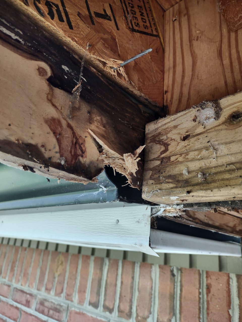

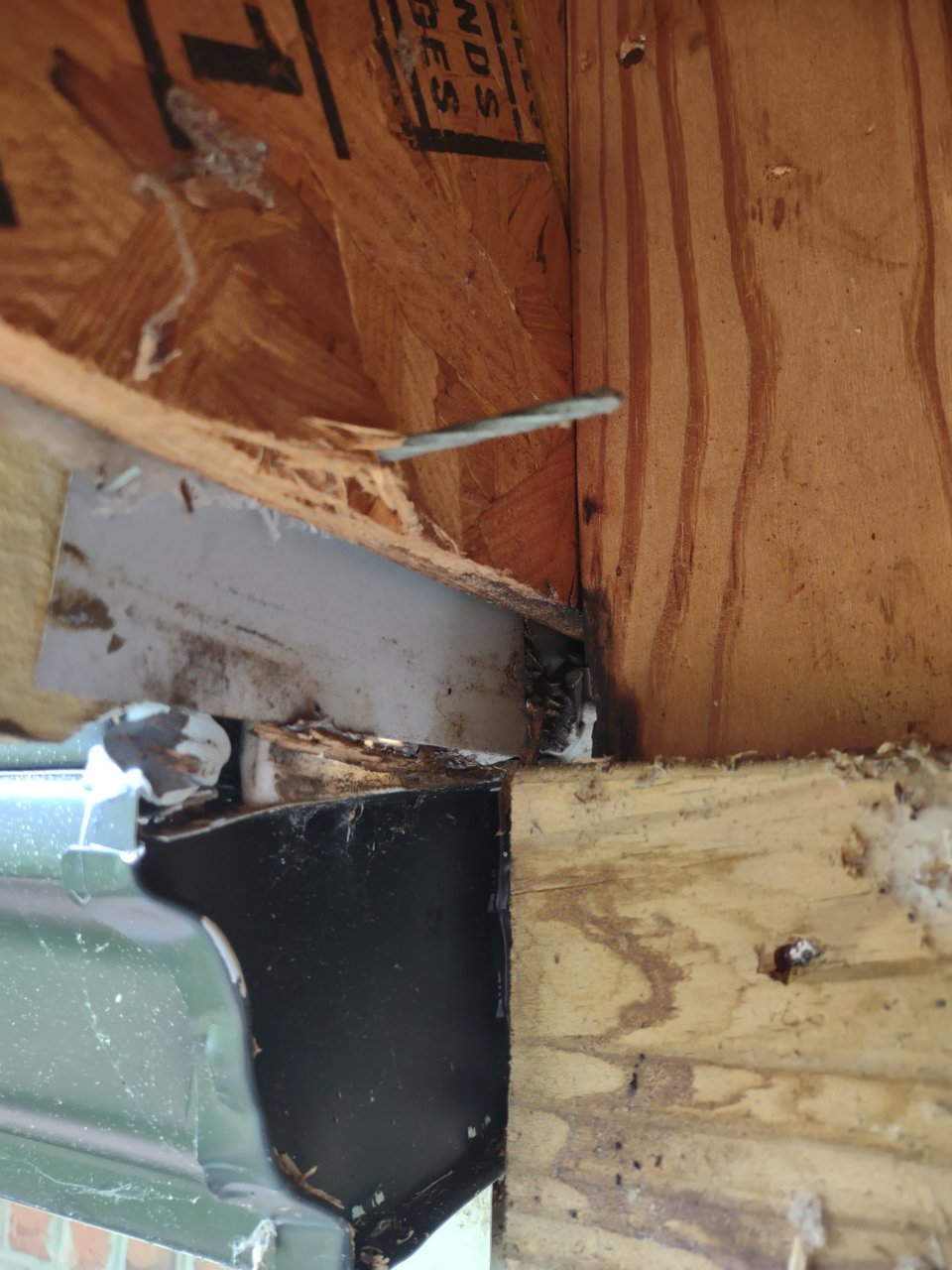

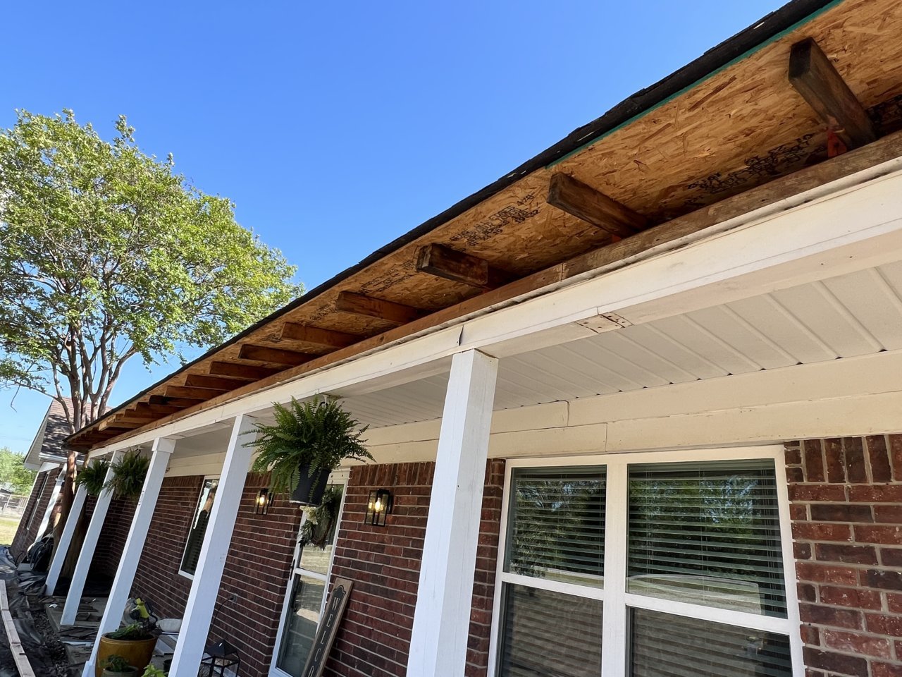

    It's water damage. There is no step flashing at the gutter where it meets the sidewall and no kickout on the gutter to keep water from spilling over. I'm about to take care of all that. Thankfully nothing structural appears to be FUBAR.

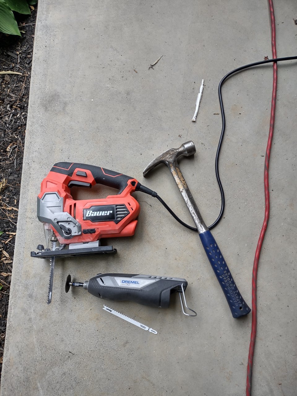

    I need a Sawzall.

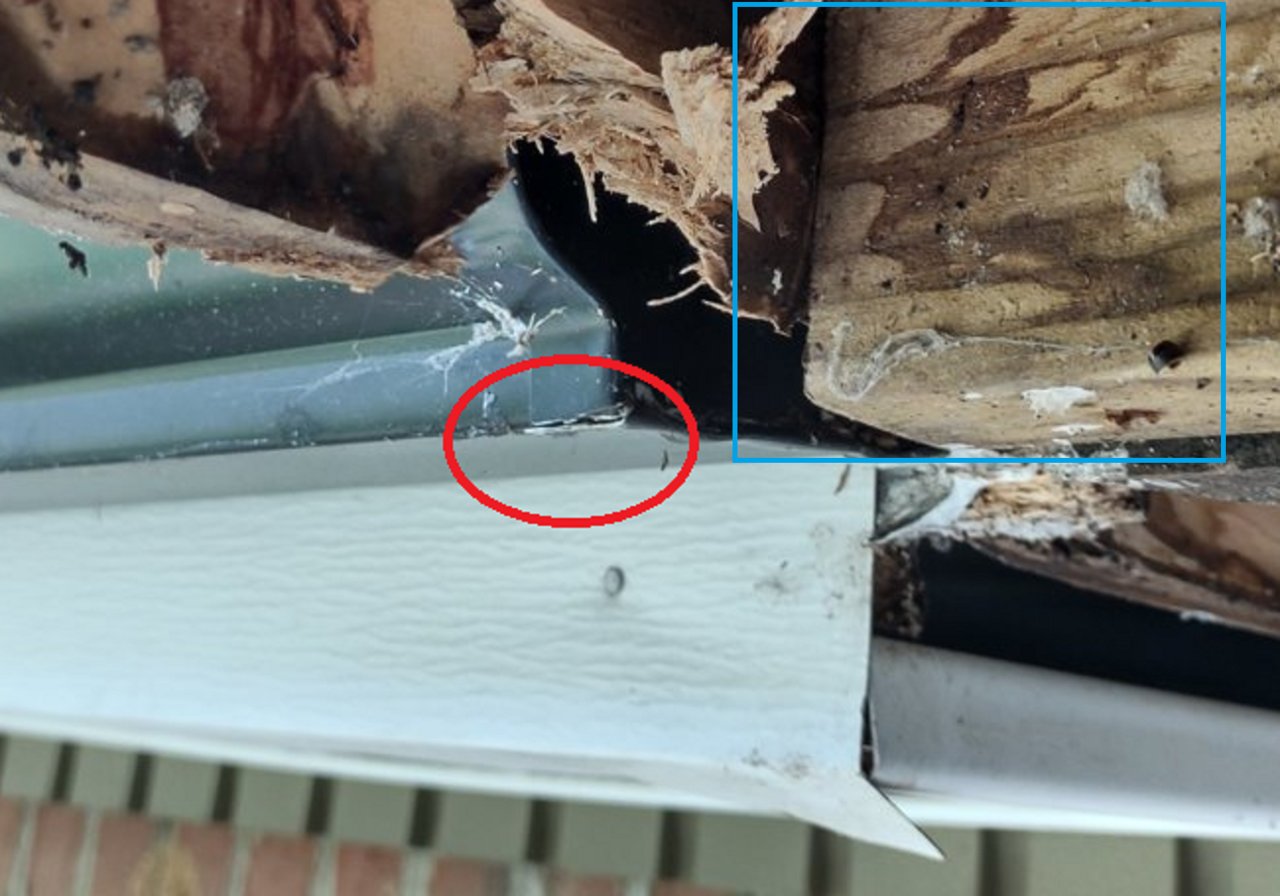

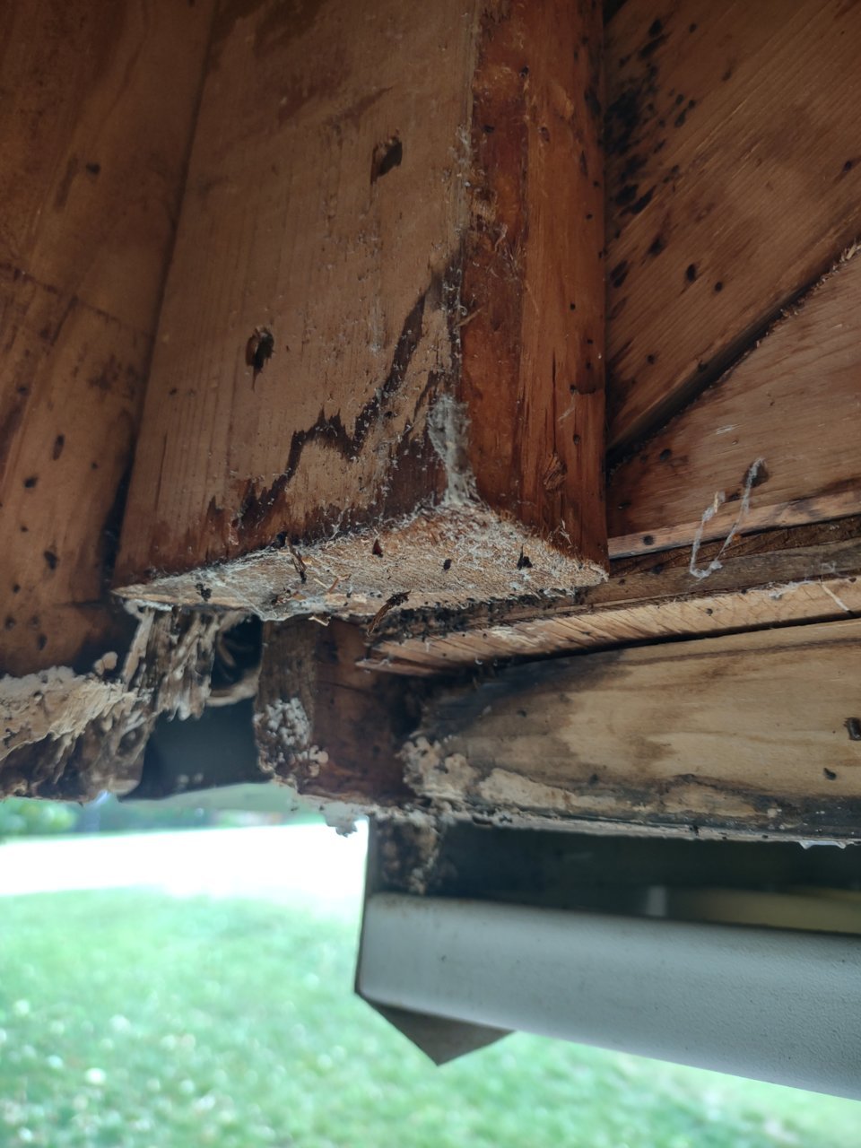

    Correct, water penetration. We see similar here in ATL, home of random celebratory gunfire all day er'y day, and carpenter bees. Those two and improperly mounted gutters seem to be keeping the roofing industry alive and well down here. Everyone in my row of neighbors has had issues with rot at the roof edge from improperly installed gutters. Probably the same company and shitty installers. Sounds like you already know what caused yours.
    You need a Dremel MightyMax or similar recip saw?

    Oh, but back to the point, other than that one piece of wood.
    I notice what I think is a split in the gutter that may be pissing water also, circled in red. And I was originally wondering if the installer of said gutters' may've driven a fastener into the end of the gutter boxed in blue, straight into the 2x4, which would let water penetrate into the wood, decaying it. But it may just be perspective, I can't see it from outside the overhang. If it's straight-up soil beneath this overhang, I guess you'd see erosion indicating you had spillage happening, though.

    That's just the fold for the endcap. Usually they put some goop on the end of the gutter and slide that end cap on over the goop. The gutter is solid all the way to the end.

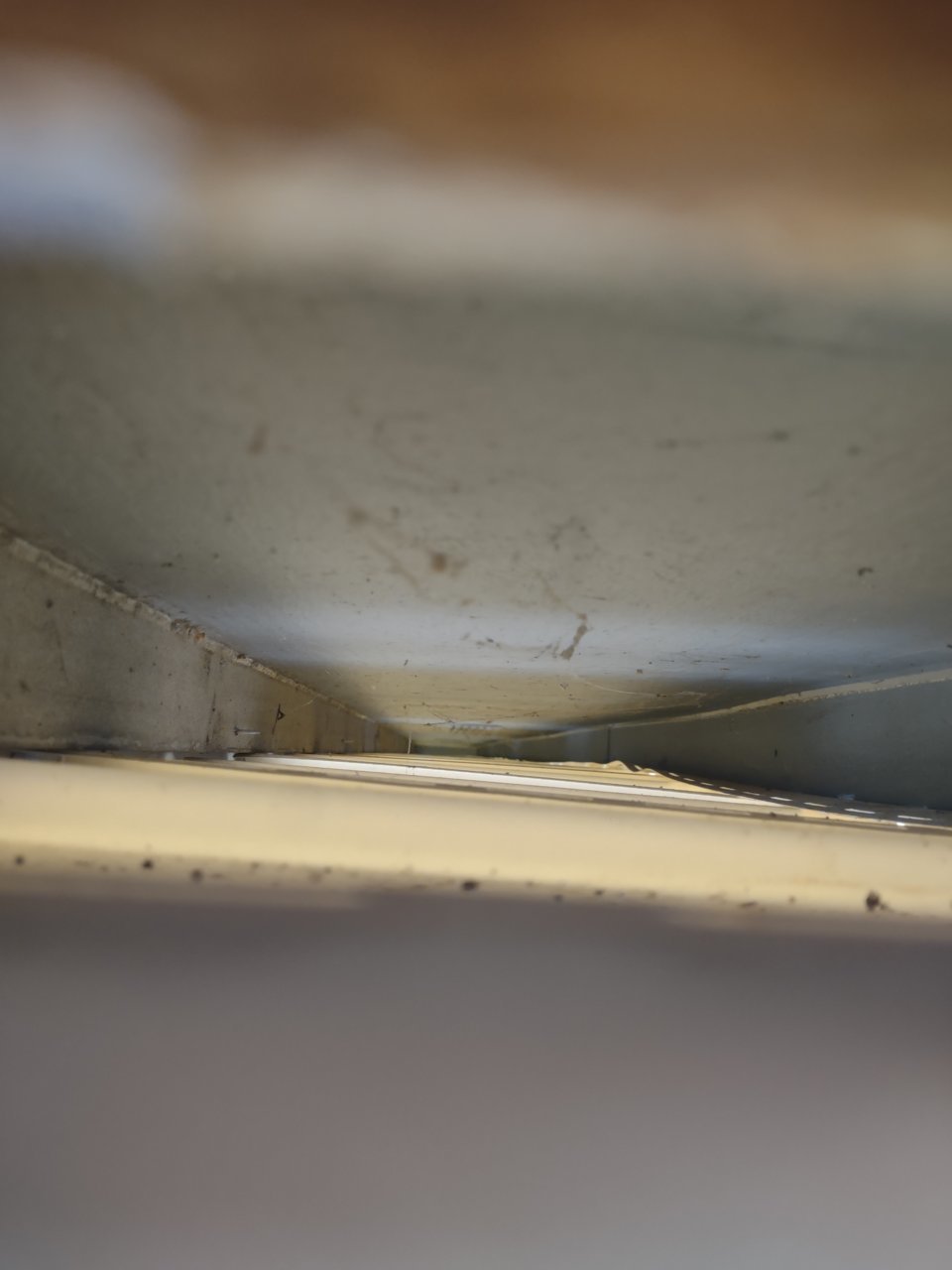

    Is that an aluminum eave soffit?.

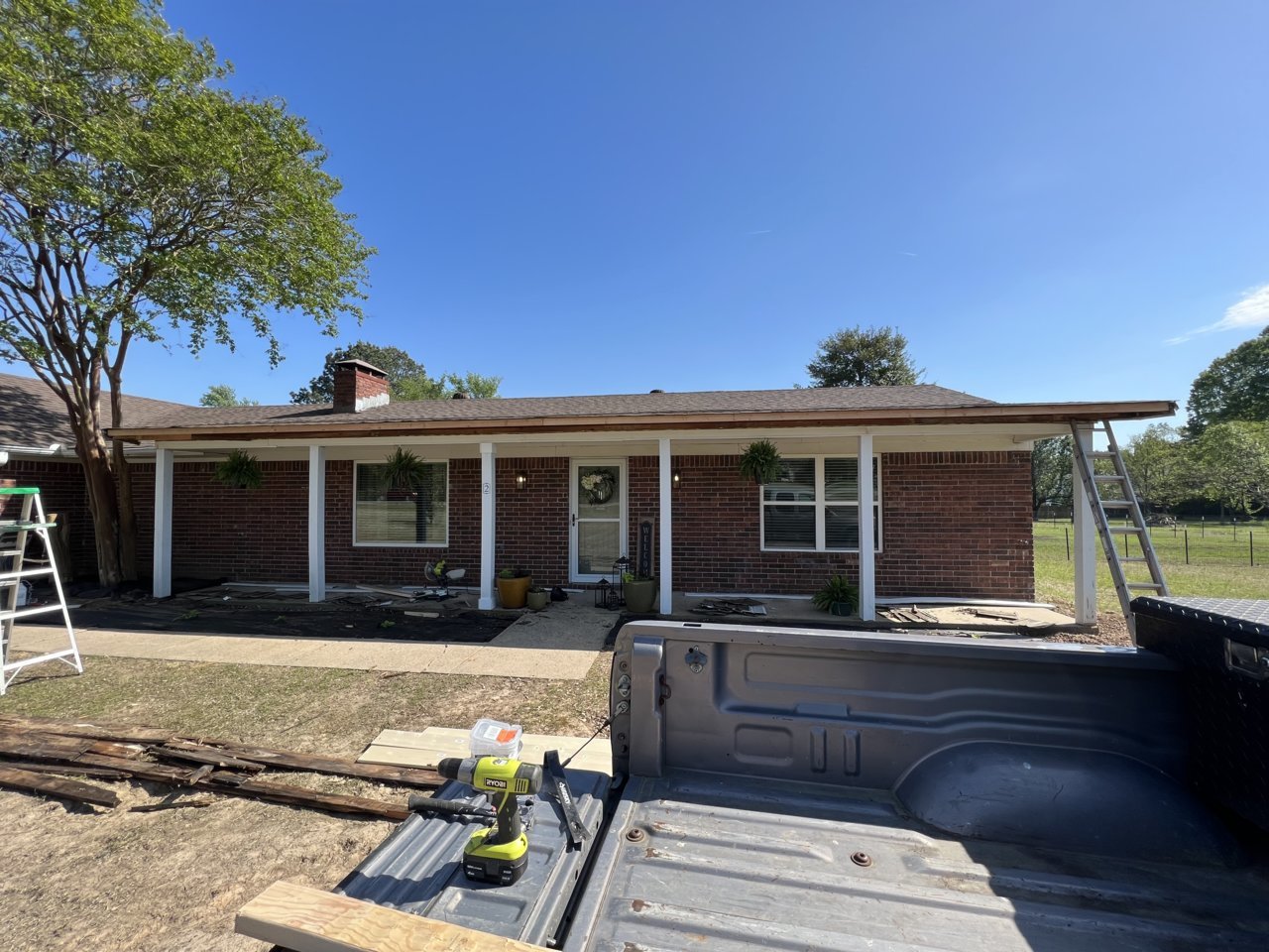

    I thought so at first but feels like wood behind the cover. The very end is rotted out a little.
    Why do you ask?
    Making some progress here with the tools I do have. BFH helped.
