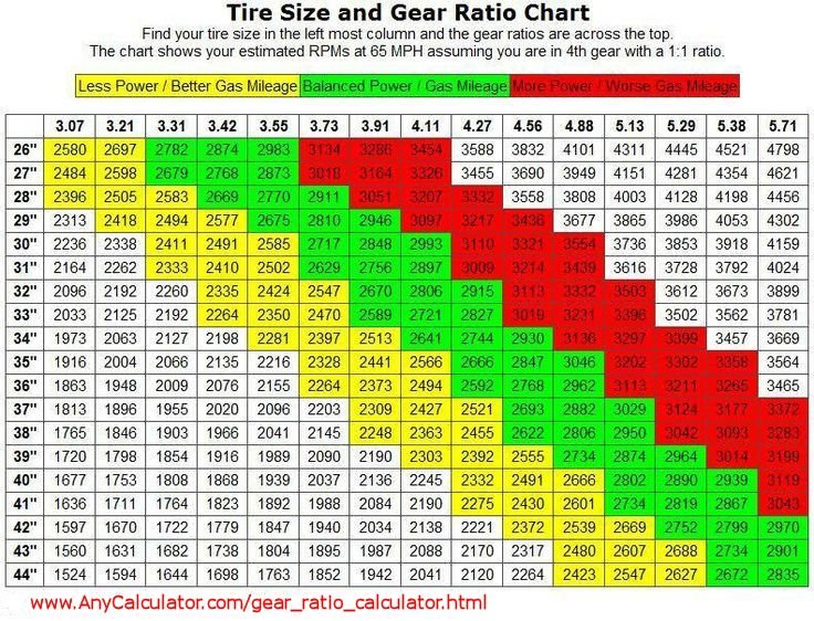

    4.56 if not towing, 4.88 if towing.
    Eh. Tires are heavier and more wind resistance when lifted, so doing 4.56 instead of 4.3's for 33's is better. IMO.
    4.3 is goldilocks only by pure numbers which don't take into account the above.
    Also better gearing wise for those with the 4sp trans as 2nd is taller.
    4.88 for 34-35.
    3.91x for most v8 4wd auto. 4.10 on the 04 DC (and all sequoias). 4.30 on early manual v-6 iirc
    Yes. Way better accel and torque. It'll be like the truck woke up.
    That chart is misleading unless you read the fine print lol. The green is with a 1:1 ratio but we have O/D so the gears we should choose would be near the edge of the red and green.
    All the RPM numbers wouldn't apply to O/D.

    I don’t quite have 33’s but 4.56 feels like everything and then some for my rig. Can’t see wanting 4.88 without two OD’s.

    The way I see it, it just depends on your preference, fuel economy vs low end power. That's why I chose 4.56 over 4.88. I actually wanted 4.30, but couldn't find any because of supply chain issues. But I'm very happy with my 4.56's on my 295/75r16's.
    I don't do any towing with my 4x4 now that I have another first gen with stock tires and a four speed. However I been considering 4.10's for it. Just for funsies.

    I’m thinking with 97.6% of my driving on city streets and below 45 for most of that. I’ll be doing 4.88s and enjoy the snot out of it!

    Yes. You're a candidate for 4.88 especially if 34-35's are in your future.
    unless you wanna grab that deal mentioned earlier,

    Because 32's. You'd be the candidate for 4.3's.
    4.10's probably would have been fine too.
    Kinda counter intuitive but higher rpm doesn't necessarily mean worse gas mileage. It's about finding the efficient range of the motor. Our 4.7's point is a bit higher than an American v8.
    I went from stock 3.91 on my stock tire 2wd to 4.10's and got 2 freeway mpg and 3-4 city mpg.
    3.91 18/13 mpg before
    4.10 20/15-16 mpg after

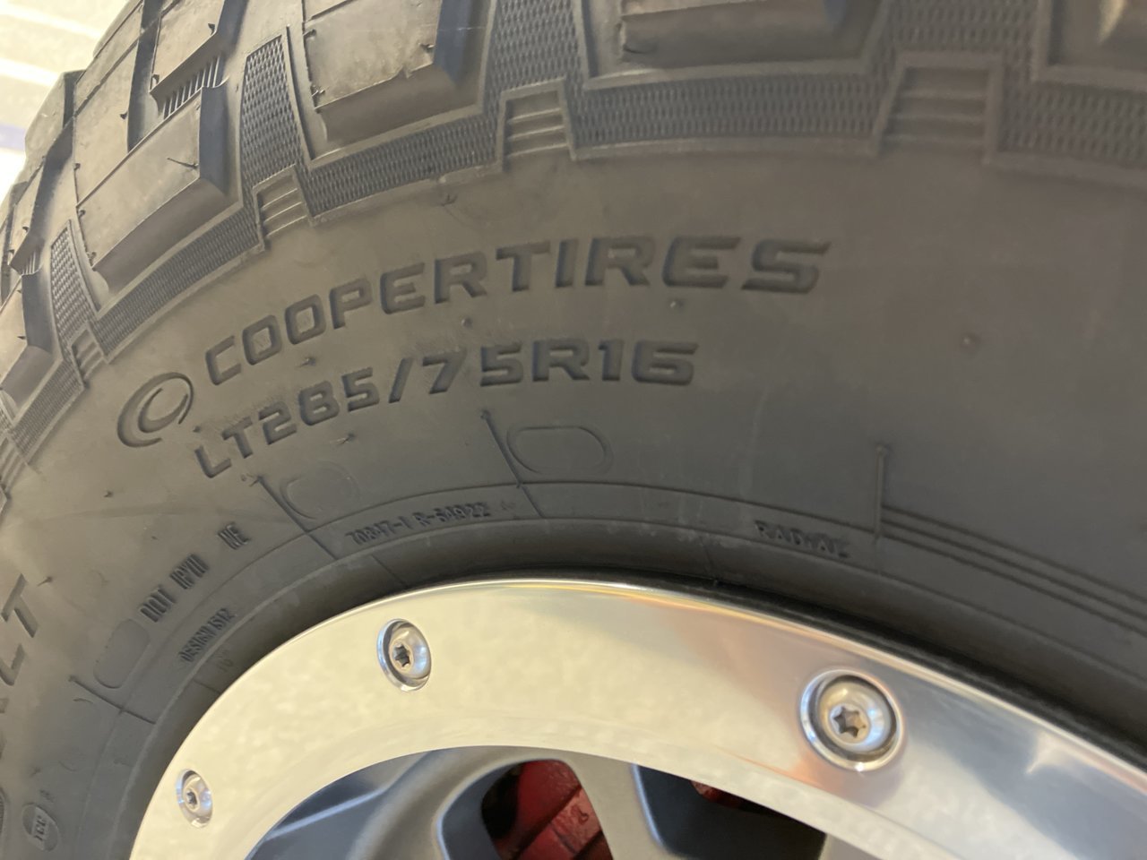

    Tire math is strange. This prolly explains the situation. Next set I’ll go bigger I think.
    I’ll have to futz w the yellow box now.

    265/75r16?

    Doh!
    Well at least you have an idea what 4.88 on 33's is like now.

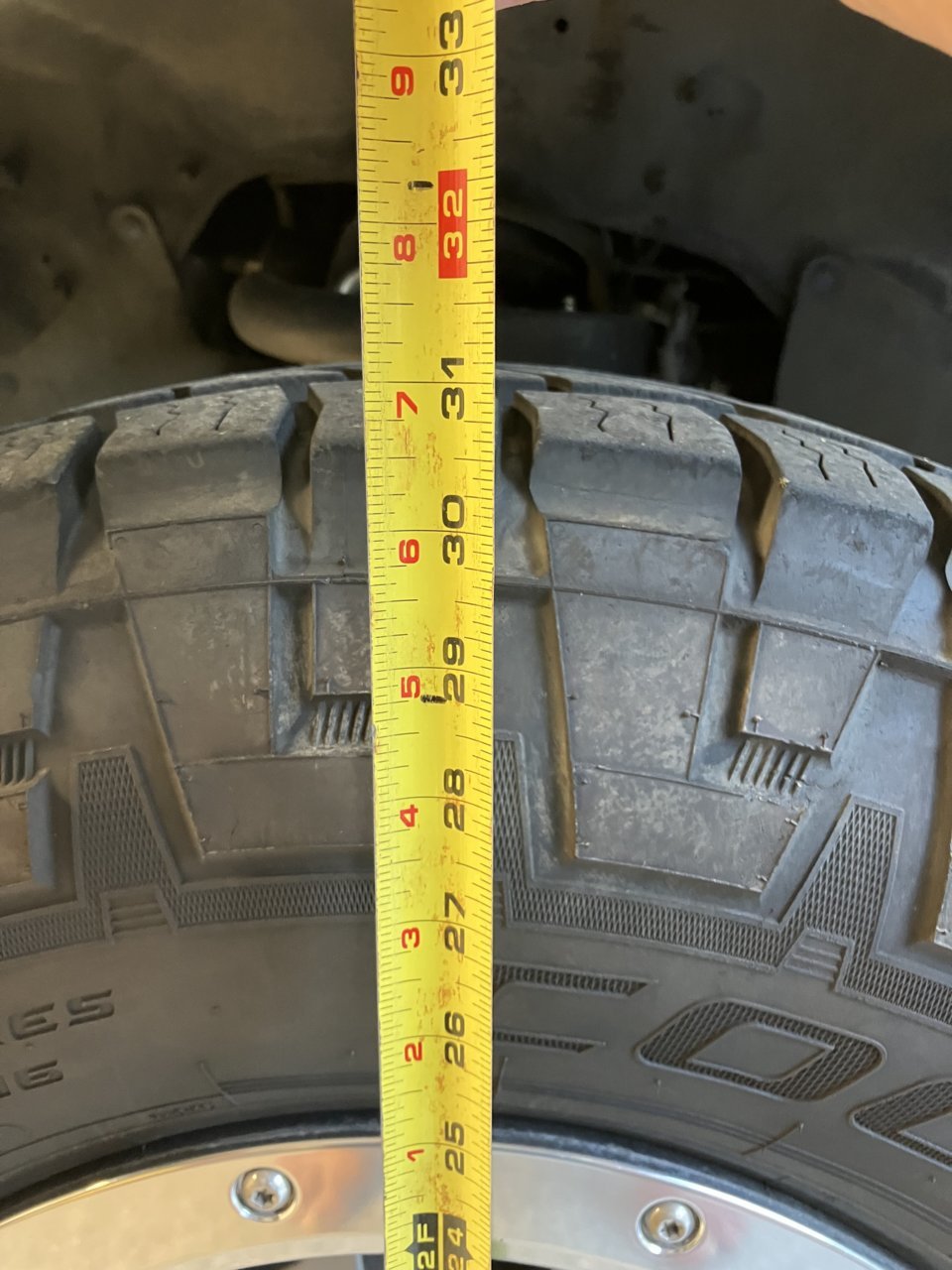

    I think I paid 600 for the 4 of these. They aren’t small.

    Pretty sure mine measured 32 after they were on the ground. 33 with no weight on them.

    I would think mine would squat more with more sidewall. Maybe it's just psi? I'm at 35. Or just different compounds. Who knows?

    I was under the impression that my 265/75s were almost that tall. Think I'm gonna have to measure tire sizes just for fun. I'm sure my 33 inch side by side tires are about the same. Especially since they stay at about 10 psi.
