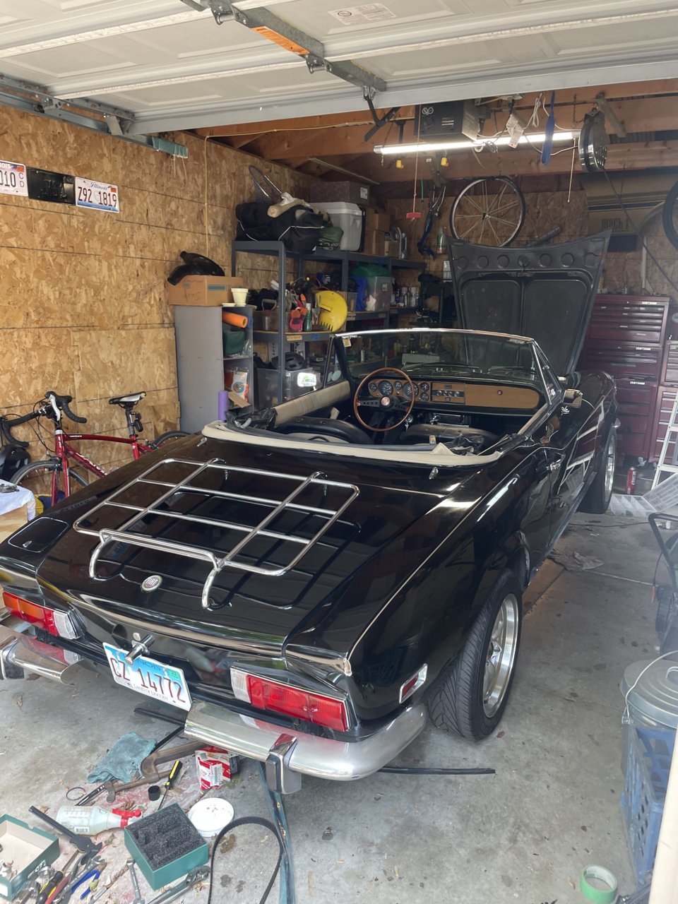

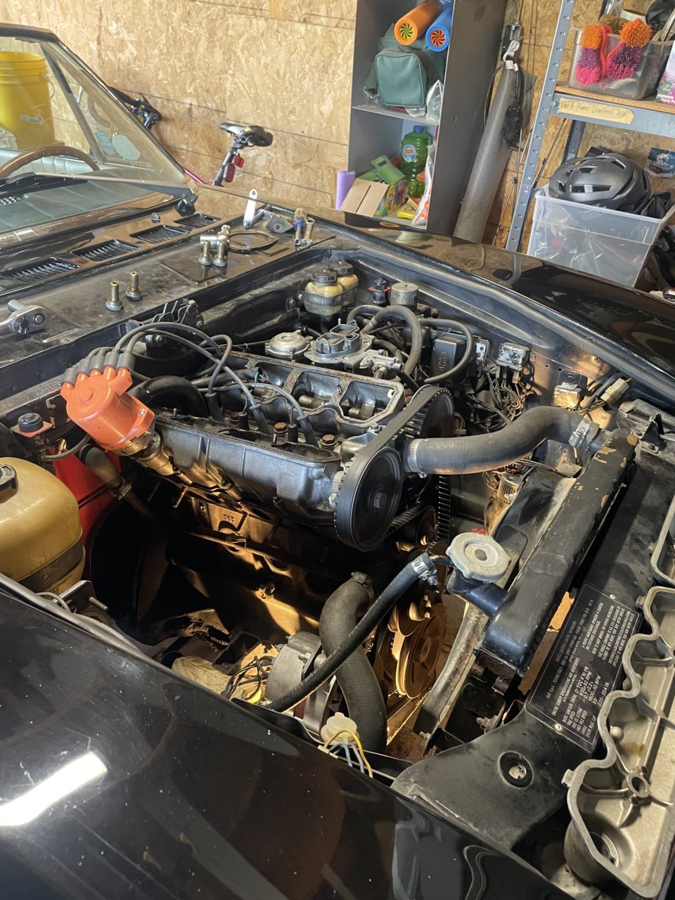

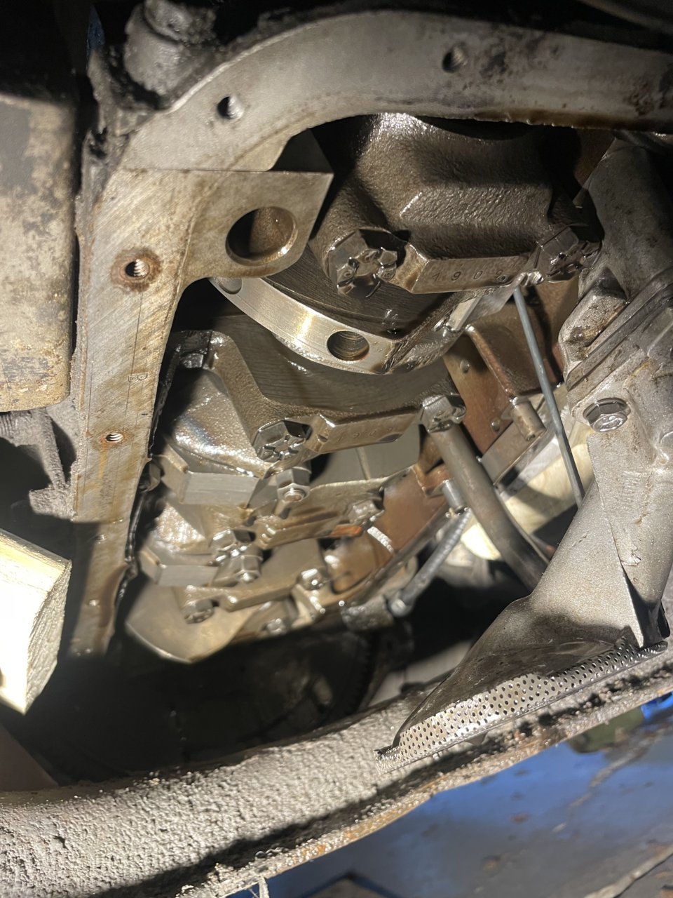

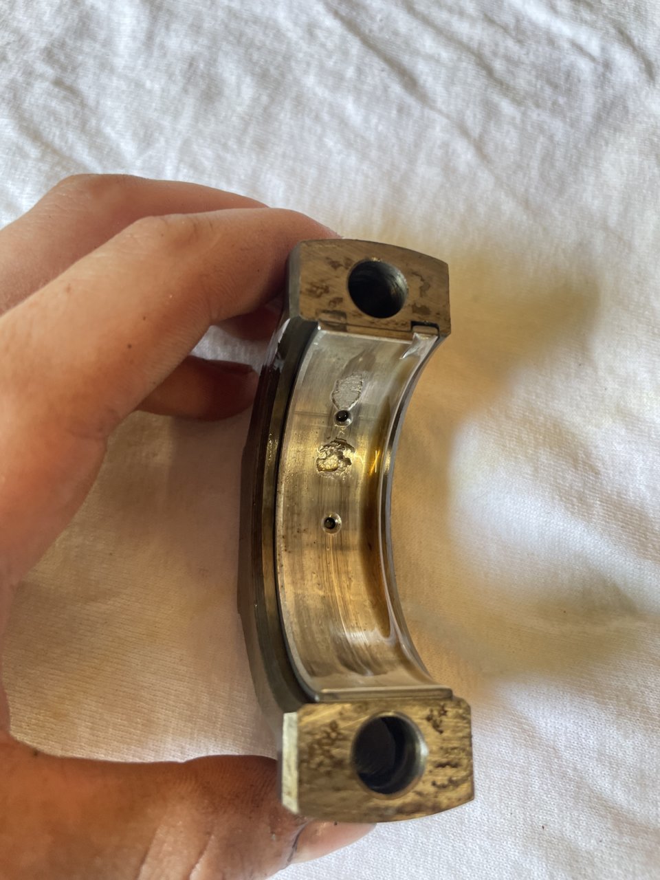

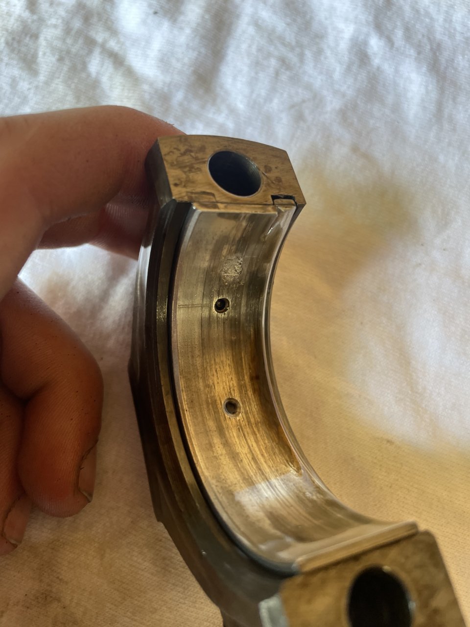

    So I’ve done a lot of pretty serious automotive work… but this is a bit out of my comfort zone.
    My ‘74 Fiat has slowly developed a rod knock in the time I’ve owned it. It has now gotten to the point where I can’t ignore it any longer.
    The engines in these Fiats were designed with the rod bearings as a “sacrificial” part, and these engines will destroy rod bearings long before they damage the crank, rod, etc. So, that means I get to spend hours at a time under the car with oil dripping in my face. Lovely. At least I don’t have to pull the whole thing!
    The engine needs to be lifted a couple inches from its mounts, but things can stay mostly intact. I didn’t even have to drain the coolant!
    Here’s the “best” and the worst bearings out of the 4. Toast! Crank looks brand new.
    I’ll post an update when I get it back together.

    are they cracked mains or machined? ever used plastigage before?
    Hows the nose of the trans? What caused the crank to flex enough to wear the bearings? My 22-re rebuild lasted a bit over a year of hard use. Slow car fast. But i think i remember an o-ring that seemed too small, or whatevs. Just pay attention to pressures, i guess.

    The rods are machined, and I’ll be plastigauging them when it gets reassembled.
    I think what wore them out is just a lot of abuse. The car can corner so hard that I’d imagine the oil pump really works hard to keep pressure at all the bearings. I really beat the crap out of the thing too- highway speeds are 4000rpm+, and I’ve taken it on a bunch of short road trips.

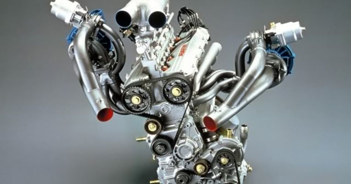

    What’s funny is that I should never need one, no matter how hard I run the thing.
    I’ll save you the fine details, you can read the wiki if you want: https://en.m.wikipedia.org/wiki/Fiat_Twin_Cam_engine
    But these engines were designed to be racing engines from the start, and were used in Fiat and Lancia rally cars until the mid 80s with the same exact bottom end as what came in my car. Most were turbocharged and made over 500hp (some over 800) with a stock, wet sump bottom end. It’s got more WRC titles than any other engine.
    Not really sure how I killed mine.

    lancia was like ferrari on crack.

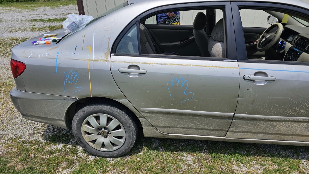

    Step Diddy activities

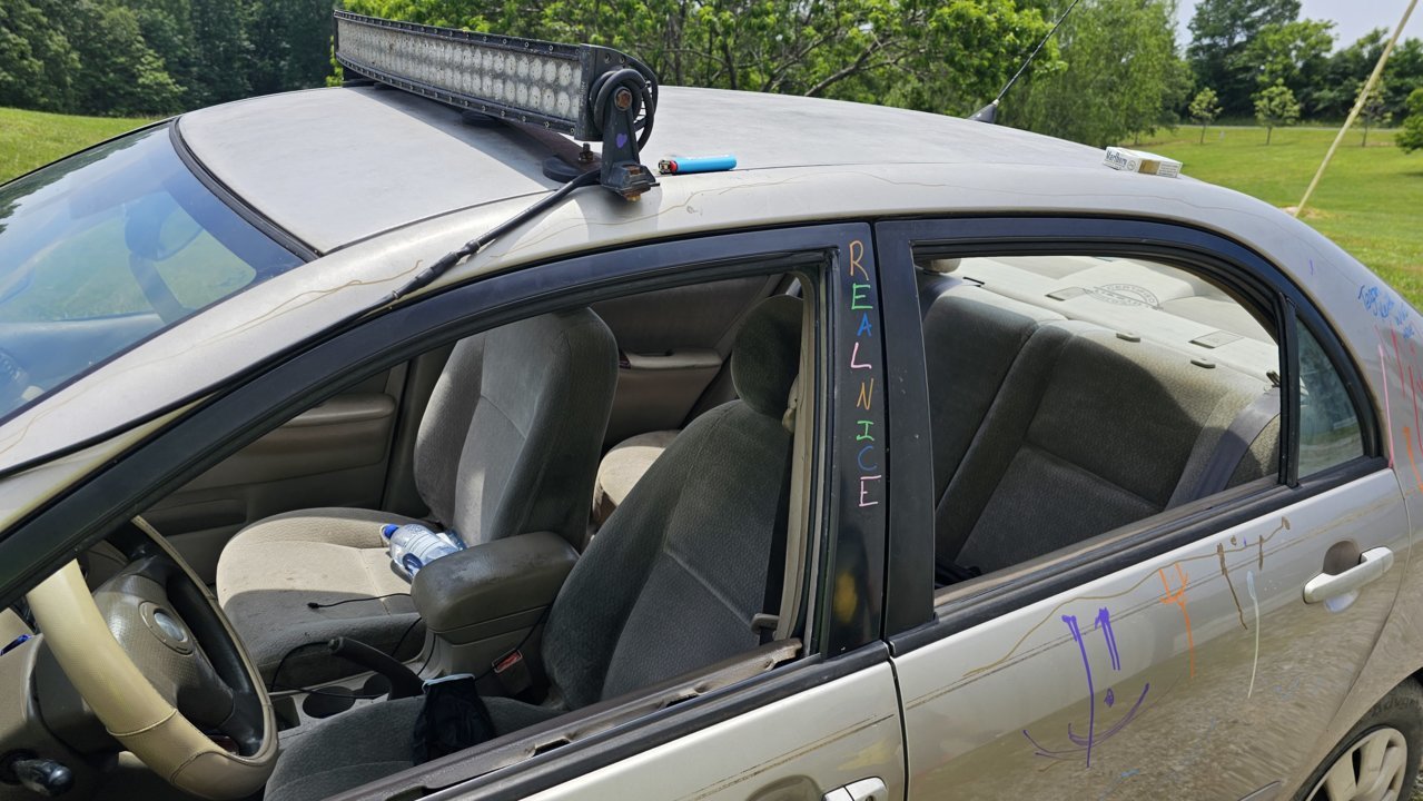

    Pops added his touch

    Norwegium?
    mom used to doodle flowers on my green ford in silver sharpie.
