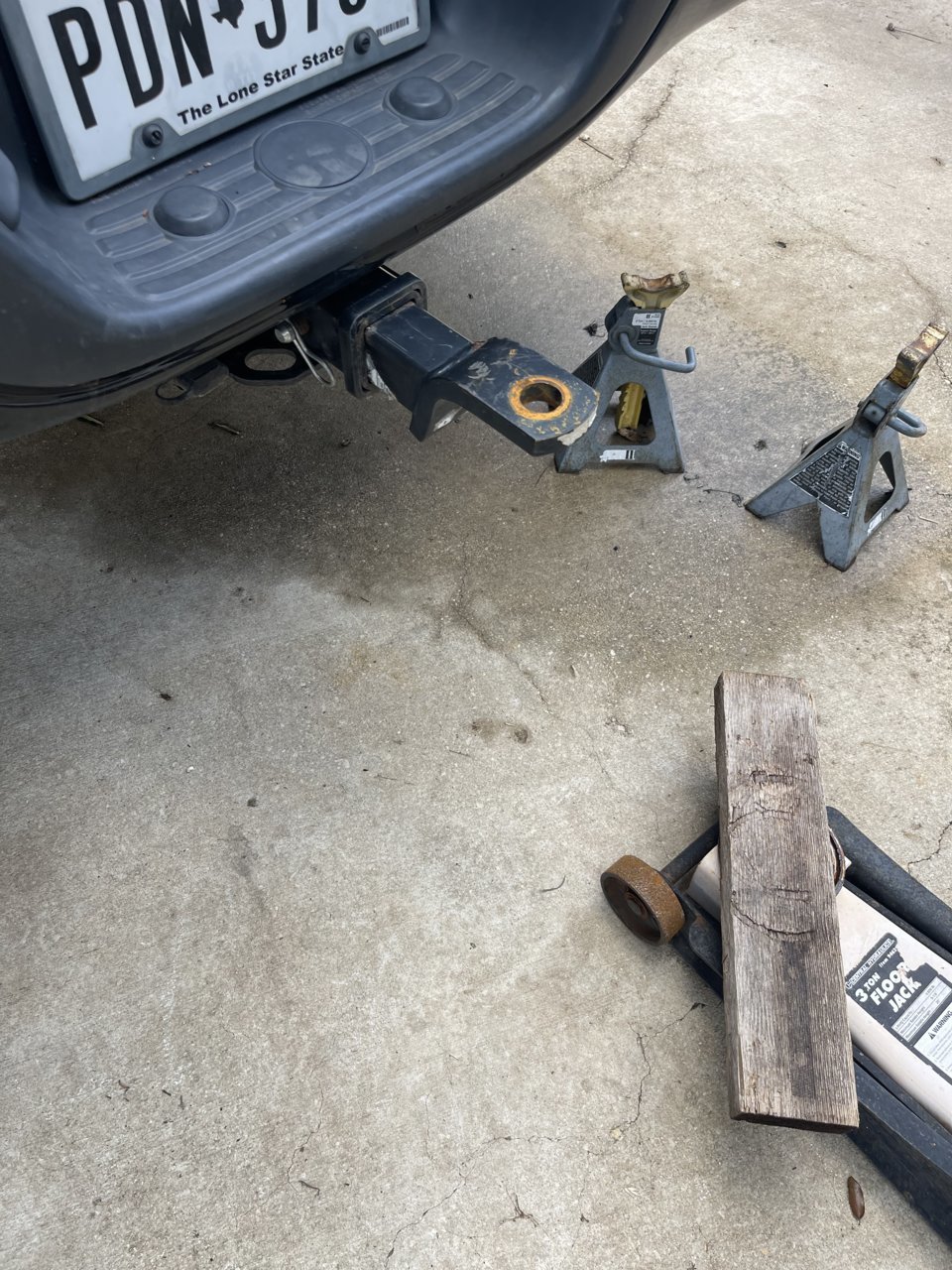

    How ya'll like my 'man step'?
    makes climbing in easier than my non-spaced tires and hopping in an open tailgate. 1 step up, the other step over. And the type of person to tailgate is the same type of person to warp a block trying to chase me.
    i need at least 4" of lift to make this fit relative to the truck. Like a hotwheel. How bad are bracket lifts really? What if you add lots of bracing?

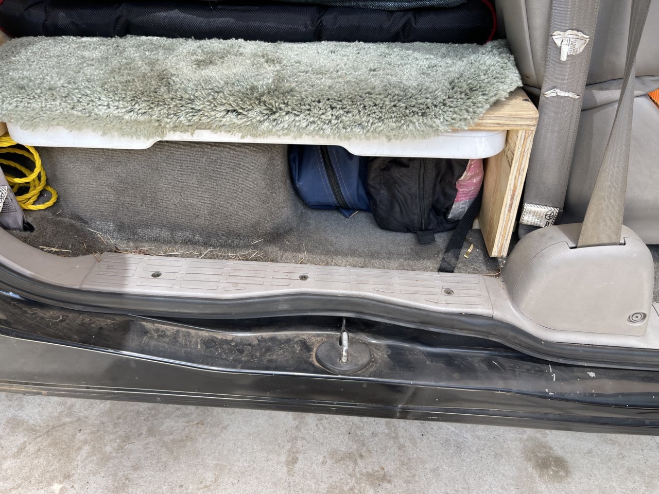

    I can fit both small tents in the nook for the big tent. Tent for stuff & tent for sleep is a pretty good combo. ESpecially if you can leave camp.

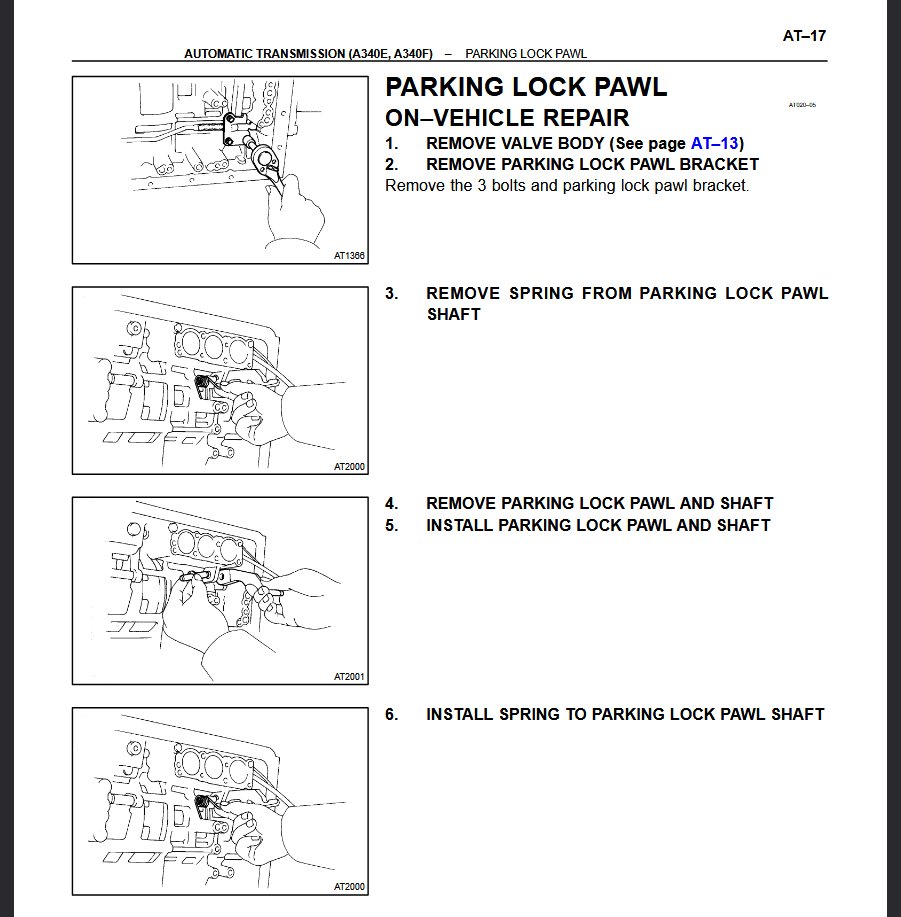

    This last trip, I had my parking brake barely set and I put it in park on a decline to open a cattle gate to pass through. Truck was in 2WD. Kept the driver's door open. About two seconds later the truck starts slipping forward and it sounds like a machine gun. Luckily I was not in front of the truck because I was moments away from getting ran over. Adrenaline takes over and I jump in the truck, stomp on the brakes just as it's smashing the gate open. I get the truck to safety and put it neutral, catch my breath, and run it through all the gears (including 4WD). Then continue to wheel the truck for another 2500 miles. @RUSTYNUTS witnessed it in person.
    I haven't gotten my parking brake setup like I need it, and I actually snapped one of my cables on this last trip. I really don't care for the cables that SOS provided with their kit. I've been exploring line locks and a Wilwood parking brake. With some work, I could potentially run the drum-in-rotor parking brake at the same time as the Wilwood parking brake. I think I'd want to do manual line-locks and only use them in wheeling situations like the gate, not for longer use.
    When that solution is fixed I want to go ahead and just fix the potentially damaged parking pawl. Looks like it's about $75. If I drop the tranny pan to look for debris, I gotta pull the skids. Not hard, just time consuming and I don't want to do it twice in case the pawl actually goes. From there, it looks like pulling the filter and valve body, then three bolts to get the pawl out.

    @des2mtn Do you feel any play when putting into park now on the smallest of inclines? That should tell you if it's significantly worn out; at least what I was told.

    Yes, I think that I do. This is actually the second time it's happened, but the other time the truck barely rolled a foot. From a liability standpoint, I would feel better changing it.

    Where is the pawl? I'm not familiar with it. When I'm on a hill and put the truck in park, it always shifts a tiny amount. I assumed this was normal.

    On the bottom of the transmission inside the pan. It should shift a little bit, unless you've forced it into park while your truck is moving, or you've seen some sort of abuse like mine, I'm sure yours is fine.

    Is that all (remove valve body)? You might as well replace any sticky shift solenoids while you're at it. haha

    That's not too bad then. I used the tutorial in this link when I dropped my pan. It has pictures too.
    https://www.tundras.com/threads/tra...ed-pan-replacement.105466/page-2#post-2722572
