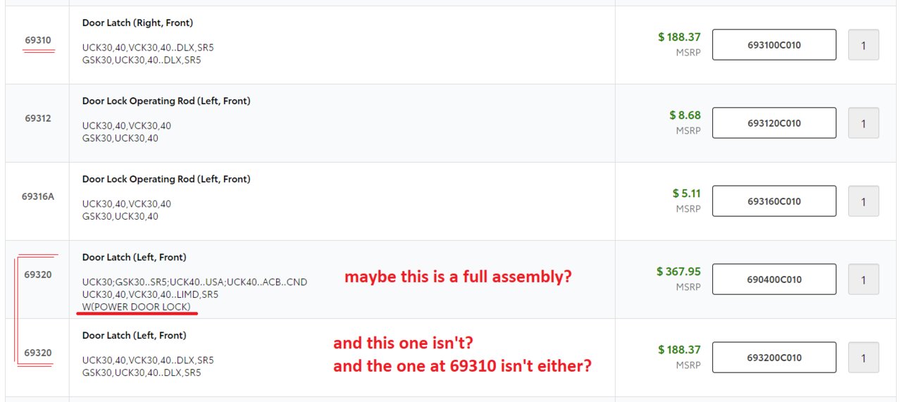

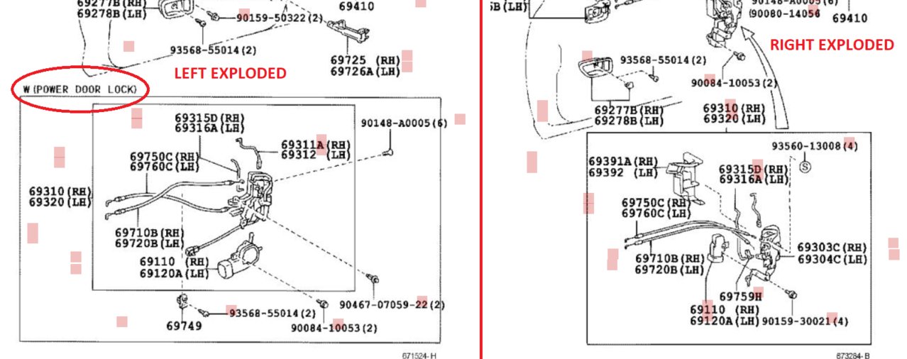

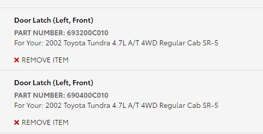

    https://parts.toyota.com/a/Toyota_2...1696/FRONT-DOOR-LOCK--HANDLE/841420-6753.html
    Your 2002 truck, front door assemblies ^^

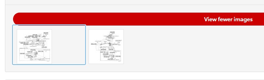

    Note there are two exploded images:
    The one on the left is POWER DOOR LOCK, the one on the right is NON POWER, as you see indicated - note the lack of power indication on the right-hand image:
    In this case, it looks like they're boxing the power locking mechanism as "69310" for the right hand assembly, and "69320" as the left-hand assembly. But here's where shit gets weird.... the driver's side clearly shows there's a power lock option at double the cost. Which is weird. But the passenger doesn't. And they don't give a part number for just the mechanism, like they do with the RIGHT EXPLODED. However, I CLEARLY see in the image the non-power exploded carries a different part designation, "69303C" and "69304C" for the non-power mechanism, which, interestingly isn't in the list.
    So I dug a little bit. This is what you'll get with 693100c010, according to Toyota Parts Deal: https://www.toyotapartsdeal.com/oem/toyota~lock~assy~front~door~rh~69310-0c010.html
    And for the other part 693200c010: https://www.toyotapartsdeal.com/oem/toyota~lock~assy~front~door~lh~69320-0c010.html
    I was able to find this eBay listing for two out of stock products with those numbers, and the seller listed the other "6930_0c010" numbers in the parts area too, adding to the confusion.
    My best logical guess is, the parts system is missing the ball on this, and the 6930_0c010 part number is the non-power and/or it's a complete assembly with actuator.
    Honestly, I'd probably see if you could get on the horn with a dealership to confirm before ordering. I think your part numbers will be 693100c010 and 693200c010. but I'm not working at a Toyota parts department.

    Possibly. You got me beat on the exact part number. I don't like spending other people's money, and Toyota Parts shops don't usually have no-questions-asked returns will full refund unless they choose the part.

    Eric gave me 2 part numbers, one D/C'd :) I asked him what I do now :)
