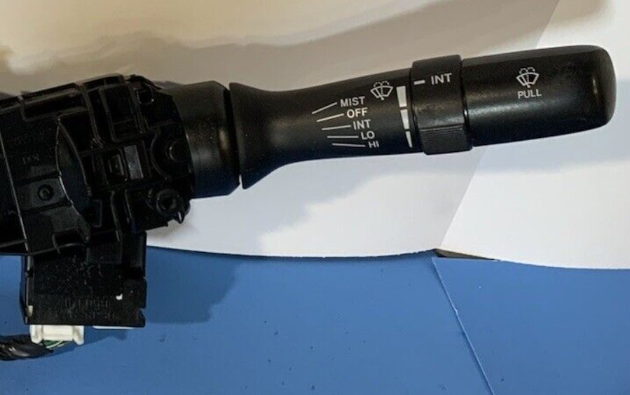

    Pull forward to wash, push up to swipe, down to engage. It’s all so intuitive. I’ll buy some random sequoia stalk and see.

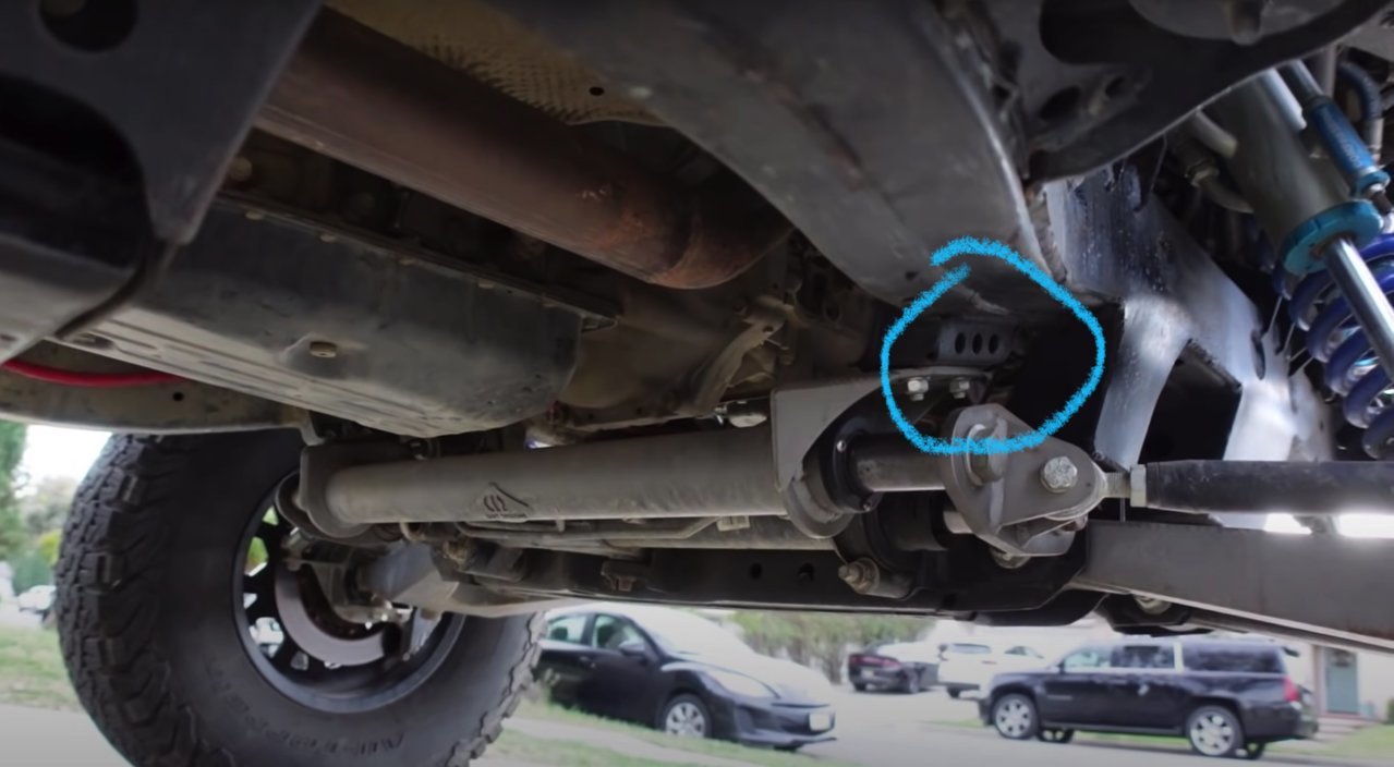

    I don’t think that one’s a Hydro assist I don’t see the plumbing. from the description:
    This can also function as a rack-slider to help alleviate some of the stress at the rack and rack mounts.
    I don’t think I would mind a rack - slider….

    those brackets arent handling alot of stress.

    they are boxed and welded…I think they might

    Those might be jest a secondary attachment to a kind of spacer tho-? Are there other attachments?

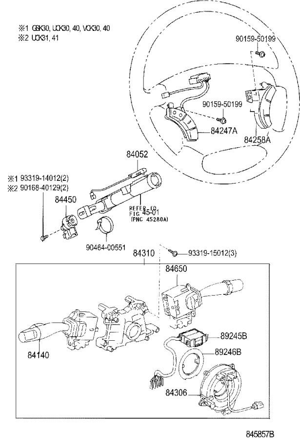

    @daveeasa I started digging thru parts and ...
    For my '06 here, in the switch/relay/computer section: https://parts.toyota.com/a/Toyota_2...2060/SWITCH--RELAY--COMPUTER/841420-8401.html
    In the 2nd row of diagrams, 1st picture, we see the components on my late model 1GT (more after the pic):

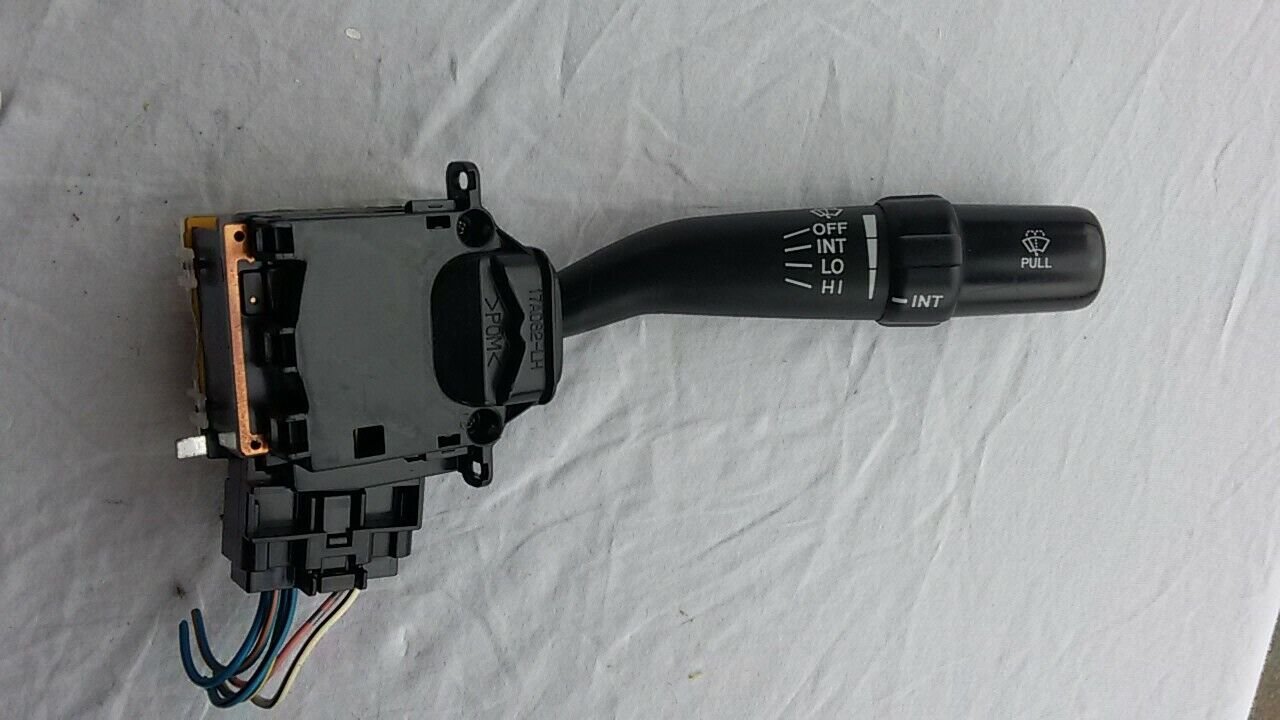

    84650 in that diagram traces to part 846520C021.
    Here is a pic of the part, with wire/colors, taken from fleaBay (this apparently also fits a Solara - more text after the pic)

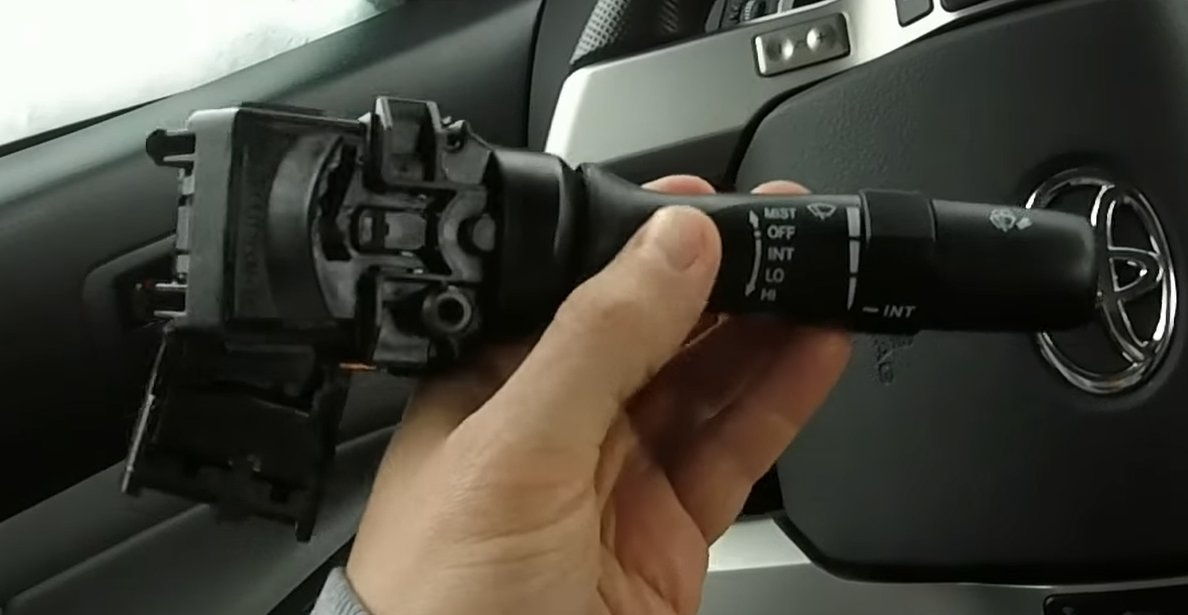

    It looks similar but significantly-enough different from the wiper stalk the 2nd Gen Tundra and 2nd Gen Tacoma guys are upgrading to when they don't have intermittent, which also includes a 'tap up' feature, which is like this:

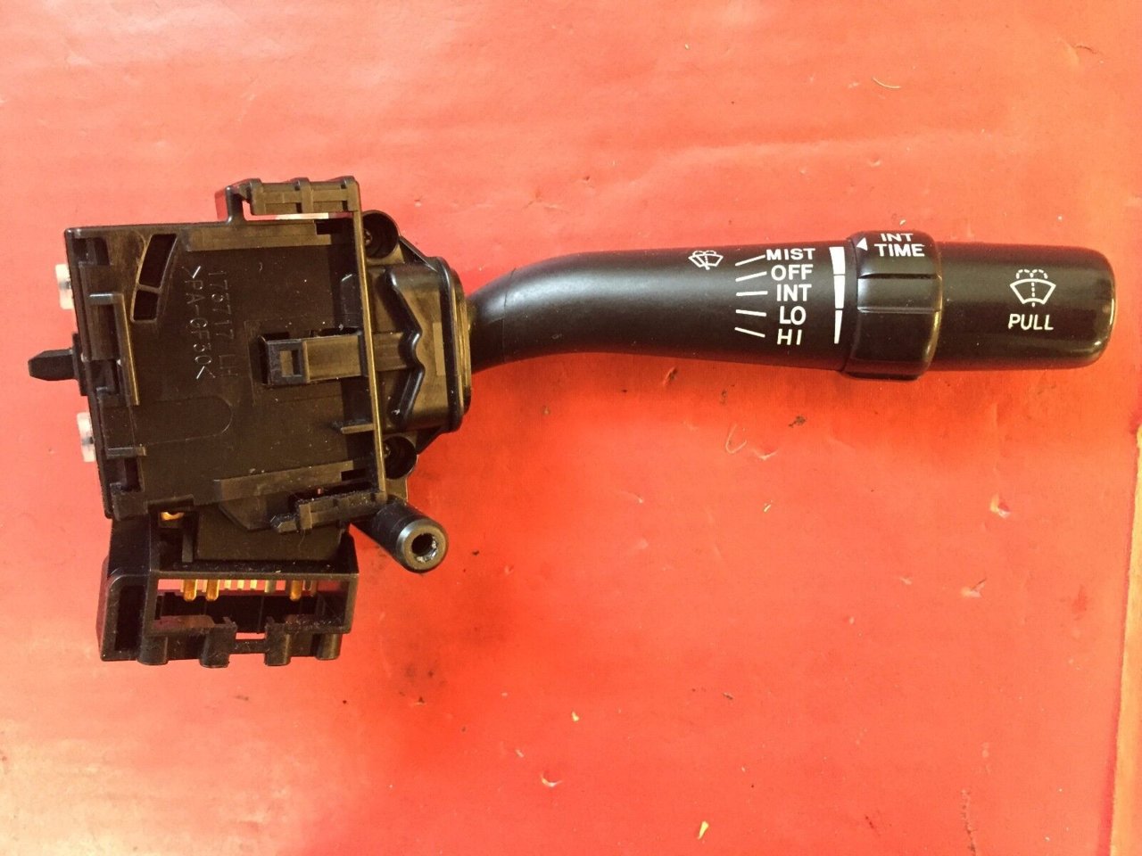

    So i looked at the 2005-2007 Avalon, and the switch is fairly similar, and includes a tap-up option... looks like it could be a probable option? Except, I can't tell the difference between tap up and twisting the end, the icon is same for both.
    Can't use a Sequoia or minivan switch because they use a rear wiper, it must come from a sedan/pickup with no rear-window wiper. I looked at a few '07 Sequoia stalks and they don't incldue tap-up convenience wipe anyway.
    So I dug around a little more, and checked Camry. 2002-2006. This looks like a potential winner too, styling is very similar, p/n 84652-21030. Virtually identical on the stalk appearance. Chassis is a tad different.

    Ah, it's called mist. Would be fitting to have mist for my moon mist truck.

    I don’t know. The company that built the truck stopped posting to Facebook in 2014. They might have become dirt king. But I don’t see anything on that site.
