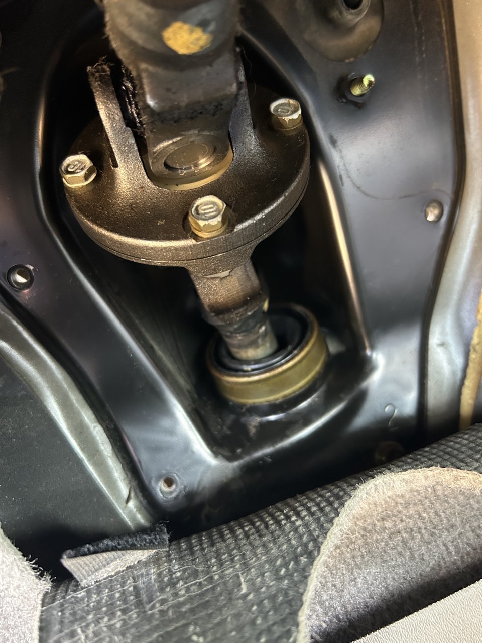

  7. Mar 8, 2023 at 11:31 AM
    alb1k
    Mar 6, 2021
    #60092
    6,564
    Left Coast
    05 2WD DC w/ attitude
    It's good
    no, you guys are right, but the shaft is banging around in there. I’m trying to pull it to inspect the u joints and stuff. I’ll get the seal for sure, now just looking to see why the play.

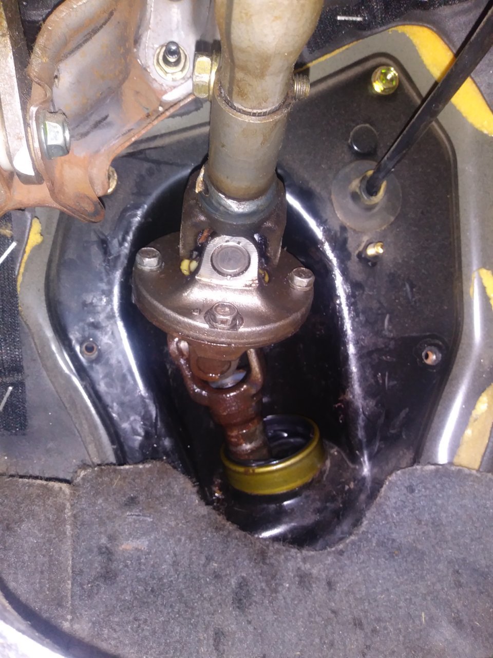

  8. Mar 8, 2023 at 11:31 AM
    shifty`
    shifty` Dead heads and frog legs. Mmm... cake mix!
    Jun 20, 2020
    #48239
    30,722
    ATL
    '06 AC Limited V8/4WD
    I remember seeing one person on here whose shaft was all kinds of whacked out. I asked about it, but can't remember whether they responded back or not. Surely all the weight and pressure can't be resting on that one seal?!
  9. Mar 8, 2023 at 11:35 AM
    shifty`
    Jun 20, 2020
    #48239
    30,722
    ATL
    Here you go, check this out: https://www.tundras.com/threads/loose-bolts.106614/#post-2749166
    @Treeclimber mentioned something about "3 of 4 bolts were out" so there certainly must be some bolts and a u-clamp or something to hold the shaft in place? Or maybe he just means to the pressed plate bolted to the firewall. It would be a massive safety failure if all the weight of steering rested on one bushing.
    RUSTYNUTS and Sunnier like this.
  10. Mar 8, 2023 at 11:43 AM
    alb1k
    Mar 6, 2021
    #60092
    6,564
    Left Coast
    It's good
    Yeah - mine looks way better than that and all 4 flange bolts were good and snug. But my shaft is favoring the seal side his does, and i can wiggle it and bang it around. maybe the seal has enough hold to steady it and play is normal. Not sure, but since I'm gonna replace that seal ill pull it out and check the joints.
  11. Mar 8, 2023 at 11:44 AM
    FirstGenVol
    Dec 13, 2018
    #22934
    14,350
    East TN
    2002 AC TRD 4x4 V8
    His seal is almost completely gone in the middle if you look close.

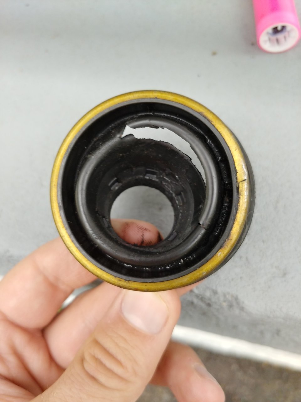

  14. Mar 8, 2023 at 11:49 AM
    FirstGenVol
    Dec 13, 2018
    #22934
    14,350
    East TN
    2002 AC TRD 4x4 V8
    Here is what my old one looked like. I had a hell of a time getting the steering wheel straight after doing this job. There are splines on the shaft and if you are off even the slightest it will be obvious with your steering wheel.
    RUSTYNUTS, alb1k, NUDRAT[OP] and 2 others like this.
