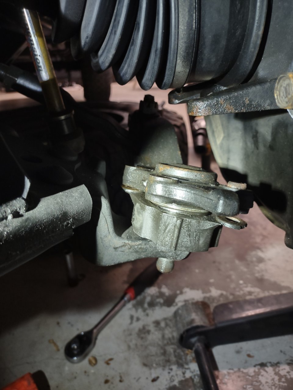

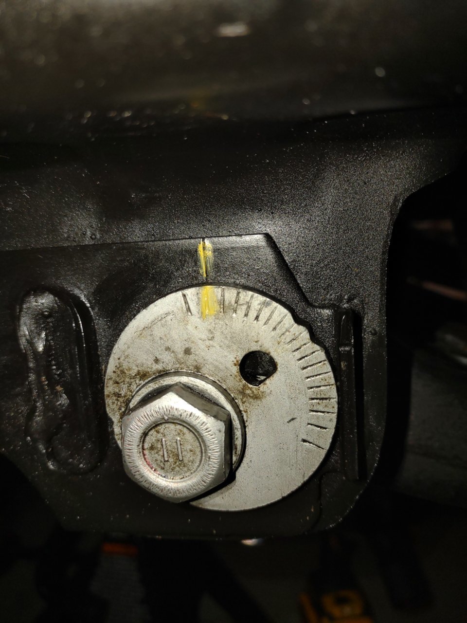

    Two questions. What color Loctite are we using on LBJ Bolts?
    2nd question, what exactly am I supposed to be marking before removing these? Am I on the right track here?

    I'll leave your loctite question for someone else. But yes, that marking is fine. As long as it's durable enough to be visible when you go back to adjust it next time. My marks must get ground off my sand or something.

    I've been using medium strength HF personally, which is probably equivalent to Loctite blue and not "permanent".
    And that's pretty similar to how I marked mine during replacement on each adjuster. Then took it in for an alignment a few days later.

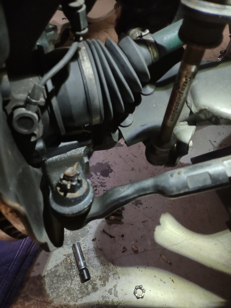

    Going this route, do I even need to remove my tie rod from the lower ball joint? I assumed I would have to but now I'm thinking I can just lift the whole thing.

    Nah, I'd leave it alone unless you're changing the LBJ.

    Well hot damn. That's good. Any reason why the ball joint isn't just lifting right out of the LCA hole? I'm hitting it with my purse. The castle nut is off.
