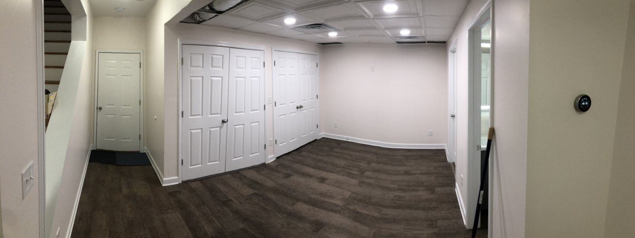

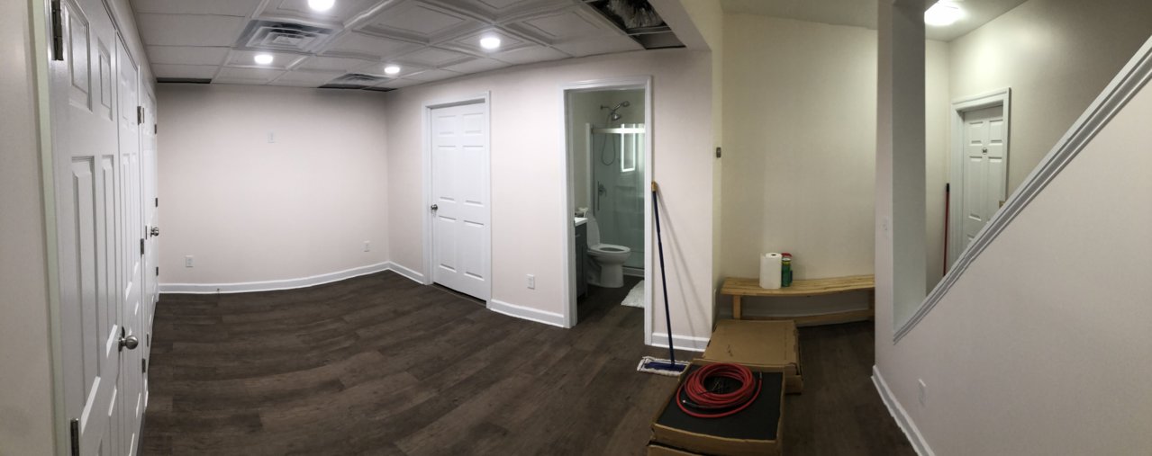

    In hindsight, it probably would've been easier to do it that way, less messy. I do like the glue-down stuff though, the couple of planks we've had to cut up weren't horrendous to remove, and dropping in a new one was a no-brainer.
    Here's where we ended up with the LVP in the basement. The guys who installed this half didn't do as good of a job as I did with the half I installed, but ... that seems to be the case everywhere these days. You want it done right, with extra attention, do it yourself, else you'll kick yourself about every flaw you find later. :D

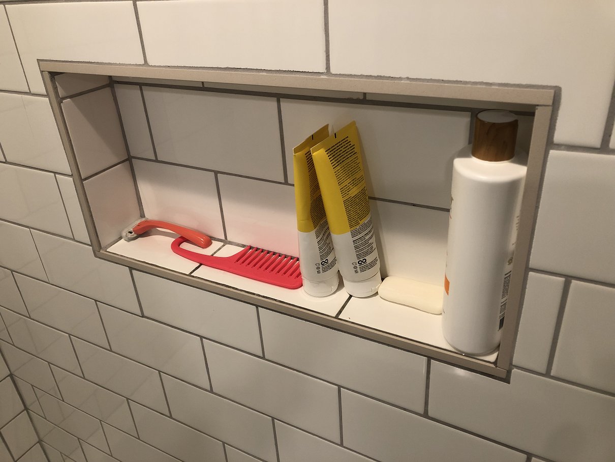

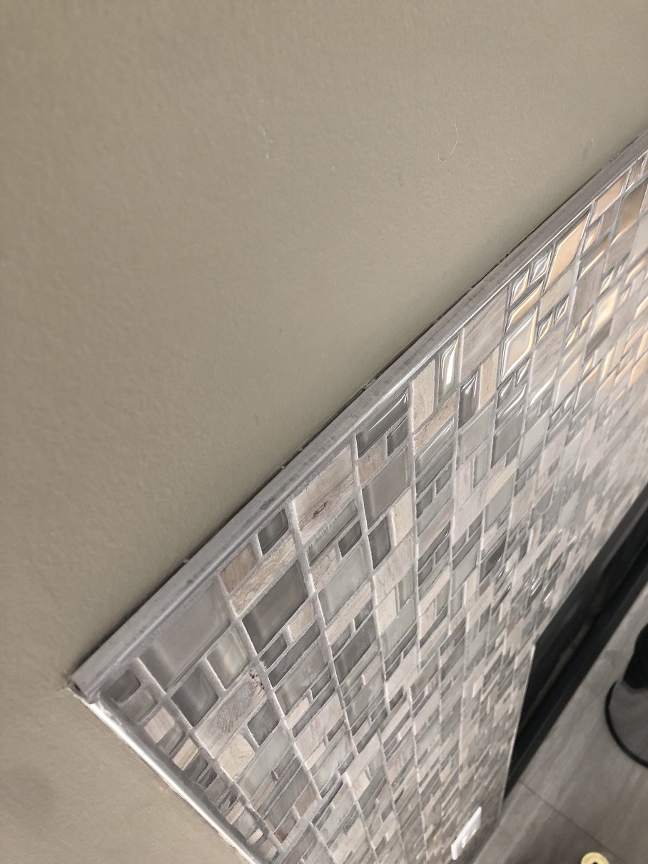

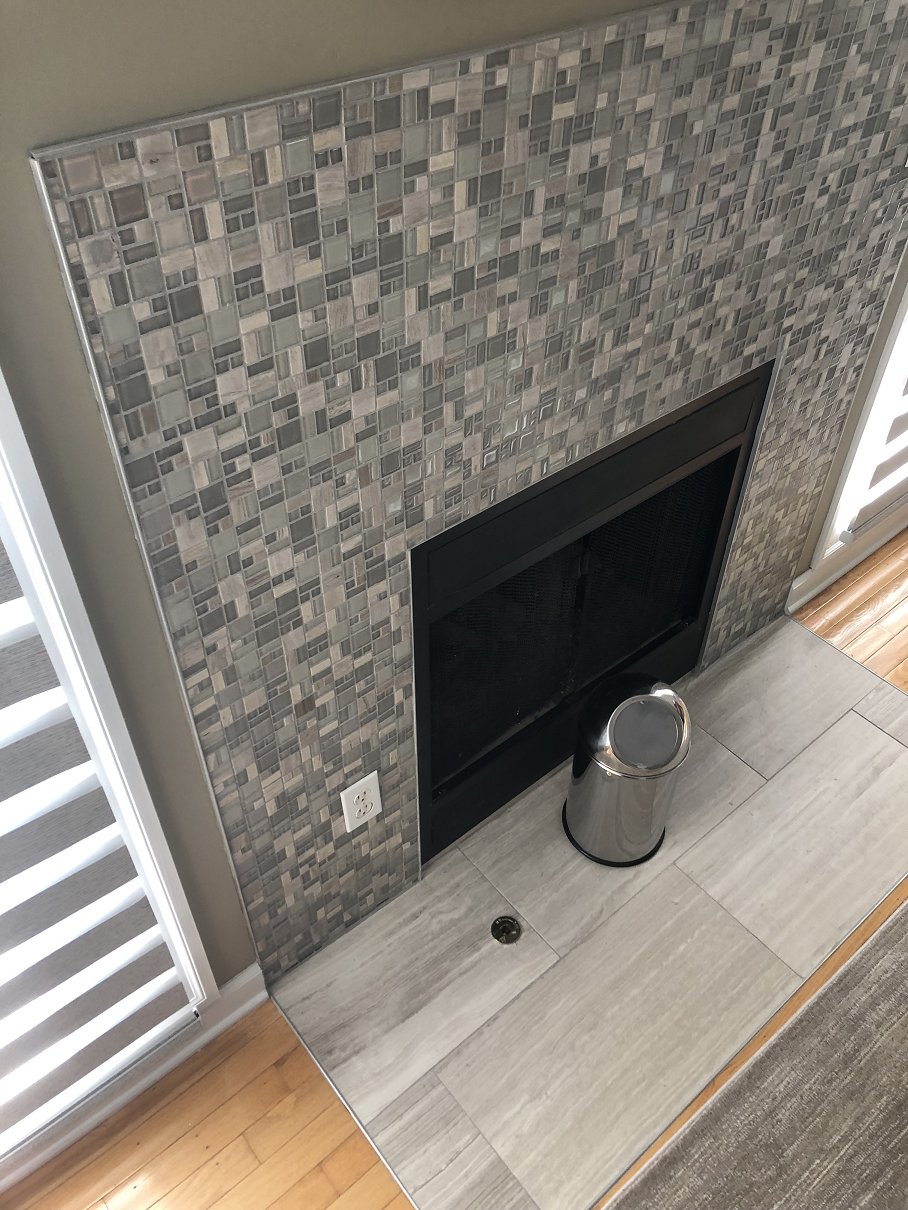

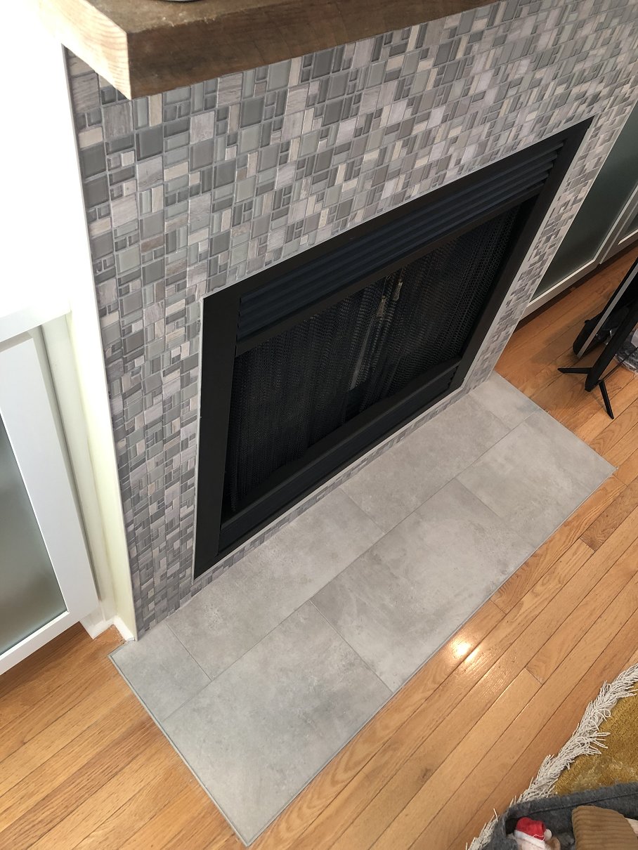

    Yes! We used Schluter for all of our tile edges, in-wall boxes, and around our fireplace hearths. Makes a good in-floor thin border, and a raised edge to conceal the sides.
    (Bonus if you find the super-aggravating tiling mistakes on both of the mosaic tile sections... Two different tile guys, at least one mistake is same on both, and the joins and lack of seal on the Schluter pisses me off, just not enough to seal & repaint)

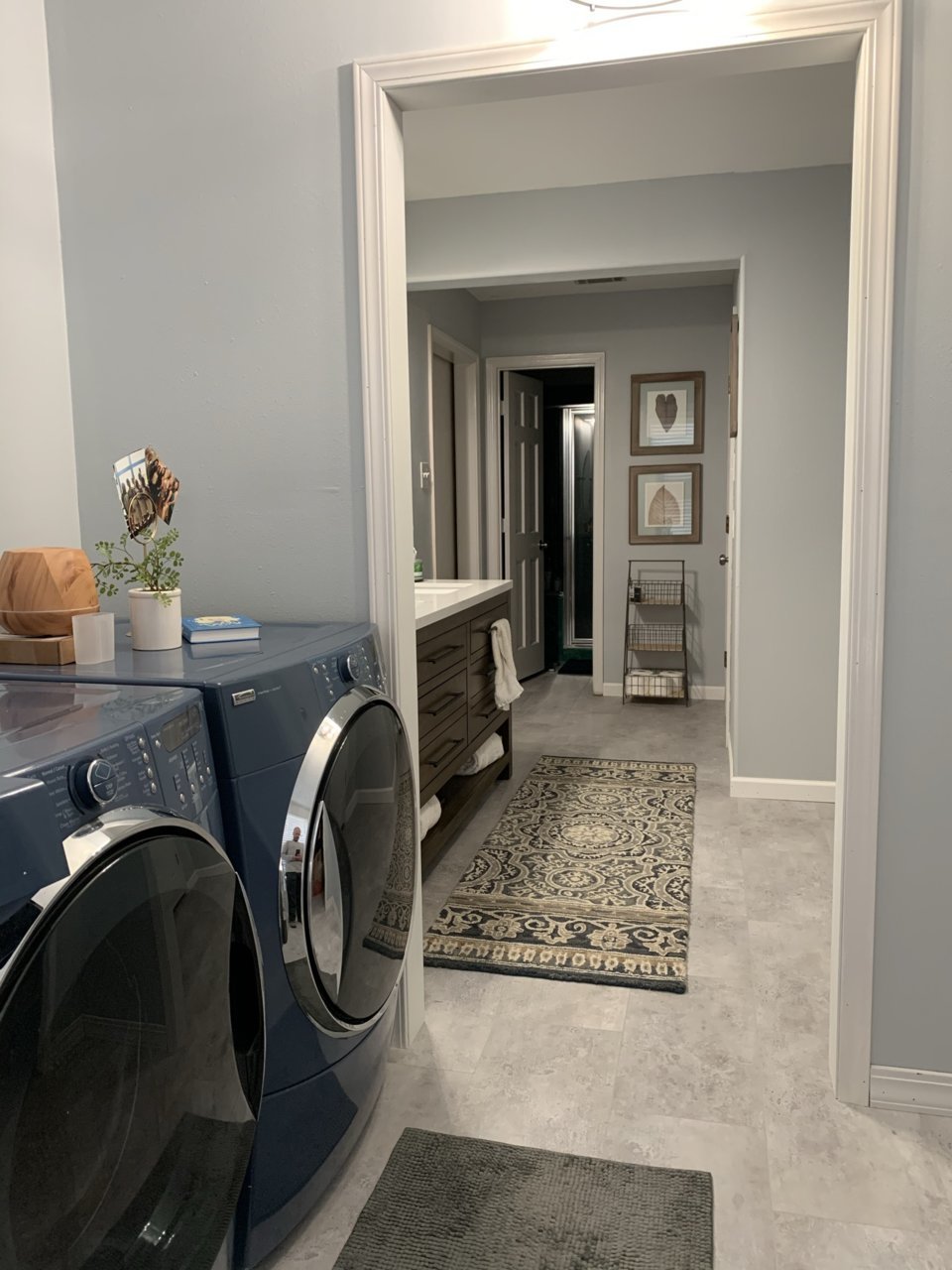

    LVP in our last house:
    in our current remodel:
    shifty` likes this.

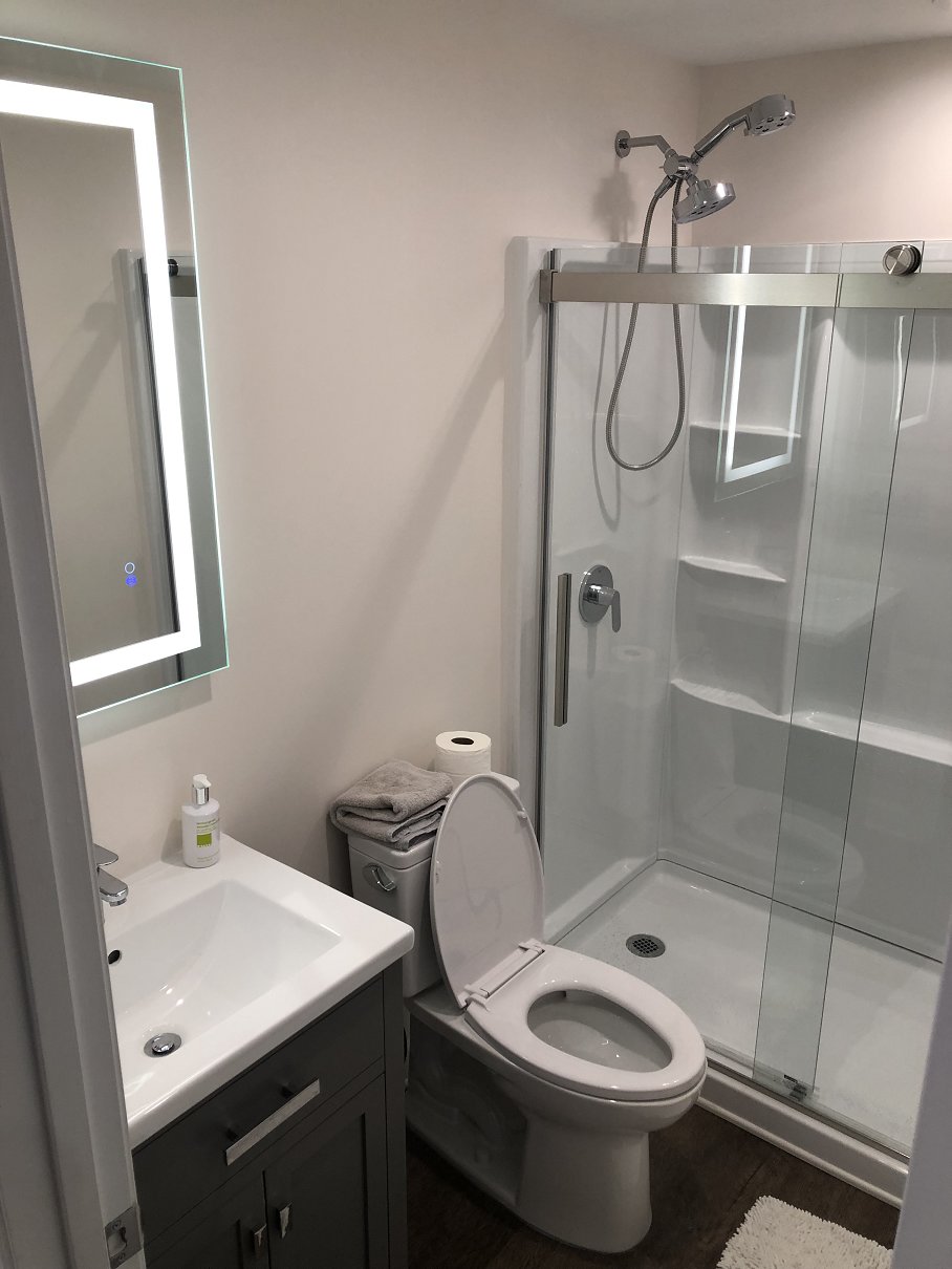

    This is the bathroom I'm gutting. I was considering just reusing the existing shower pan. Wife said she'd be cool with that to save money and make it easier.

    Always use greenboard in moisture-prone areas. Ideally use hardybacker in wet areas, and coat every inch seamlessly with Redguard to waterproof it before tiling over.
    If you need to build your own pan versus using a pre-formed pan, make sure your liner has no cuts or seams going up at least 6", I personally went with 12" in the first shower I built, which was stupid, because the entry curb was 6", but whatever.
    Honestly, a 3-piece unit with pan like what I'm showing in my pics above is tasteful, easy install, doesn't leak, easy clean, no mildew issues, comfortable. They make them in all shapes and sizes, shower-only, or shower-tub. Some people think they're cheap, but there's some really easy stuff out there. You can re-use your existing pan.
    If you don't love acrylic / fiberglass units and hate the price of poured composite marble-wall showers, there's stuff like Kohler's Choreograph as a DIY thing, or Kohler's LuxStone, with the benefit being, it's impervious, you basically glue the interlocking wall direct to greenboard, over your existing pan if compatible.
