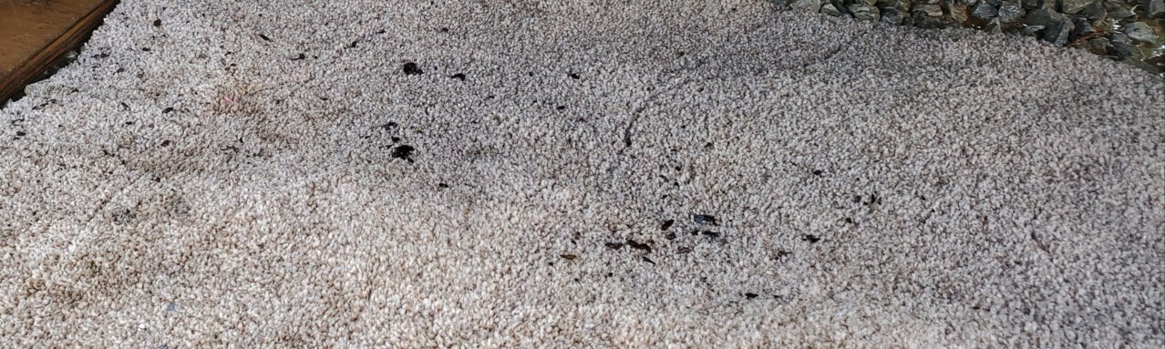

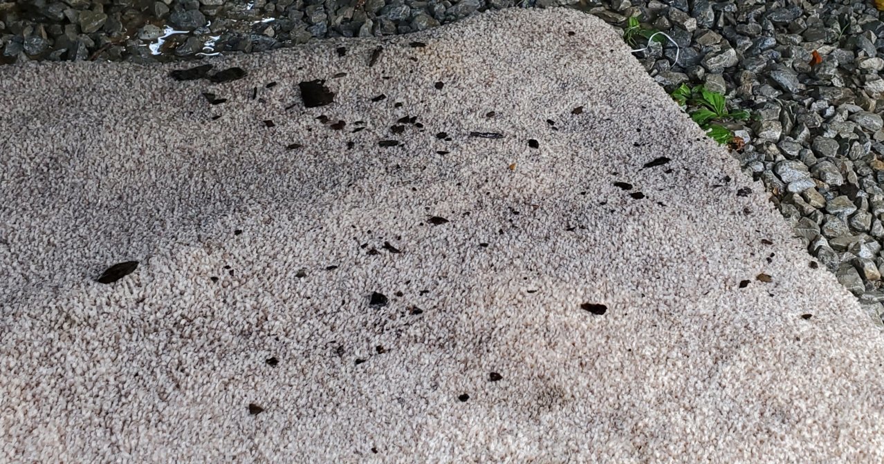

    Well, followed @Professional Hand Model's idea.
    Jacked up front of truck, and removed front left wheel for better access to frame. Tapped on frame with a hammer, and heard scale fall inside the frame to roughly 10 inches forward of strut area. Hosed a LOT of gunk out. Here are pics of my catch carpet. I didnt think to catch remnants until halfway through the job. 20200622_114052.jpg
    This big chunks here are just about the same size as the chunk I had in my hand the other day.
    Little remnants from between cross member, and wheel well areas.

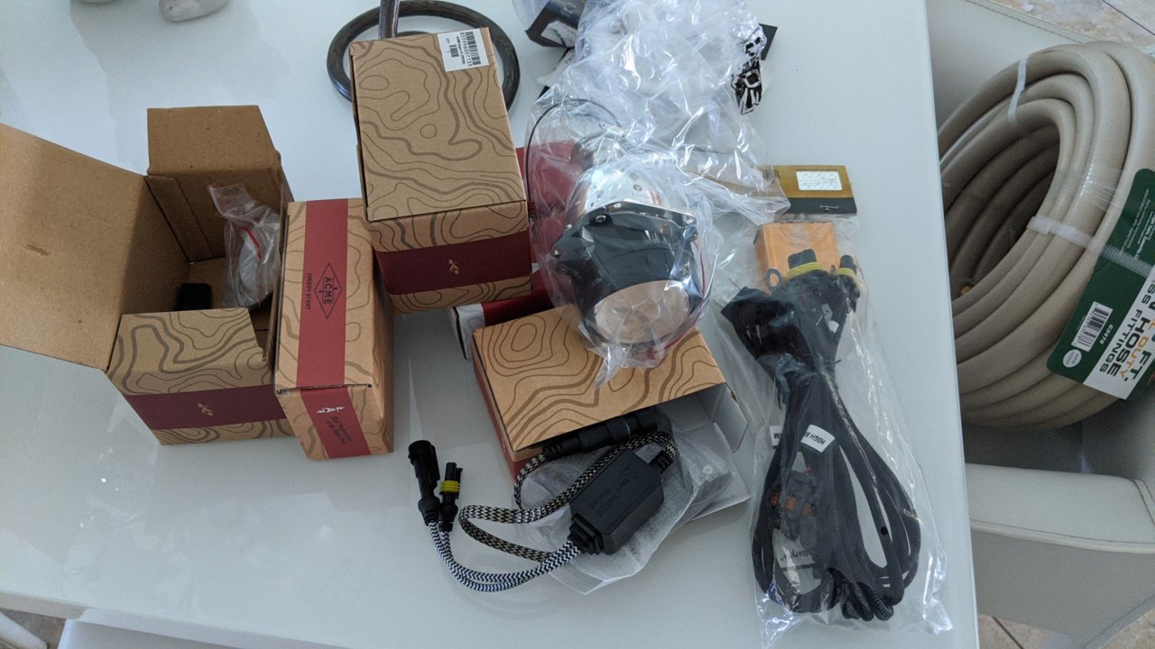

    Look what showed up in the mail today.
