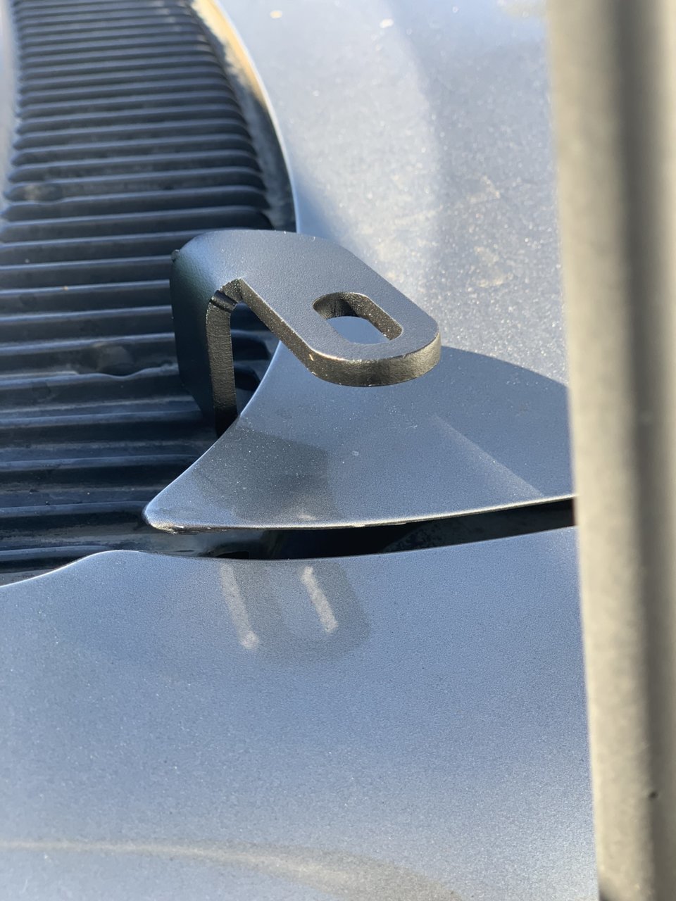

    This is the only picture I have readily available, I'll take more of the backside and cowl today if I remember. They are definitely sturdy. CBI didn't have theirs out yet when I bought these.
    Here's one of the reviews, it's possible the earlier trucks are more likely to have issues with the cowl? @Tundra2 had to trim his he said. upload_2022-12-26_6-25-40.jpg

    Just slide the hood forward 1/8"?

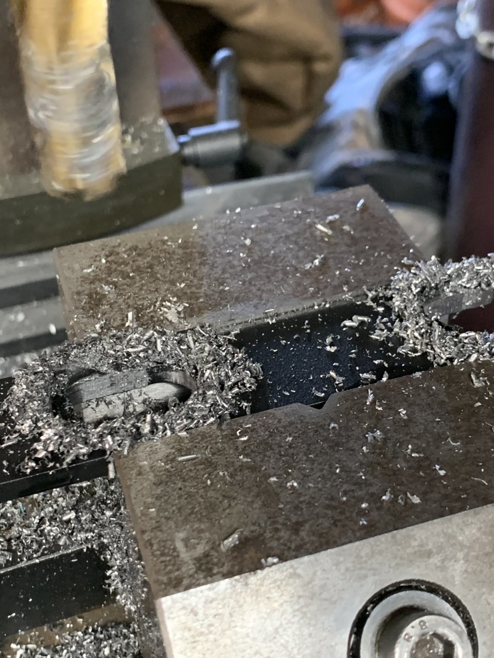

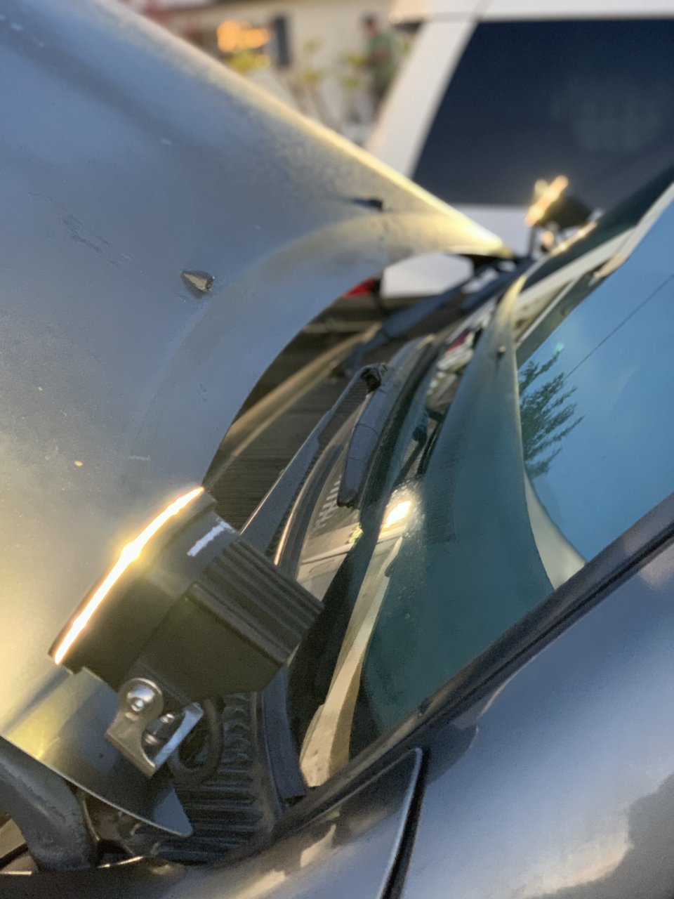

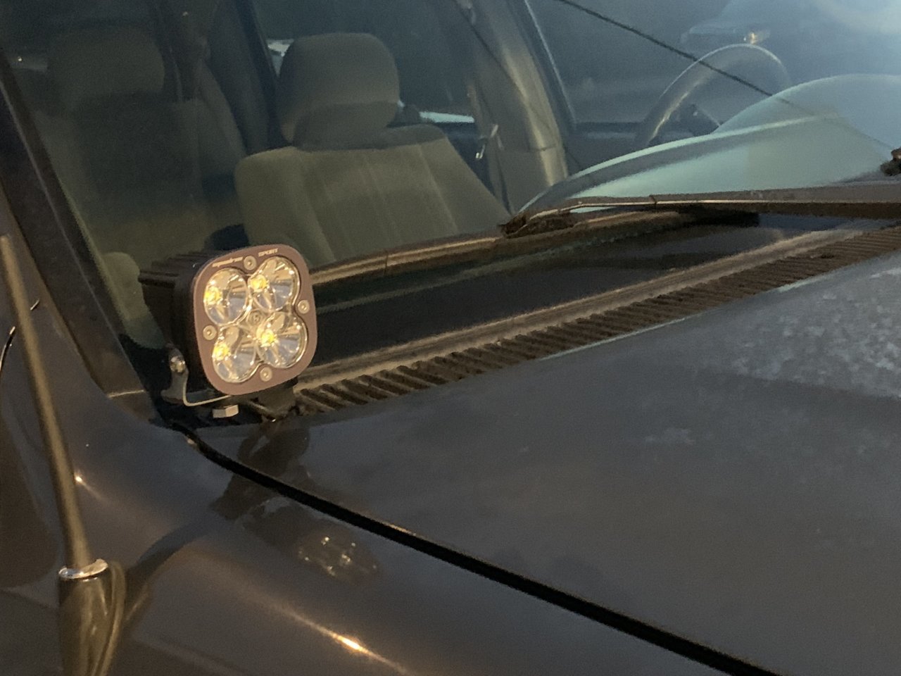

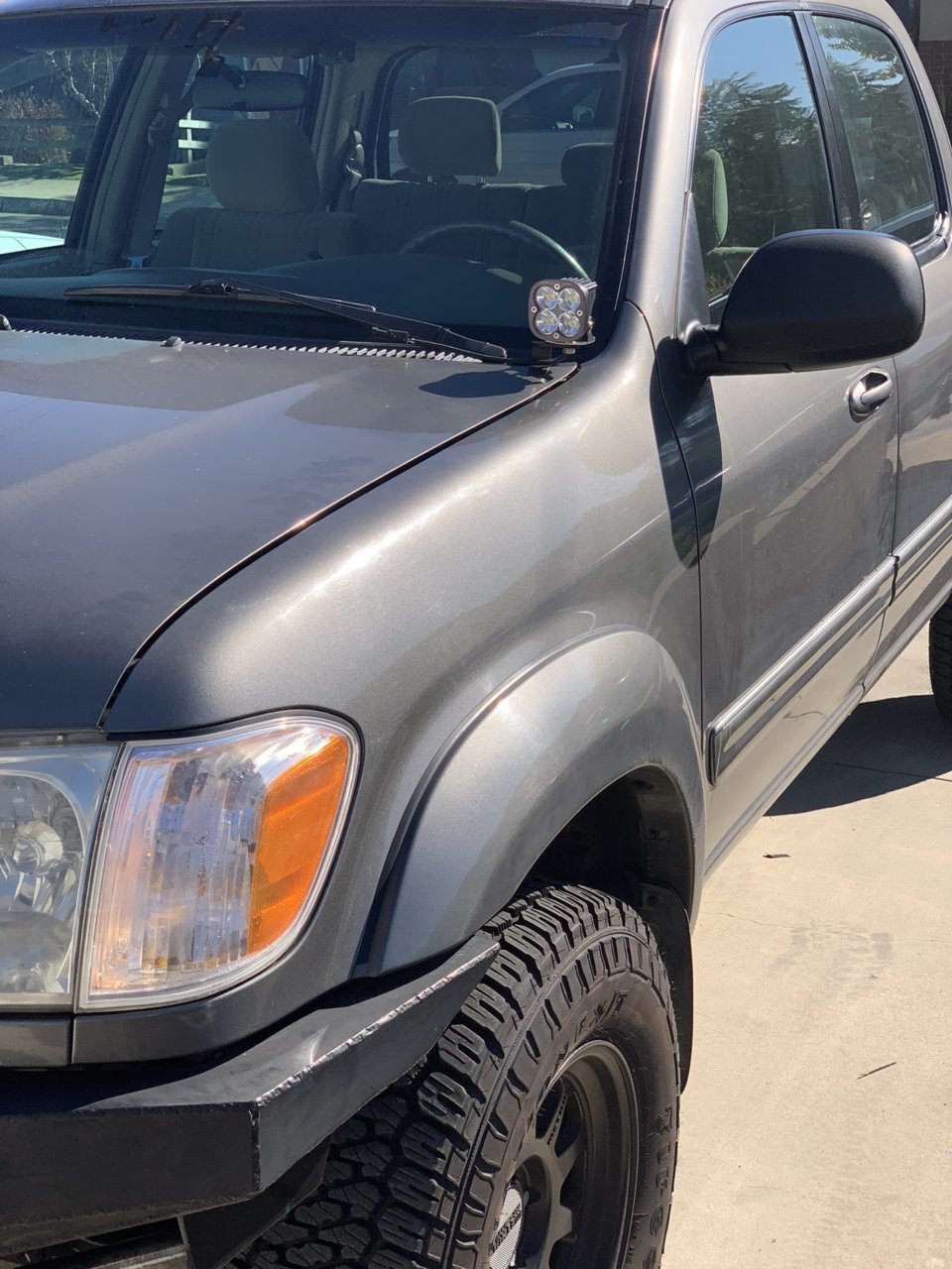

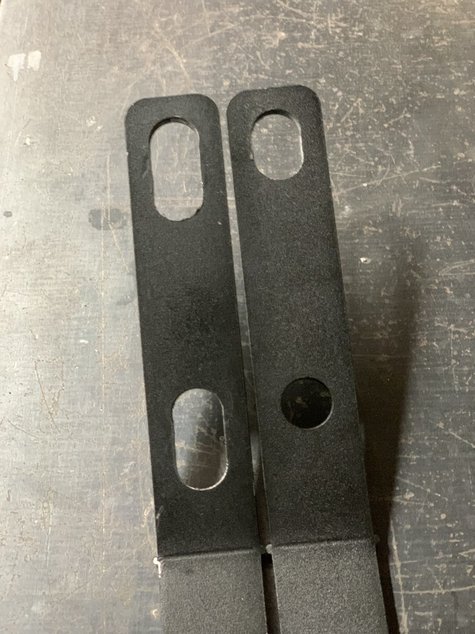

    @Tundra2 did write up about his Rago, I remember that when I was researching. What I didn’t remember is that I milled my CBI, to shift them all the way forward to create cowl clearance.
    0C902F48-9C1C-4DF3-A277-DC7F3EC328ED.jpg 4AAB5807-7931-4235-BDBA-9048B0720020.jpg 469E7F08-4299-44BB-959F-60376942AB91.jpg 086D36C6-C1C8-4832-BD6E-5C12E0B8B8C7.jpg 4F942BAC-7B87-4651-B8C4-6D2CC5772549.jpg 4D5710BC-83D5-4788-9EC1-B303676A2D4C.jpg

    Did you still make cowl contact even after milling the holes out?
