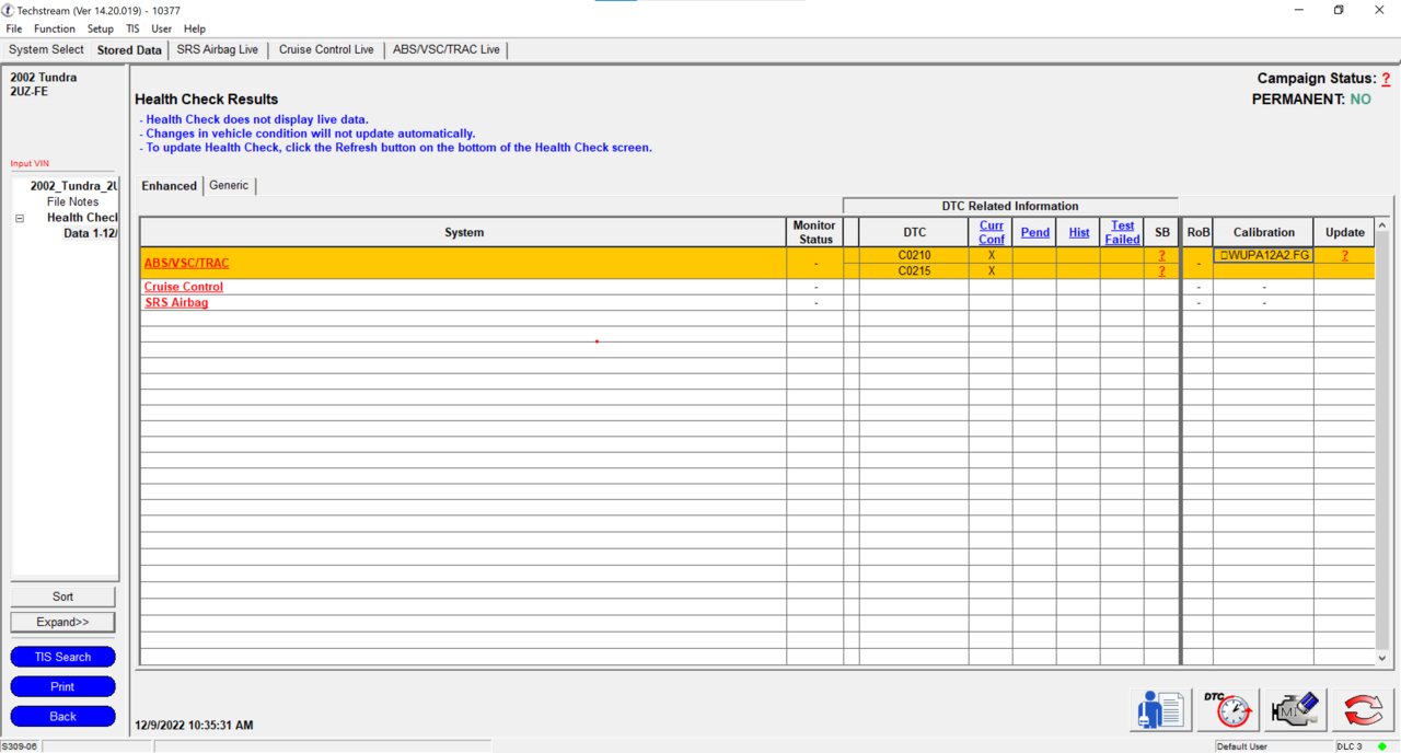

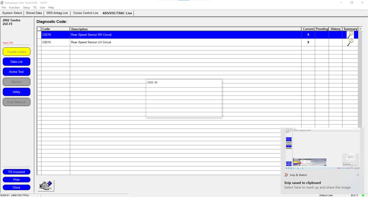

    @empty_lord any help on these? Looks like I maybe have 3 problems? Airbag, cruise and ABS? I visually checked sensors and they seem attached. Perhaps the integration relay swap did not go properly and some of the connections are not good? Seems like maybe airbag system is entirely without power since it can't connect but maybe TS needs something else to talk to an '02? I dunno, not sure what my next step is here other than maybe unplug the entire set of integration relay connectors and re-plug them all and see?

    Interesting how the 1st cluster is all centered around stuff integrated to the steering column/wheel eh? Like, I wonder if it's a clock spring issue?
    I dunno if the speed sensor circuits may somehow hook into cruise by way of the clock spring circuit, so not sure it explains the latter.

    VSC / Speed could potentially be trouble from the lift, I did have a trac problem on a fairly recent drive which went away on the cluster with a restart. Clock spring could explain cruise and airbag trouble, though cruise does seem to work fine for some reason.

    Cruise relies on WSS. So there's that link. If there truly is a break in the circuit in the WSS (but on both sides at once? the odds are staggering...) that would explain the cruise issue.
    Problem is, I see two potential threads here. I'm trying to wrap my head around whether SRS needs WSS input or not. If so, WSS is the common thread. If not, you have two common threads: WSS is one, clock spring another. It's pretty unusual two have two unrelated problems at once, so I'm hunting the common thread.

    This is complete conjecture on my part, but it makes sense the SRS would use WSS as well in order to prevent an inadvertent airbag deployment when it's unnecessary. It's logical that for the airbag to deploy it would want a trigger from the SRS at the front of the vehicle from the impact AND a trigger from the WSS indicating an MASSIVE instant reduction in wheel speed.

    That was my thought too, you wouldn't want it to go off in a low-speed bump or jostle, like loading onto a flatbed towtruck. But I haven't seen where the WSS and SRS cross in any of the EWD. Granted, I suck at reading the stupid EWD, and it could be that the intersecting common point of the circuit is the ECU....
    EDIT: But that would still leave the core issue of "what could possibly impact both of the rear WSS and/or their circuit?!"

    Rear lift? Jason didn't exactly list out the things he did and the taillights were disconnected when I picked up the truck (granted he had to lift the bed). He also did rear drum brakes. It could easily be a simple connector not seated well, but I'd rather not wiggle around on grass or my super steep driveway figuring it out so I think I'll wait for an opportunity to take it into the garage.

    I mean, you could ask if he dicked around with the wheel speed sensor wiring? Or trace the wiring to see if anything changed, or if he disco'd the sensors somehow? Or maybe if he removed for any reason, he didn't re-seat properly? I don't know the WSS differences from your earlier gen and my later gen. Hell, I haven't even touched my own, ngl.

    He's overloaded so asking him probably won't help much. I'll have to diagnose/troubleshoot on my own a bit which is fine. Or take it to Toyota but I think I want to confirm my integration relay isn't the trouble somehow. And if it's going there to get "fixed" then I'm tempted to get the new wheel and airbag in first so they are on the hook to get that working too :)
    I don't even really mind spending money on this truck for some reason, it's just so awesome and even with doing the work I've done, it's still way less expensive than any 2.5 Gen would be.
