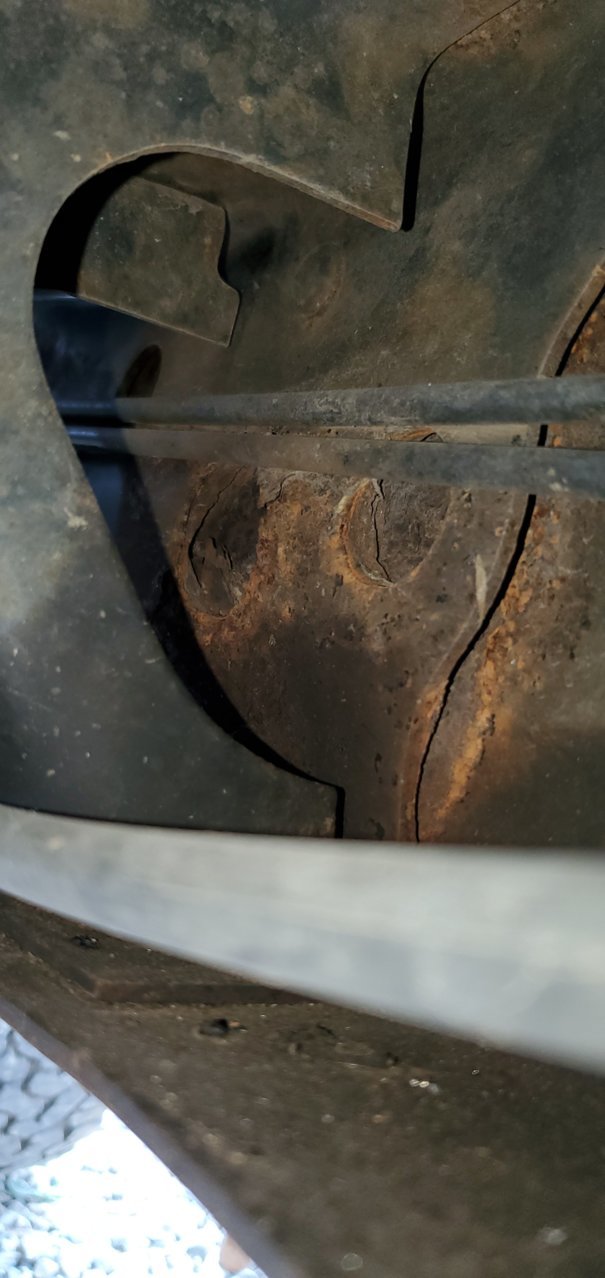

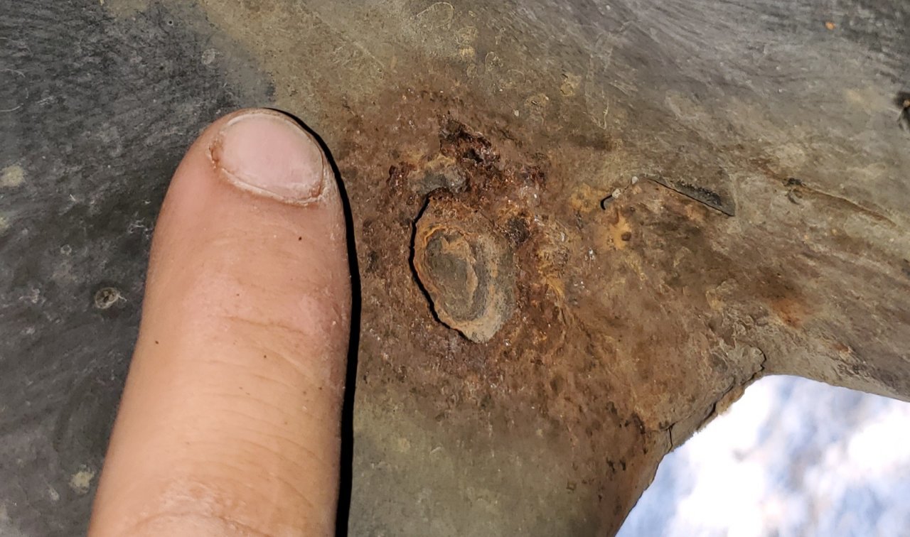

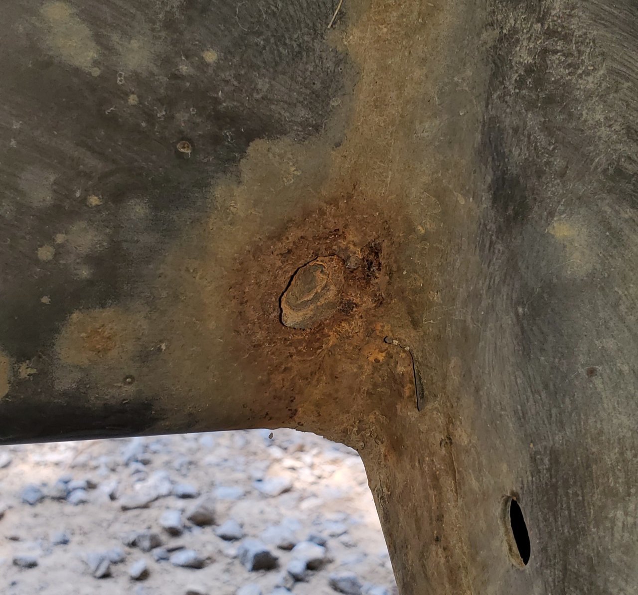

  7. Jun 20, 2020 at 9:15 AM
    #4027
    Tundra2
    Tundra2 Zoinked
    Feb 10, 2019
    #25875
    12,415
    Noah
    Western Kentucky
    Dirvers side front gas tank cross member.
    Drivers side frame by the static hanger for leaf.
    Thats... just horrible. Top of frame looks the same as what you can see in the pics.

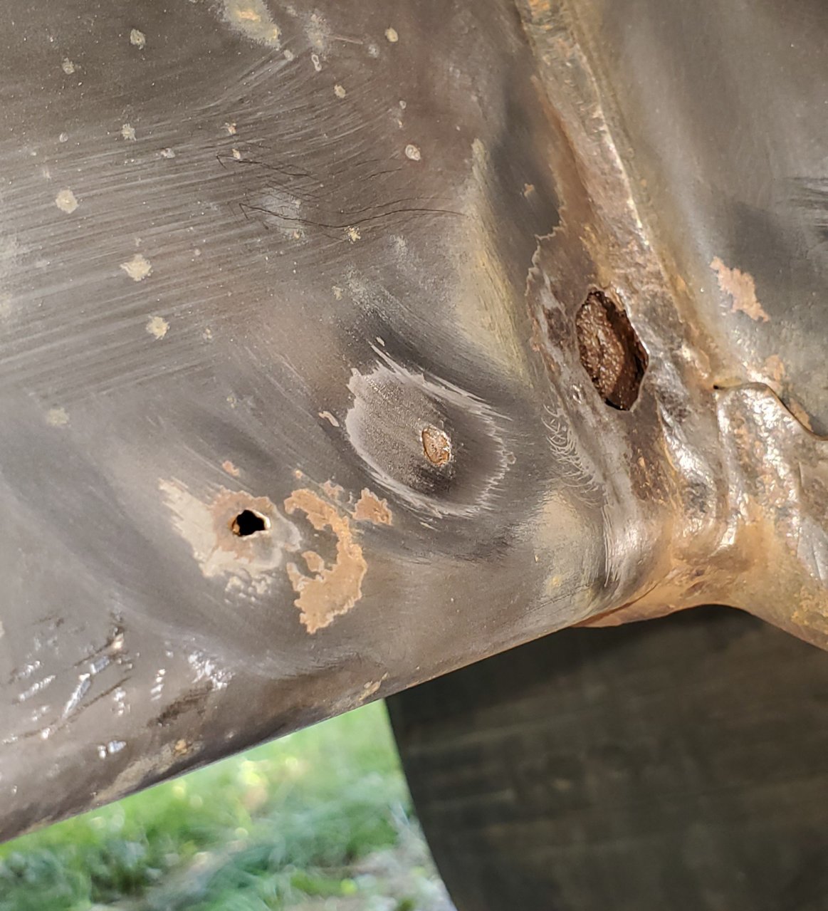

  8. Jun 20, 2020 at 9:35 AM
    #4028
    Tundra2
    Tundra2 Zoinked
    Feb 10, 2019
    #25875
    12,415
    Noah
    Western Kentucky
    Found a hole...
    Cross member for tail of transmission mount. I did not measure but if I had to guess its 8-10 mm wide.
    The middle of the truck appears to me to be worse than the rear.
    Maybe I should have inquired about frame recall, but thats okay that I did not. Live, and learn.
    Pinay likes this.

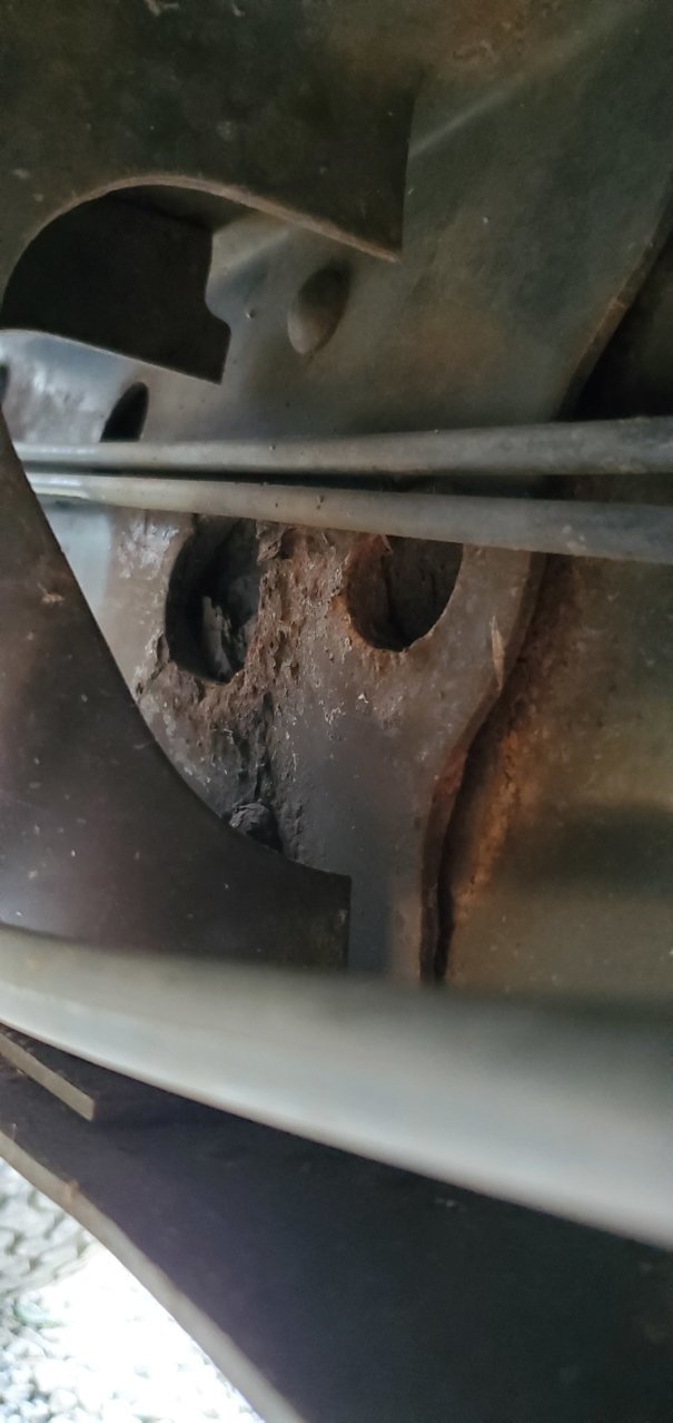

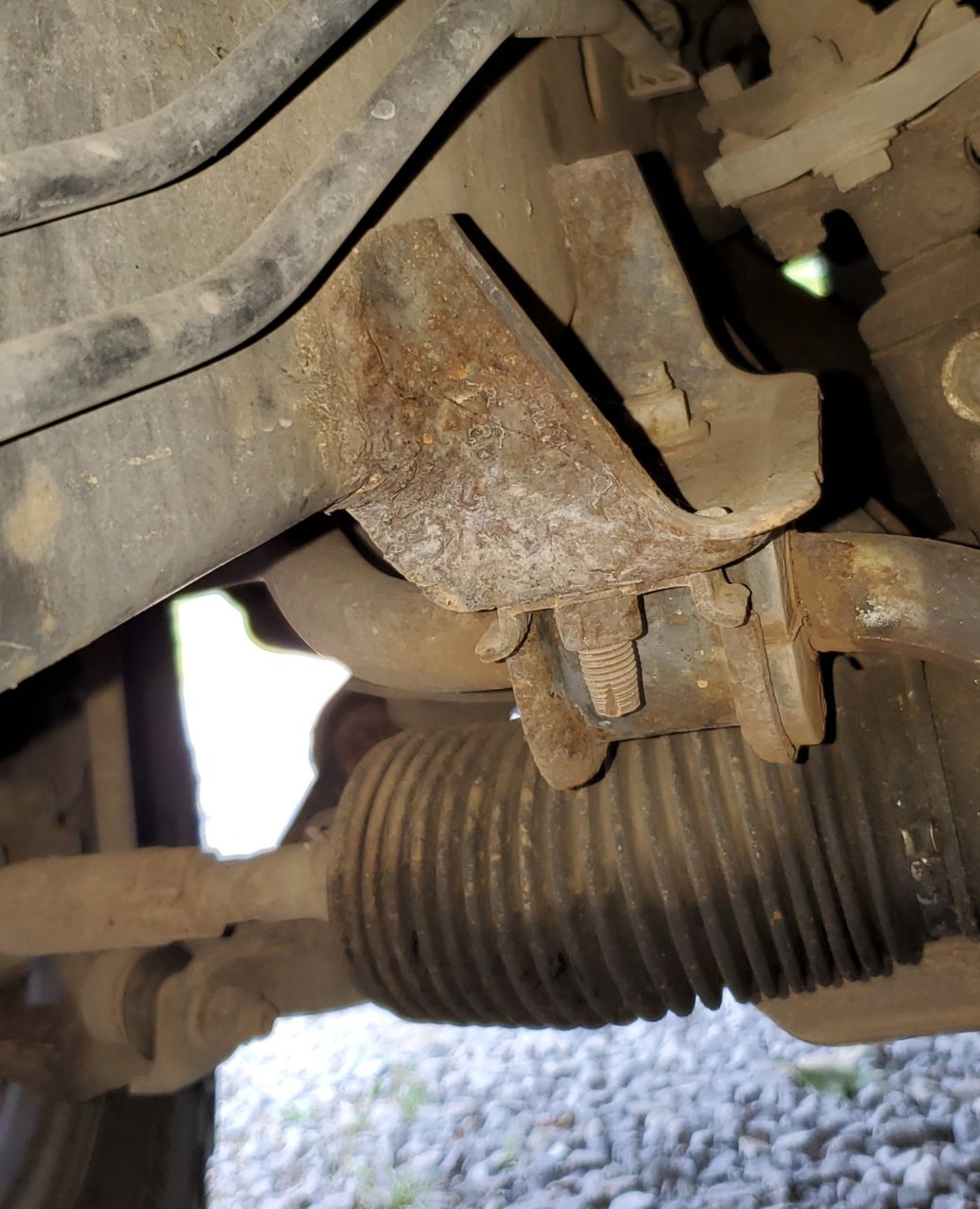

  9. Jun 20, 2020 at 9:37 AM
    #4029
    Tundra2
    Tundra2 Zoinked
    Feb 10, 2019
    #25875
    12,415
    Noah
    Western Kentucky
    Lots more crutiness than I was expecting.
    Drivers side front sway bar mount.
    Pinay likes this.

  12. Jun 20, 2020 at 10:10 AM
    #4032
    Tundra2
    Tundra2 Zoinked
    Feb 10, 2019
    #25875
    12,415
    Noah
    Western Kentucky
  13. Jun 20, 2020 at 10:13 AM
    #4033
    Tundra2
    Tundra2 Zoinked
    Feb 10, 2019
    #25875
    12,415
    Noah
    Western Kentucky
    Got a small turkey baster full of mineral spirits, and squirted it into frame hole to see if it was completely through or not.
    I watched the mineral spirits run out from the inside of the frame. :(

  15. Jun 20, 2020 at 10:15 AM
    #4035
    Tundra2
    Tundra2 Zoinked
    Feb 10, 2019
    #25875
    12,415
    Noah
    Western Kentucky
    I would gladly help you. Based on what you've seen do you think this one is worth saving? Based on your reccomendation I would say "no."
  16. Jun 20, 2020 at 10:28 AM
    #4036
    empty_lord
    Feb 1, 2019
    #25441
    10,125
    Dan
    Indiana, Chicagoland
    05 rollover special
    Honestly yours has life in it. Clean what you can and you’ll probably last a few years
    Tundra2[QUOTED] likes this.

  24. Jun 20, 2020 at 11:20 AM
    #4044
    empty_lord
    Feb 1, 2019
    #25441
    10,125
    Dan
    05 rollover special
    Eh. We do so many frame swaps here and have the tools, it’s usually only a 2 day project.
  25. Jun 20, 2020 at 11:23 AM
    #4045
    empty_lord
    Feb 1, 2019
    #25441
    10,125
    Dan
    05 rollover special
    Cut it out, weld in some plate. Paint outside and get Eastwood’s internal frame coating for the inside

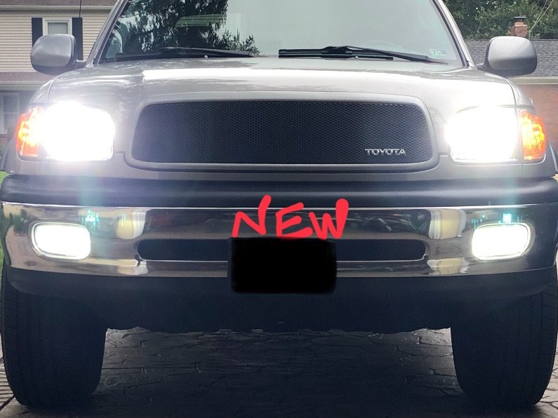

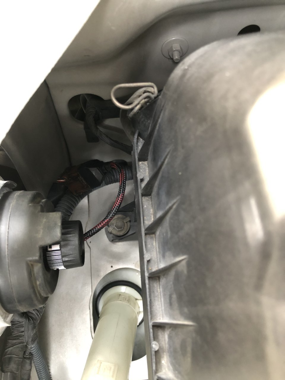

  26. Jun 20, 2020 at 11:44 AM
    #4046
    Professional Hand Model
    #14878
    14,993
    Fred
    Hand Protectors
    Hand Yoga’d the Katana II’s in place. I like the simple design with no external driver box. The new bulbs feel not as hot as the older solid body design when operating. The newer fins design works. Cooling Fans seem quieter, too.

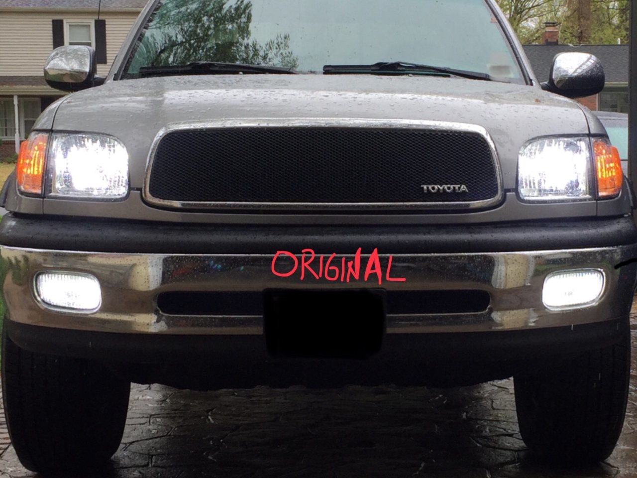

  28. Jun 20, 2020 at 12:24 PM
    #4048
    Tundra2
    Tundra2 Zoinked
    Feb 10, 2019
    #25875
    12,415
    Noah
    Western Kentucky
    Looks good, but I wonder if your cameras light exposure settings were different for new picture. The parking lights appear MUCH brighter to me in "new" picture.
    How was the "dim" bulb improved?
  29. Jun 20, 2020 at 12:27 PM
    #4049
    #14878
    14,993
    Fred
    Hand Protectors
    Yes, I think you are correct. This is a newer camera, as well. In person the new light output looks about the same as the old when they were new. I’ll do some driving tonight maybe to give it a test.
    bmf4069 and Tundra2[QUOTED] like this.
