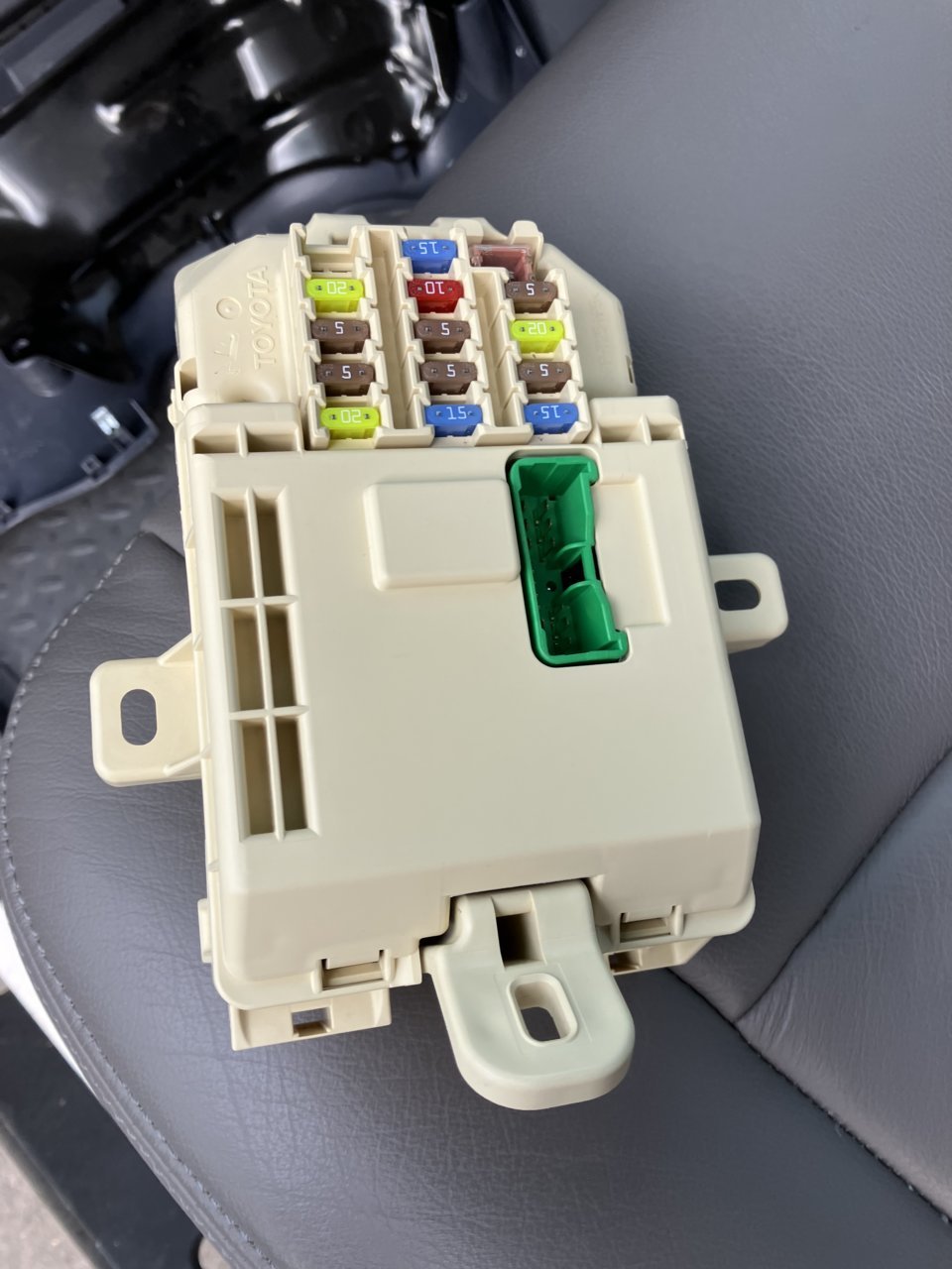

    Replaced the brains. So I can send you my broken one if you want to try to fix it? Or I can open it up and see. Or I can just buy you a new one?
    took me 2 hours to swap it out in the Costco parking lot.

    the integration relay?

    I think that’s what it’s called.

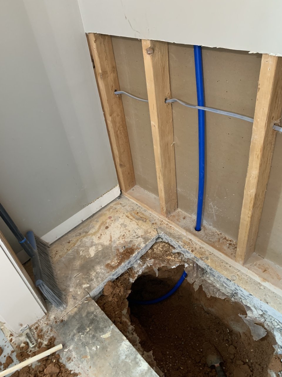

    Won't make it through the pipe curves, but good idea. I was thinking of anything that could be slid in, then "umbrella'd out" once inside, to pull back towards the toilet flange for retrieval, but the cap pictured was covering a 4" hole, chances of it getting stuck are high.
    Where the offending box is now, if we saw and jackhammer a 12"x24" hole in the foundation, it's about 10" thick in this spot, and will provide direct access. I have bare-floor access in the exact spot we need to cut, so no need to tear out flooring.
    We've already spent about 5 hours trying to find various ways to get it out, 4hrs with a snake before getting a camera and seeing what it was, then another hour after trying various ways to get at it. At this point, we know the box they installed is not only not-up-to-code, but it's going to cause other potential issues with flow, so spending an hour to jackhammer the foundation, 30 min to cut it out and splice in a new section, then 45 to backfill and re-pour ... makes more sense than me paying hourly on "could maybe work" solutions that are a way less invasive.
    Sometimes you gotta break eggs to make a cake. I personally don't want to take time trying to carefully peel the egg away from the shell, I'm ready for this work to be done :rofl:
    GC's brother is the plumber. They're apologetic, and it seems like they're going to show a little grace on the bill.

    We've only drilled the floor at this point checking for depth, we haven't jackhammered. If you have ideas before 10am Eastern tomorrow, feed them at me.
    The offending cap is under a basement foundation, halfway down a 6ft curvy run between our fully-installed toilet flange and a "T" to the main 4" drain line. Reality is, it's about 7-8ft in there, due to p-trap, bends and twists and turns. And there's no access available via the main 4" drain line because it has an unfortunate curve which makes it impossible to get in there. And it's lined with about 1/4" thick layer that is 20yrs of shit slather. The other side is totally clean.

    Do you have to mix the concrete different since it's foundation? I would assume a stronger mix then usual.

    It's a basement with concrete walls. The foundation itself isn't load-bearing toward the inside, the foundation is ~10" thick through the middle, and gets much thicker on the outer rim to support the concrete/rebar walls.
    Ballpark of what we're up against is this: The jackasses who built the house put in a weird, square, mystery 4-way PVC junction box a couple feet before the main 4" drain. Then they capped it, either on the line to the toilet or the line to the main. We knocked the cap loose, and it's impossible to get out.
    Lines aren't accurate, but pretty damn close. I think the shower actually comes in on the toilet side of the 4-way box.

    The cap shown in the picture was capping off one hole of the 4-way box and would need to be mutilated to be able to come back through the hole because the OD of the cap is larger than the ID of the 4-way box hole.
