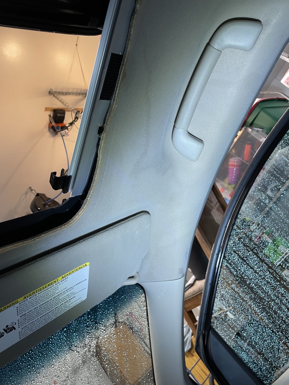

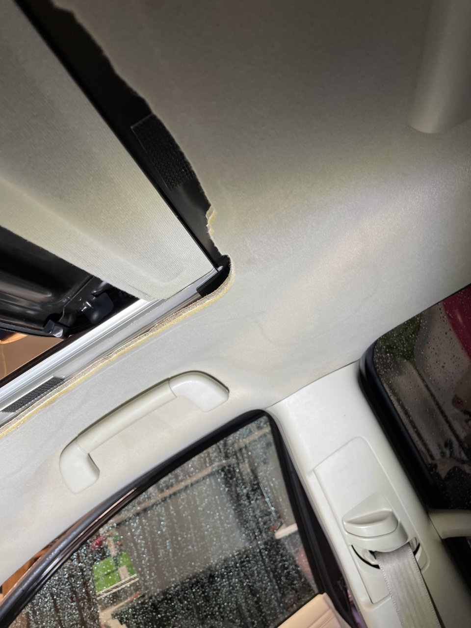

    Hey @empty_lord have you ever seen water leaking like this on a sienna? Went outside to pull it in the garage for a tire change, and there was water filling out my cupholders. The windshield looks like it may have been replaced previously, and in the middle the weatherstripping is pushed in too far maybe? But then it’s leaking around the sunroof yet the sunroof appears dry. I also don’t have the roof drain drip rubber pieces installed right now but I don’t think that would make a difference or cause this.

    That looks like clogged sun roof drains

    Ok I’ll check where those are. Thanks. Ruining my family road trip to Canada right now :/

    Open sunroof fully. Look in the lowest corners for the drain hole, not speaking to this truck specifically, but in most vehicles you'll see it at the end of a valley or at the lowest point. When you locate the hole, don't use pressurized air. Instead, get something soft, long, and plastic like weedeater string, and run it down the holes to slowly work through them, clear 'em out. Then carefully rinse with clean water. You can also do the inverse - start from where the drain exits, and work your way back up - if it's really impacted, this is a good option. Don't use anything stiff, metal.
    If you need an instant fix and don't have time to find them, or just want to prove it's the sunroof drain, get clear packing tape. Tape the sunroof shut, so no water can enter the seam between the glass and sheetmetal. If water is still enters after that, sunroof isn't your issue, so consider taping the roof-to-windshield seam as another suspect, roof rail is the only other place but those covers are glued in, so replacing isn't 1-2-3 easy.
    Where I'm seeing the water though, the sunroof makes the most logical sense.

    Well, I threw some string trimmer string down the drain tubes and didn't really feel much resistance but followed by water and then repeated this. HOPING it fixes it and that the water didn't ruin my HVAC controls as that's where the water was dripping inside. I'd hate to get 200+ miles away from home and not be able to get any heat in the van. I left the van outside and will check in a few hours...time will tell.

    When you ran water through, that should've exposed where the drain is. On DC, I think it goes down the b-pillar and exits maybe near the door sill? You'll know based on where water is.
    Reason I say it is, check the water that ran out, to see if there's debris in it. It really doesn't take much to clog a drain enough that it backs up into your interior. A run of the mill funnel spider web is plenty enough to do it, it doesn't take a mason bee or leafcutter bee clogging it with mud.
    Be sure you clear the channel that funnels down to the drain really well also. And don't forget, clear packing tape is your friend for troubleshooting. Not only is it invisible from 2-3ft, but you can tape over entire seams to isolate areas you think it may be.

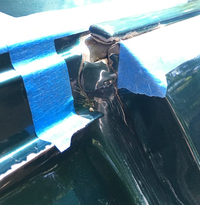

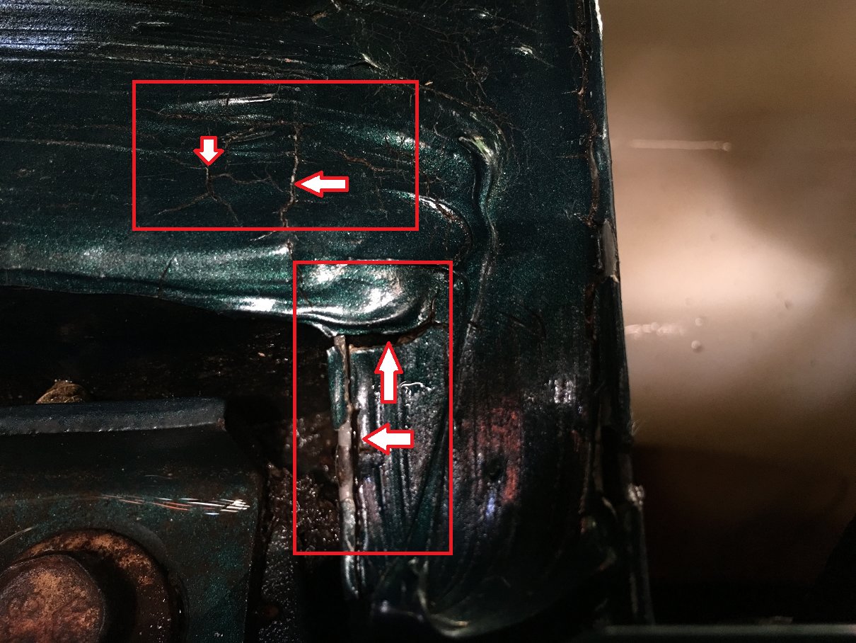

    PS - You know what seam sealer is, right? Basically where two metal sheets come together, manuf'ers will use almost like hard automotive caulk to seal the joint.
    Seam sealer has a penchant for cracking in some places. This can be problematic at, say, where the corners of the sunroof come together if it's not a stamped-round sheet that makes up the roof.
    For example, I had a really pesky leak coming in at my windshield, dripping from the visor. The problem was a crack in seam sealer where the B-pillar meets the roof line at the top corner of the door, here:
    This is a 90s GM truck, there was no shortage of shitshow with the seam sealer. Just look at this section where the cowl met the hinge, note that gaping lower upside-down L-shaped crack, and all the fine line cracks in the upper left box, such a damn joke!:

    I think it may still apply, I guess I wasn't clear on that. Sienna has a sliding door, and the sunroof is windshield-forward, so there's no other place for it to drain except either the B-pillar or A-pillar, I doubt they'd run the drains to the back. Usually it'll drain towards the pillar that's nearest to the corner the drain is in, or the one that's sloped the most. I remember an old SUV (maybe a Touareg?) that ran it all the way to the rear corner pillar of the vehicle.
    I think in the DC, it drains down the B-pillar, and probably either out up under the cab, or into the side of the door pillar itself. In other vehicles where the hood is sloped more to the front, it sometimes drains down the A-pillar and dribbles out by the wheel. The Sienna roofline geometry isn't something in my brain, so I'd shoot first for hunting out the other end at the base of the B-pillar or B-pillar door jambs. If not there, maybe check A-pillar.

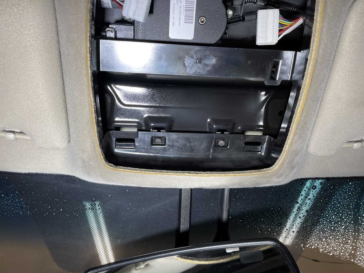

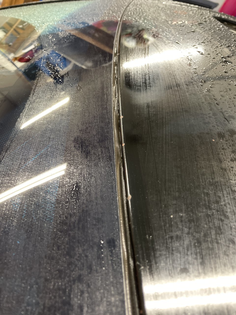

    Thanks for the tips guys. Still can’t find the leak and yes the rear of the front sunroof drains run to at least the rear of the sliding doors if not the rear wheels. Gonna have to take the van in and have it checked cause I don’t know what else to do. Can’t really pinpoint a spot that it’s leaking from.

    The window definitely looks suspect. But the water near the grab handles couldn’t come from it. Typically those hoses partially clog, during heavy rain they’ll get over tan by water and start spilling over the drip tray
    This is why I rather not have sunroofs lol
