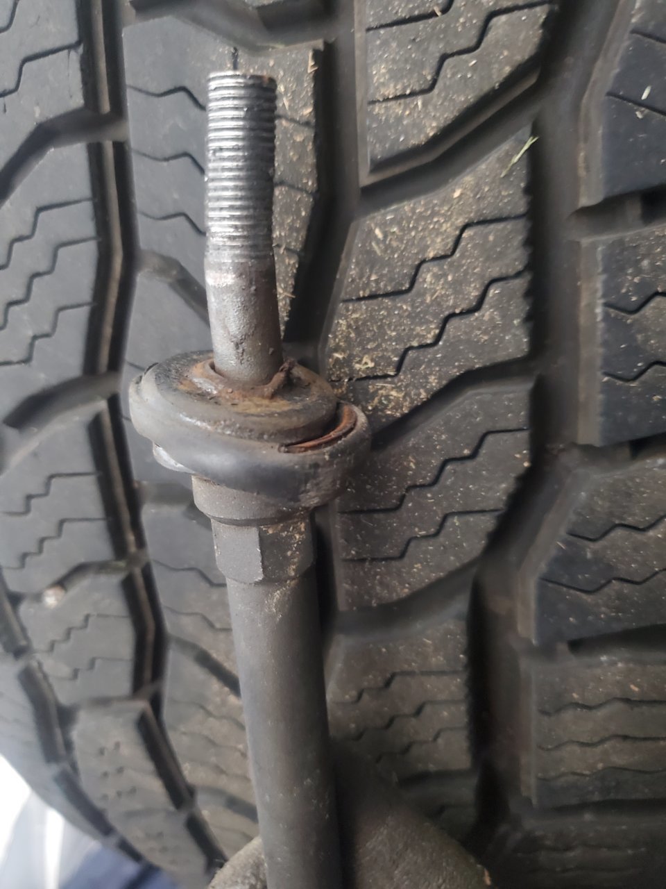

    They don't have any play but a few of the bolts were a little loose so I snugged them up. They were from A1 Auto and I'm starting to think they are the cause @Festerw had the same suggestion.
    I also never replaced the sway bar bushings where they mount to the frame. I should probably just order new OEM parts.

    Those control arm bushings are pretty toast. Probably the source of the noise.

    Honestly those bushings are worn. But doubt that’s the noise.

    After tightening the bolts for the sway bar links the noise seems to have stopped. It has 141k miles. My plan was to rebuild the rest of the suspension at 200k miles but that might be pushing it.

    I look at too many cars. I was thinking of CRV's that have those style bushings blow out all the time.
    Cool, glad it was an easy fix.
    Unlike your brakes.
    But expect to replace those relatively soon'ish. I'd shoot for 150k.

    Mine started popping after about 3000 miles on them (moog). After getting back home from our cross country trip I got the extended links from @5N0W808 and replaced them. Was getting a harsh pop noise and one link was bent pretty good.
