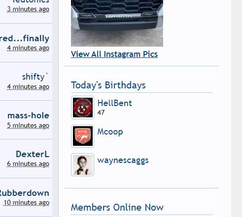

  5. Aug 15, 2022 at 10:59 AM

    How do you see birthdays?

    Home page. Right-hand side.

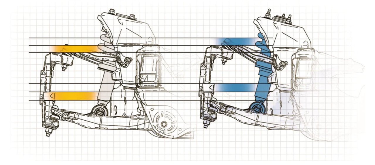

    Keep in mind with a spacer you are gaining height at the sacrifice of droop. You're making a fixed part of the shock longer, but not changing the moving parts to compensate. Your shocks will ultimately become your bump stop if you hit a big enough bump, as your suspension can't articulate properly to the point where your LCAs are striking the bumpstops like they should

    Glad someone else chimed in. I had to actually see this drawn out to fully grasp it. (spacer setup on left, obviously)
    So with the tower being physically welded to the frame, tossing the spacer in the mix - at least at a 2.5" size - actually forces the strut further into into the LCA which has a side effect of camber+ while also adding more strain on both arms and/or the bottom inch or three of shock?
    I've seen dudes on here running spacers up to an inch, the effect was so little, an alignment wasn't required after. Is it just a matter of the spacer height, in this case, that would cause all the beef?
