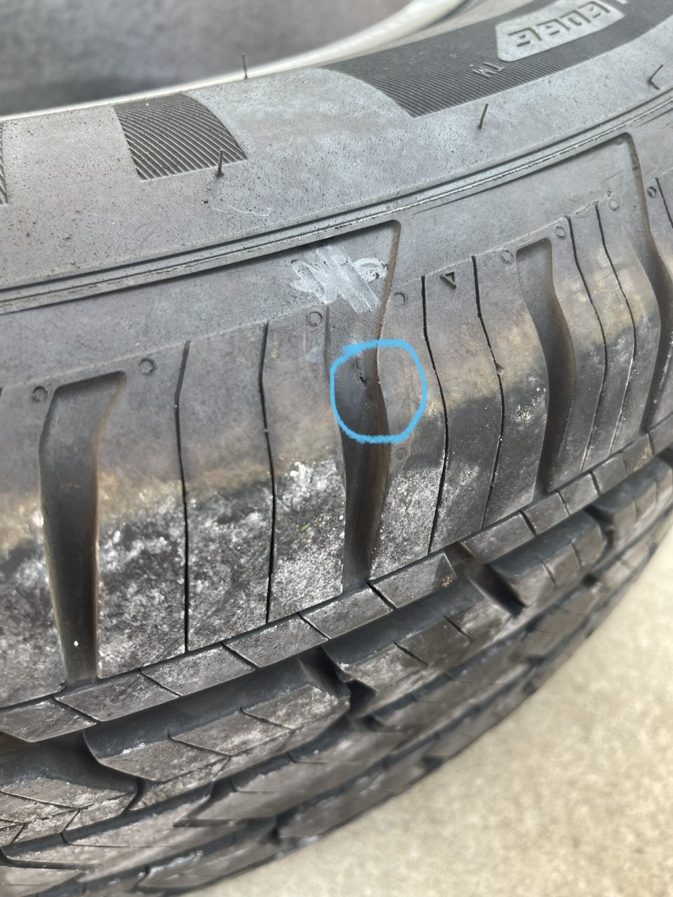

    caught a staple in the corner. Its a 2 day leak, too small to be worth reaming and plugging (yet). Glue in a brad nail? Glue & a screw? Just glue?
    i know, you cant fix a sidewall, and my puppy and i are willing to accept the risk.

    Safety Seal has 1/8" plugs, I'm a mad man so I'd plug it and run it on the back.

    Are you sure a shop won't do an inside patch on that?

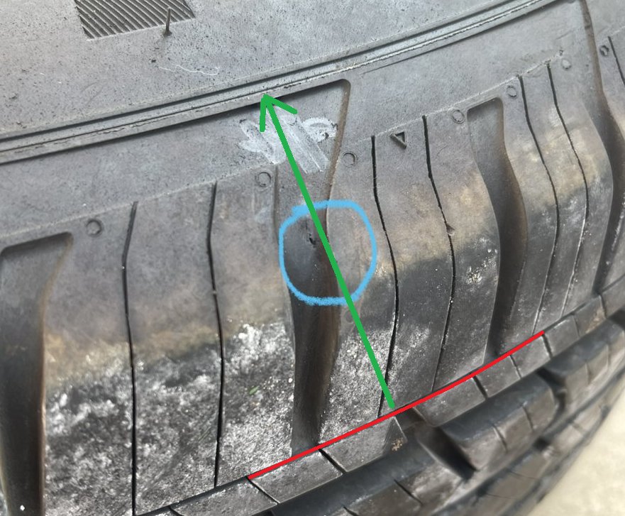

    For liability, most shops won't patch anything that's less than 1" from the tread strip.
    Something like that in the top corner of the sidewall, or anywhere in the sidewall, is a big no-no for liability reasons. Risk of blowout is way higher.

    Basically anywhere from the red line outward is ballpark in the "no no zone". Some places may get a quarter or half inch closer.

    Rubber cement and a fat shank screw worked like a champ. No bubbles, holding air. If its still in after a run up to 100, i'll consider it properly band-aided.
