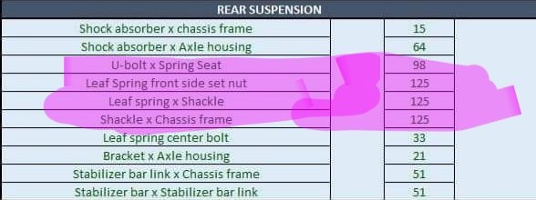

    Let me verify I read everything correctly on the info dump page. 20200613_180942.jpg
    Everything is 125 ft. Lbs, except for the axle braket/ U-bolt.

    The reason I was asking, and verifing is because my torque wrench clicked at 64 when I verified it worked on the axle shock mount.
    Didn't click at 125.
    Excercised it up incrementally to 125.
    All good now.
