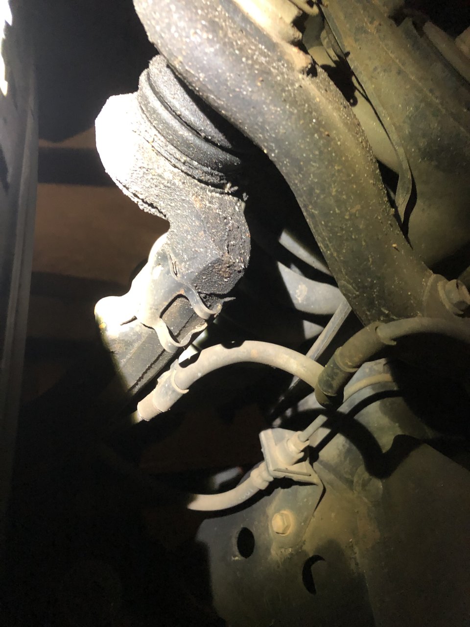

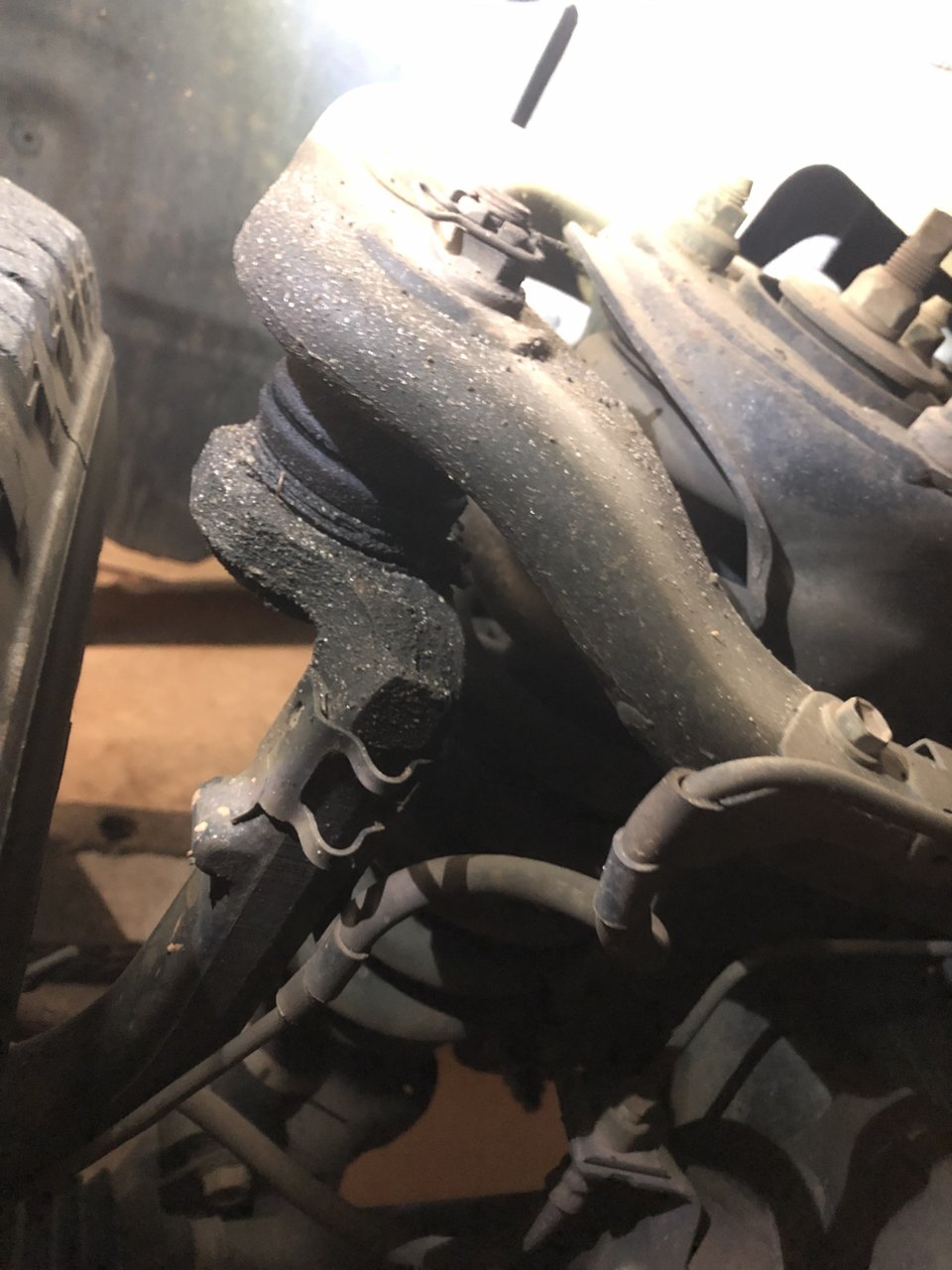

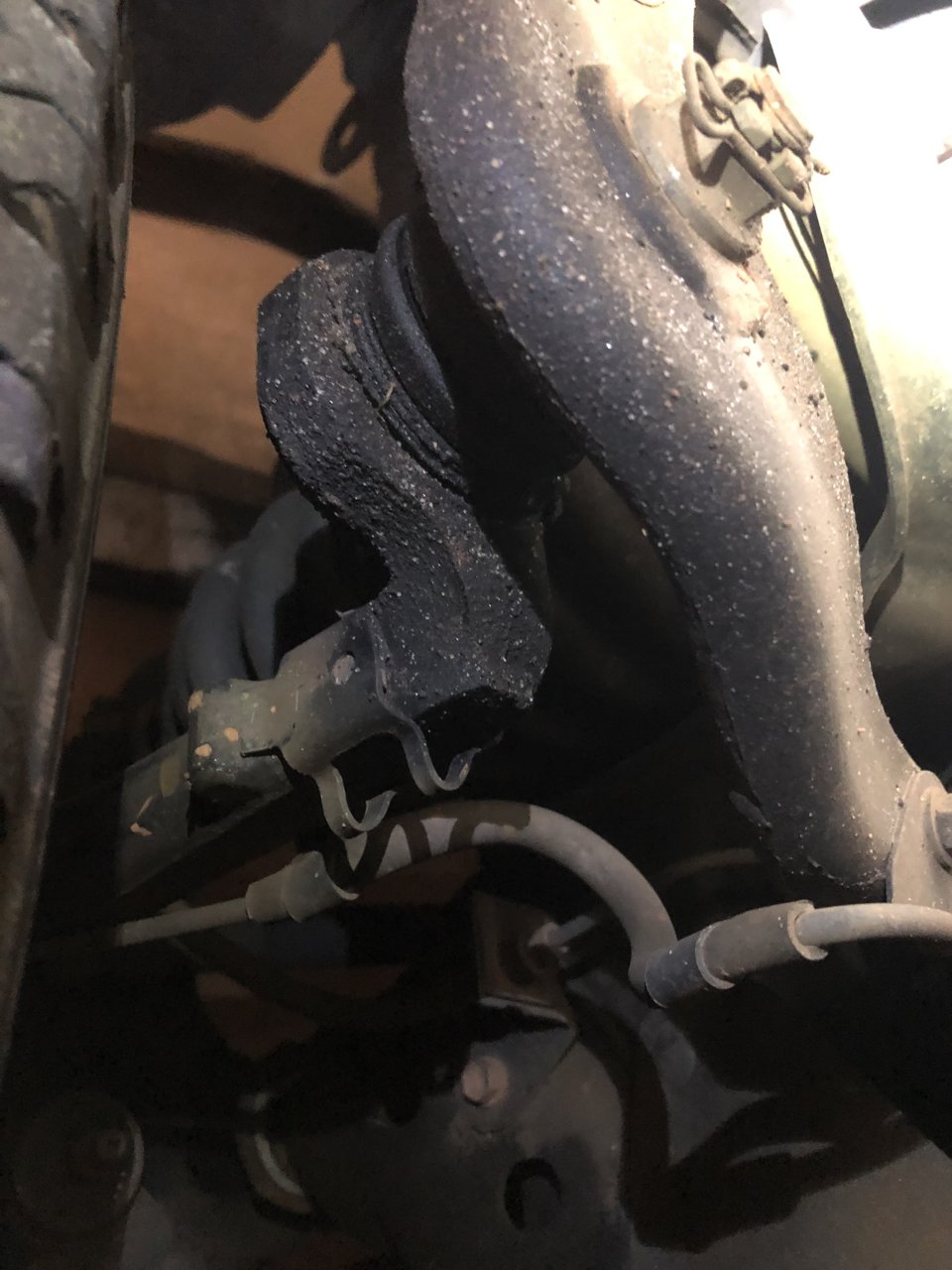

    Well looks like my shits good and broke. Not sure how serious it is to keep driving but starting to look like I need new spindles on both sides, a different coil over setup, and new UCA's. Great. Just when I though the truck was "done" enough for my needs.
    Way she goes I guess.
    Anyone know if 1st gen sequoia spindles (which I assume are the same as double cab) are the same? There's one of those at a local junkyard.

    I'm pretty sure you got time. Space up your rear bump stops for now. They make contact before the fronts. Work it out and I would argue you don't have an emergency, just a need.

    but why did it bend?

    Ran out of travel before the LCAs made full stop is my opinion.

    My experience is that you are both right. Tuning and everything that goes with it prevents hard contact. But when you completely max out - you want that contact to be the LCAs and the bump stops.

    Yeah I know I used the bump stops a few times on our road trip. Once or twice pretty hard. If I did stuff like I did on our trip on a regular basis I'd make a lot of upgrades. I'll space up those rear stops. I'm not planning on doing anything wild for now.
    I just need someone to confirm if sequoias/double cabs/access cabs have the same spindle and I'll have to get a set.

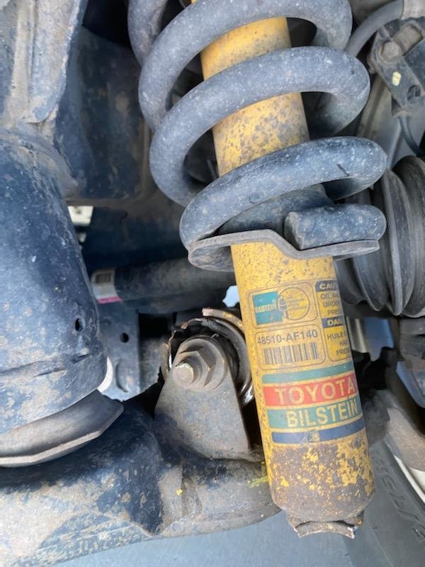

    So about 2 weeks ago my buddy asks why his tundra is squeaking. I take a quick peek underneath and see his shock bushings are nearly non existent. I tell him he needs new shocks IMMEDIATELY. Fast forward 1 week and he goes over a set of train tracks and this happens:

    Reading some threads it seems like the shocks on stilts are folding over because of spacer lifts.
    So those taco boys aren’t landing on their bumpstops.

    Apparently on our road trip. I posted pictures further up. I guess the bump stop spacers I put in that came with the 5100's didn't bring them up enough.
    Well when I was at the junkyard looking around at inventory they had a sequoia there but I didn't look at the year because I didn't realize my truck was messed up yet. Come to think of it though it had the later (I believe 05-06) cluster in it so it probably won't work anyway.
