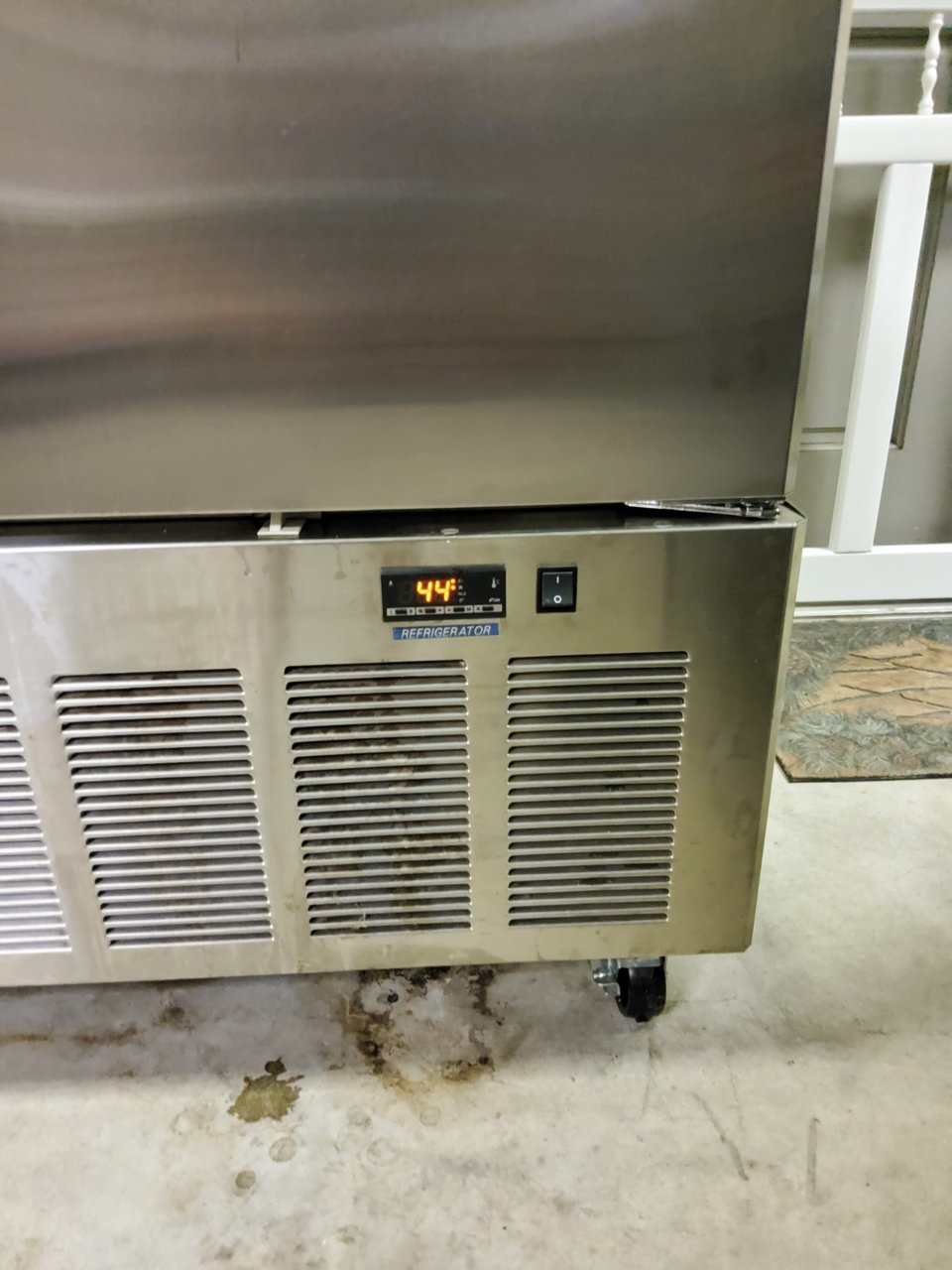

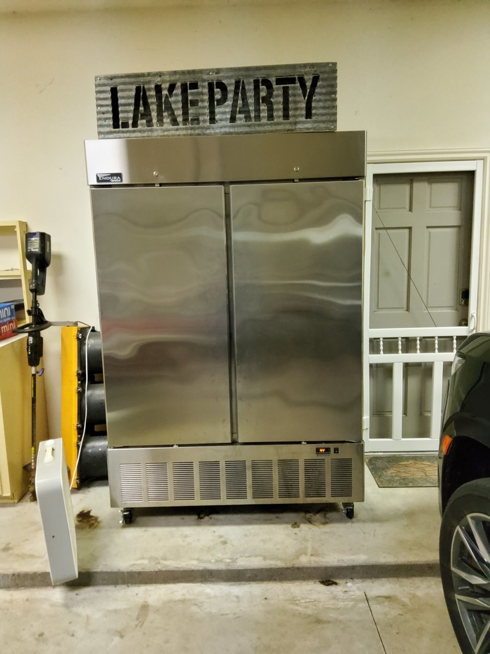

    @FrenchToasty my uncle says his garage fridge isn't cooling right. With no tools what can I check and maybe fix it?

    44 is definitely no bueno!
    Does he have cats? Does he have a air compressor? The bottom grill should open or maybe you can look from behind and see if the condenser is clogged with a bunch of cat hair or whatever else. You can blow it out gently to free some air flow.
    Next check inside the cabinet and see what temp it’s set at, if it’s maxed out, the coil might be frozen because the door got left open. Or look at the inside coil if it’s frozen, needs to be thawed out over night if it is and then let it run

    0 cats out here. I will see if I can round up a screwdriver and pull the cover. I was guessing clogged coils from the get go.

    Check the inside coils by opening the doors and holding the door switch, make sure there is air flow or the coils inside are clear too.

    The closed coolant systems on refrigerators are sealed tight, so coolant system failure/depletion almost never happens. Wild majority of the time mine or a friend's fridge died over my decades on the planet, it was one of the following conditions:
    Insufficient cooling, cold but not cold enough: Something clogged with dust, filter or coils. Evap/blower/fan motor or bearing is dying and can't spin at necessary RPM to circulate air. Someone dicked with the knobs/buttons. Door wasn't sealing or left cracked and froze unit up. When we remodeled in 2009, our cabinet installer didn't allow for sufficient airflow around our fridge and it wasn't getting enough ventilation.
    Zero cooling, fridge at room temp: Compressor relay shot ($10-30), compressor is clicking but never turns on. Evap/blower/fan motor fail ($30-50), blower fan isn't turning on, so no cool air gets circulated.
    I'd pop off any vent panels and vacuum or rinse front and rear to start. You'll know right away if that's the issue. If no joy, If you'll grab the model number from the sticker inside the unit, I can grab an exploded diagram for it so you'll know where to look for the fan(s).

    Door fan switches can be pesky and cause the inside fan not to come on and freeze the coil

    Sometimes the coils/internal drain freezes solid and it shuts down. The fix is usually to unplug it a wait a couple of days until it all melts.
