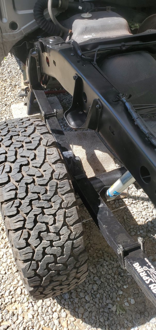

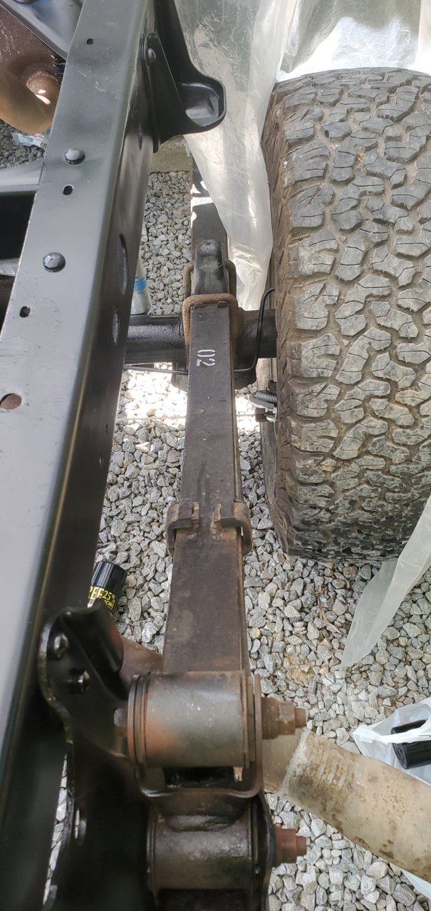

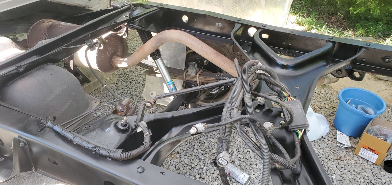

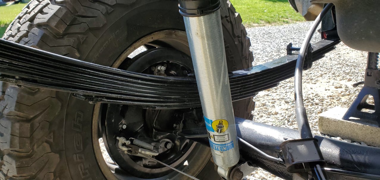

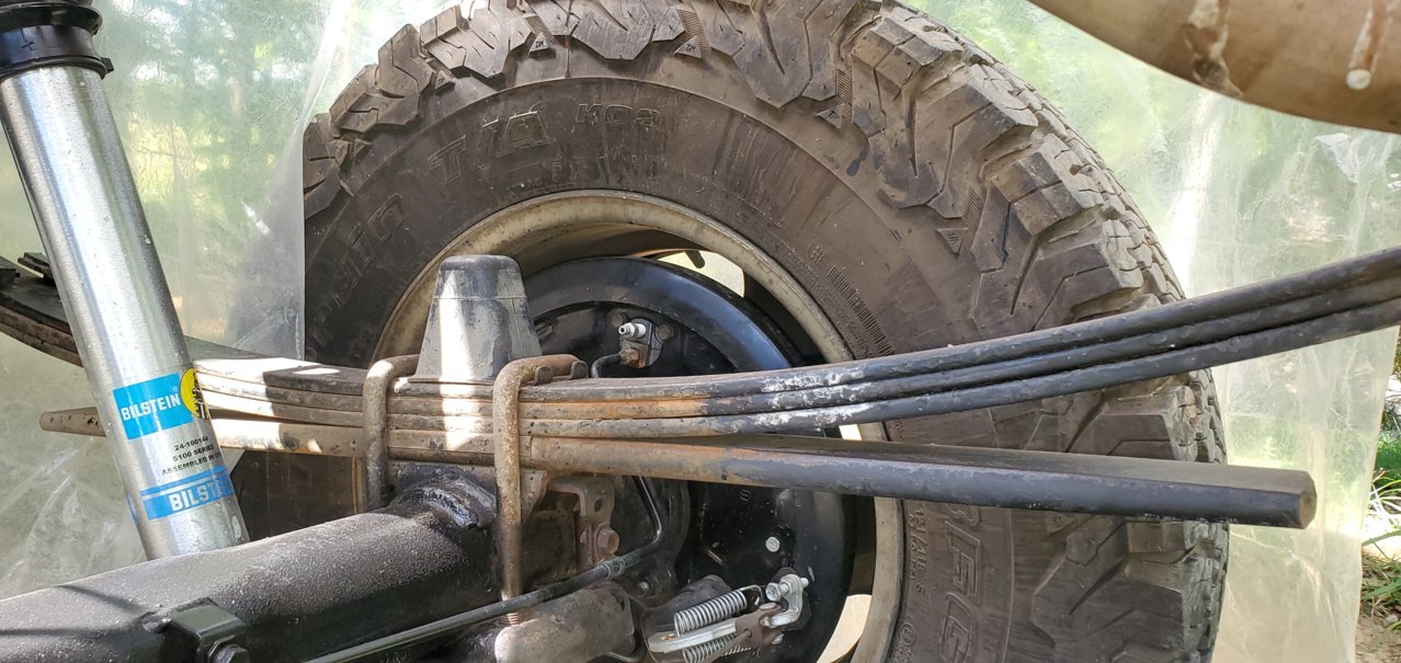

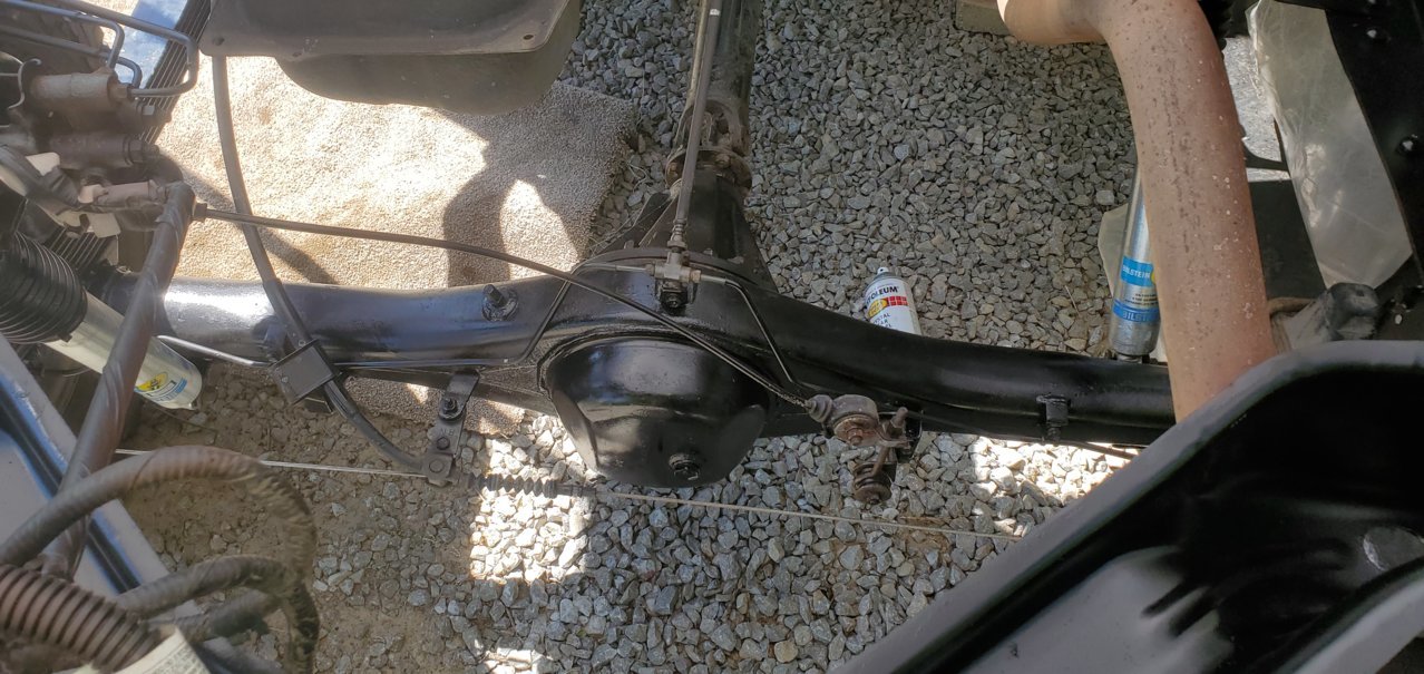

    Went ahead, and order another smaller can of POR. bummer.
    Also, went ahead and painted the rear with what I had. Wind was WHIPPING today.
    1 Coat of primer.
    2 coats of Black semi-gloss enamel
    2 coats of High gloss crystal clear enamel.
    Do I even need the POR now? Lol hell this be looking good. With a grease rub, and pb blast it should last, eh?
    Also, set the drivers side leaf in place.

    Looks good! That frame will last long time. Not sure if you’ll even need a grease rub. Only reason I greased mine was it was easier than painting. Grease won’t hurt, but you look good to go.

    Thank you. It means A LOT coming from the role model. I'm going to grease anyway because uts not going to hurt.
    I noticed after I sprayed PB on bolts and then pressure washed remaining dirt 2-3 days ago that water beaded up, and ran off the frame. CHOICE product.
    Some pb had splattered onto frame.

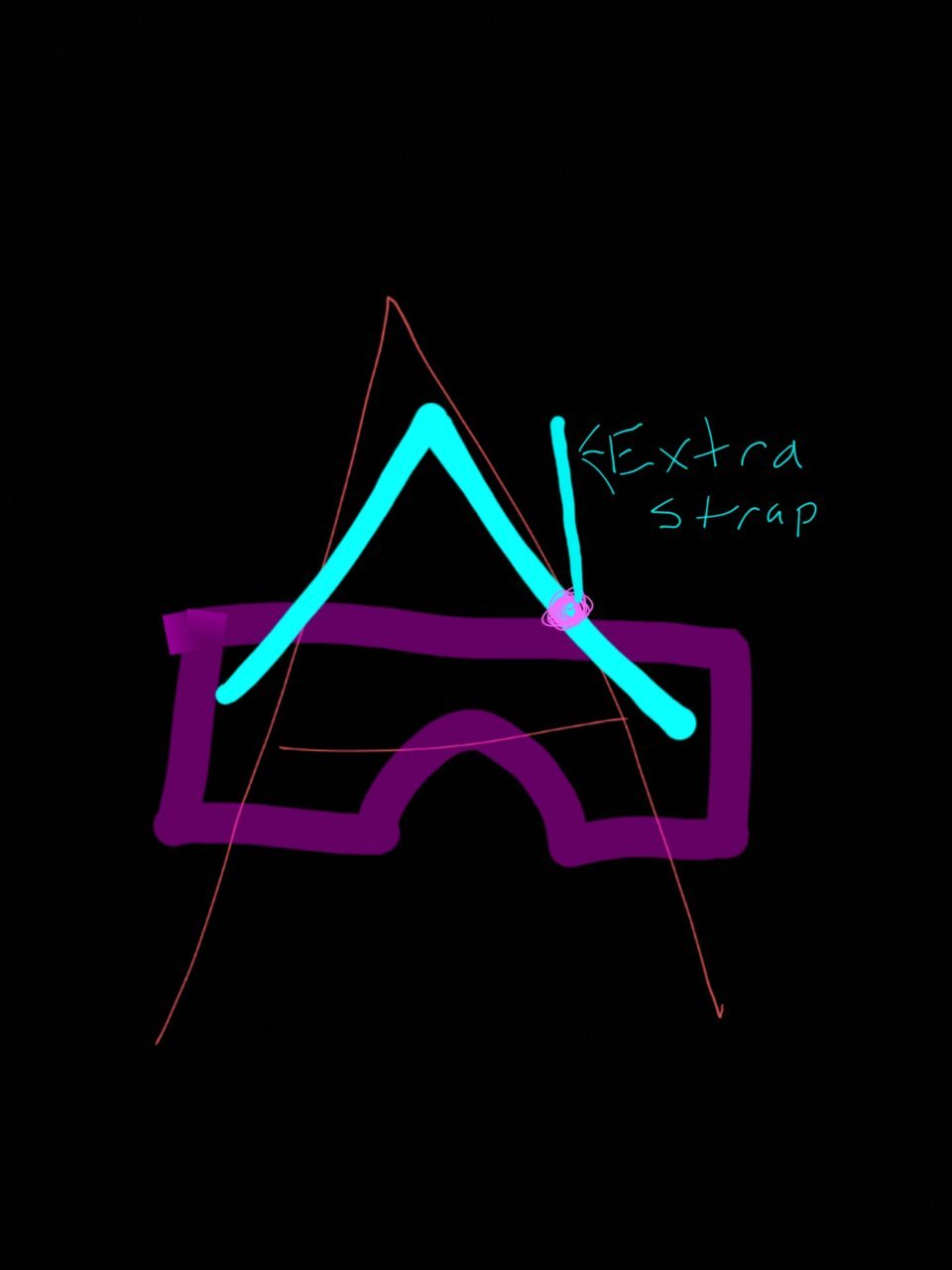

    I was scared too, and honestly wasn't sure if bed removal was the best course of action. After seeing all the rust on my frame come to light, and then disappear...
    I think it was well worth it. Under the cab should prove to be the hardest part of the whole frame job I'm doing.
    For your bed removal I recommend the A-frame method if you are by yourself, or so you can save yourself the back pain.
    NEW ratchet straps will hold.
    I
    WOULD NOT use old ones for that job if you go that route.
    Using the A-frame method you can also use 2X6 boards laid across the horizontal part of A-frame, and then lower the bed down. Taking the strain off the Chinese sewing job. It is kinda tricky, and scary lowering bed with ratchet straps, but doable. I lived, and learned. Scratched up my bed here or there. Transferring Red oil-base paint to my bed.
    If it helps you visualize the best way to lower I can draw a picture for you IF you go that route.
  25. Jun 12, 2020 at 7:18 PM
    #3355
    Tundra2
    Tundra2 Zoinked
    Feb 10, 2019
    #25875
    12,415
    Noah
    Western Kentucky
    @Professional Hand Model.
    Heres what I did. If I did it again I would use 2 people for level, easy glide down to bottom
    Red is A-frame.
    Puple is Bed. (Obviously. Lol)
    Blue is ratchet strap with extra long strap.
    Pink dot is the ratchet itself.
    How I lowered bed was grabbing the extra strap, and pulling it tight against ratchet.
    Release the ratchet, and you have reduced amount of bed weight due to mechanical advantage of the ratchet acting as a pulley of sorts. I was able to hold the bed up like this with one arm, and lower it with both arms.
    If I had went slower I could have lowered, and then engaged ratchet to hold weight. Go to the other side, and repeat. I was figuring it out as I went. Hopefully you can save more of your paint than I could
    If you use this method.
