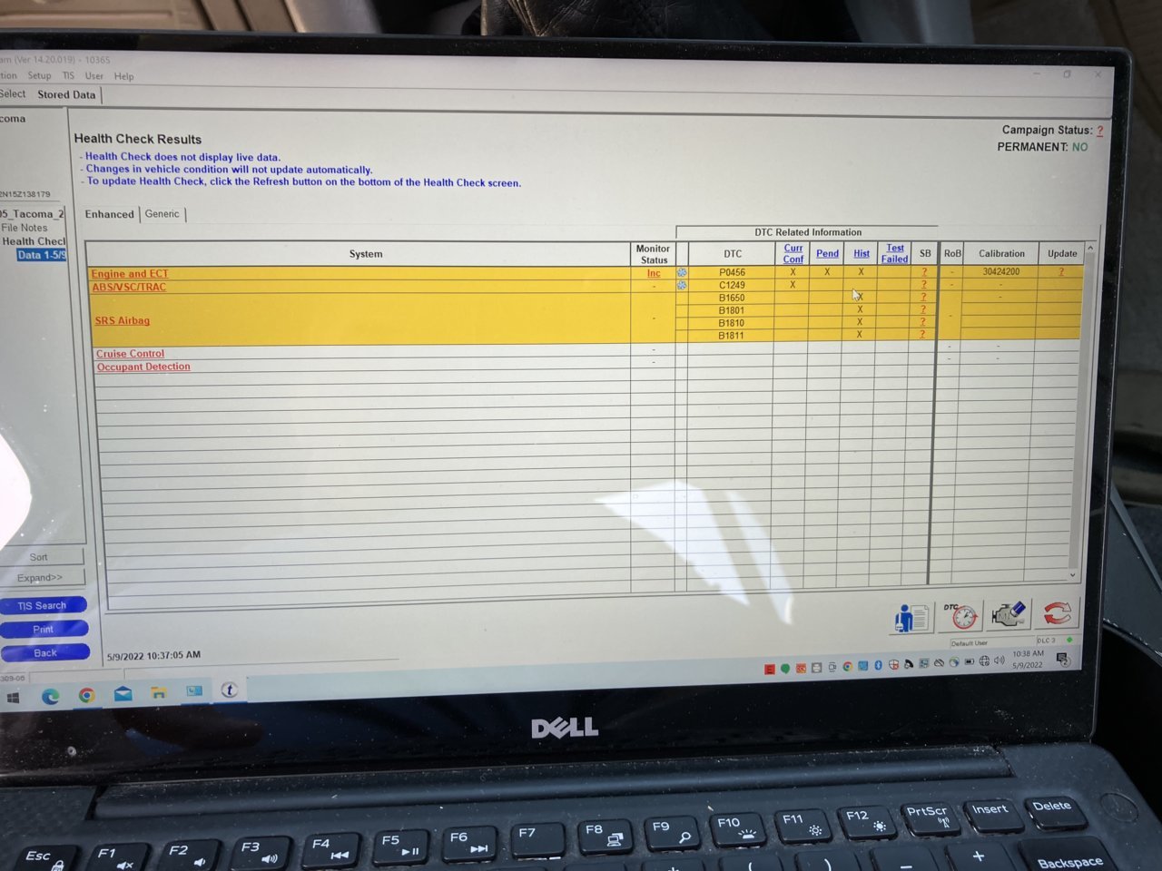

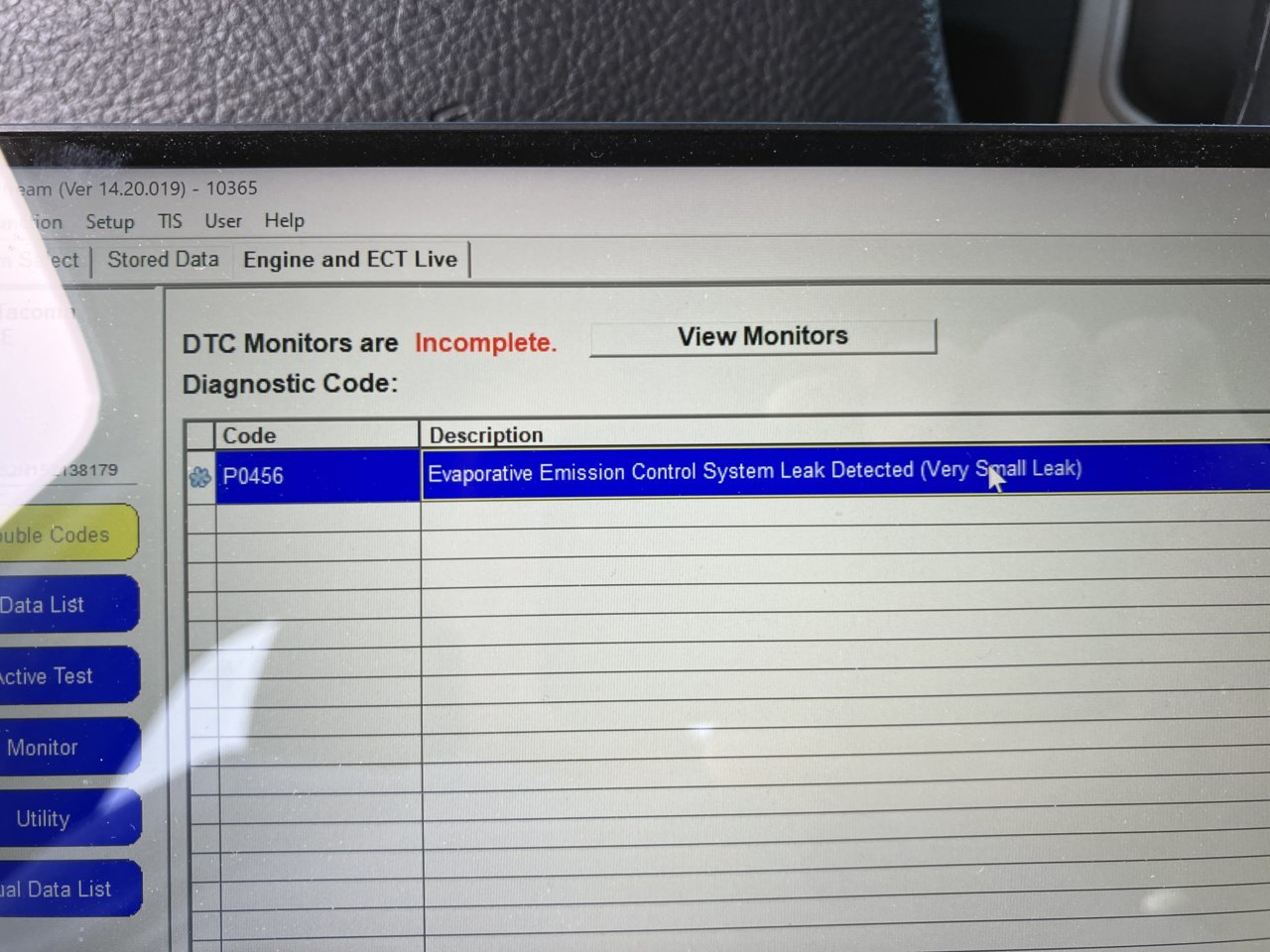

    David
    I grew up with 5 speed and R where 6 is on the Tacoma. I like it there for street use. I would say 5 is perfect for basic driving while 6 is nice for road trips.

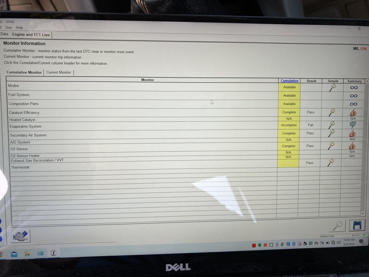

    Pretty sure the 5 is the pick for EV conversion. But crossing my fingers I can get this P0456 code dealt with so I can pass smog and get it registered.

    You already making headway on that?
    I feel like telling you "save yourself a headache and get it smoke tested" but ...

    Yeah, the general plan is let someone deal with it. We'll see how the appointment goes.

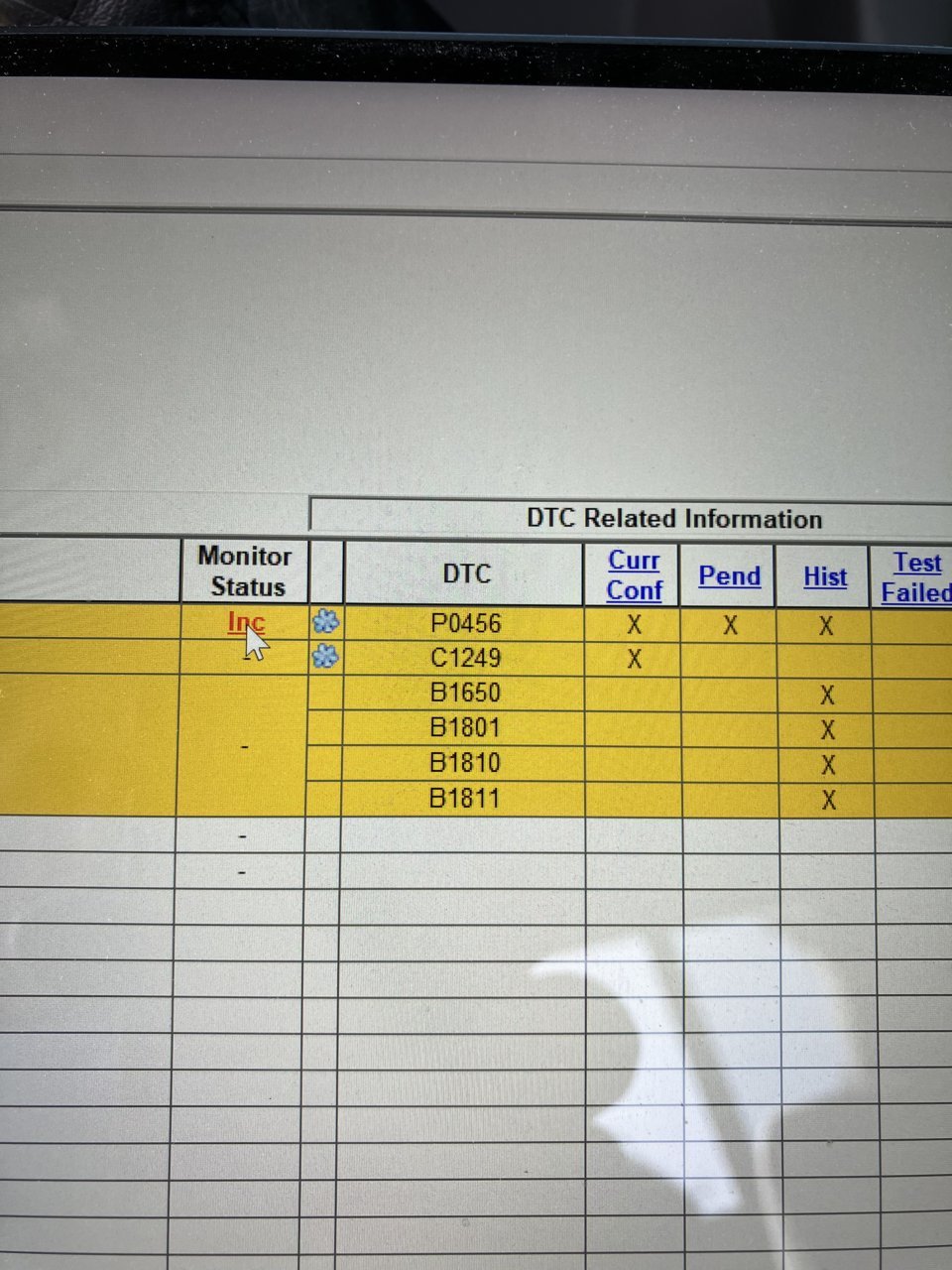

    The small leak (vs. large leak) codes are the worst. You never know .... is it just the fuel tank pressure sensor that's bad, is the carcoal canister cracked, is the gas cap old/bad and not sealing? Maybe one of the purge/solenoids is sticking slightly open? Tank cracked? Hose has a pinhole or crack? Sometimes trying to find a mechanic who ever understands how EVAP systems work is tough, and smoke testing is tedious and one of those things, "Do I buy this test kit I'll never use again?!", but you can easily rack up hours in a shop having them figure it out.
    EVAP is a sealed system that's supposed to maintain a steady pressure. Not only do you need to hold a specific pressure, but the sensors need to be working to correctly detect the pressure, and the solenoids need to be able to be airtight and trigger to hold/purge pressure, and the mechanical pressure bits like the gas cap can't be allowing leaks either... If you haven't started with the gas cap, I'd give that a go before running it to the shop, but that's just me.

    I did an aftermarket gas cap yesterday but it didn’t automatically fix it. I assume some sort of reset procedure. I have an oem one on order too.
    I am beyond my depth on this and the clock is ticking I believe as I need smog to get it registered and that has to happen within 30 days I believe.
    Also planning some bailout options but hoping I don’t have to get too deep on those.

    On most vehicles, unless you have a tool to trigger the test, yes, it normally takes a process of varying speeds, RPM, stopping and going, and mileage to complete a test cycle. It normally doesn't automagically fix itself. Someone here may be able to tell you how to trigger an EVAP test, maybe there's a diag reader (even a bluetooth OBDII module) that will support triggering it? On all of my GM vehicles I had prior, the Tech2 tool made it an easy process to be done in less than 5 minutes.

    I connected with techstream yesterday but felt that I was better off letting the dealer do the clicking given my lack of experience. I figured the $15 gas cap might save me from dealer pricing on that item and maybe I get lucky. But I could also, as you say, get unlucky.
    The plan is for this to be the EV conversion. I believe I need to get it titled and registered first. So I just need to get through that part and from there it could take as long as it takes to do the build. I have adequate tow vehicles for transporting it legally.

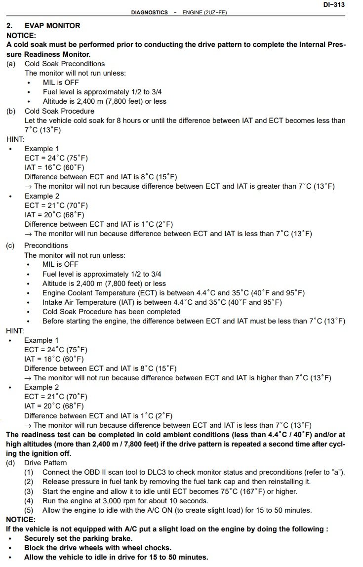

    There’s a TSB for running those test. I believe they’re always running, you just have to meet the criteria of the test to pass. The gas cap thing is an overnight test I believe with some pre-qualifiers.
    I know I posted them on TS years back.

    It can be in same day IF....
    ECT/IAT have to be below 95 and the difference between ECT and IAT must be less than 7°C (13°F). For me, EVAP has always been the last to complete and the most stubborn one. I have a route I take that will pass all monitors except EVAP but after letting it reach the cold soak temps and release gas cap pressure, I can usually pass EVAP on the next drive cycle. For me it's always next morning due to not in rush.
    The MIL will also have to be off, which means code has to be cleared.
    Have attached some Readiness Monitors from FSM's,TSB's and what not I have picked up over time. Procedures are pretty much same for all 1st Gens.
