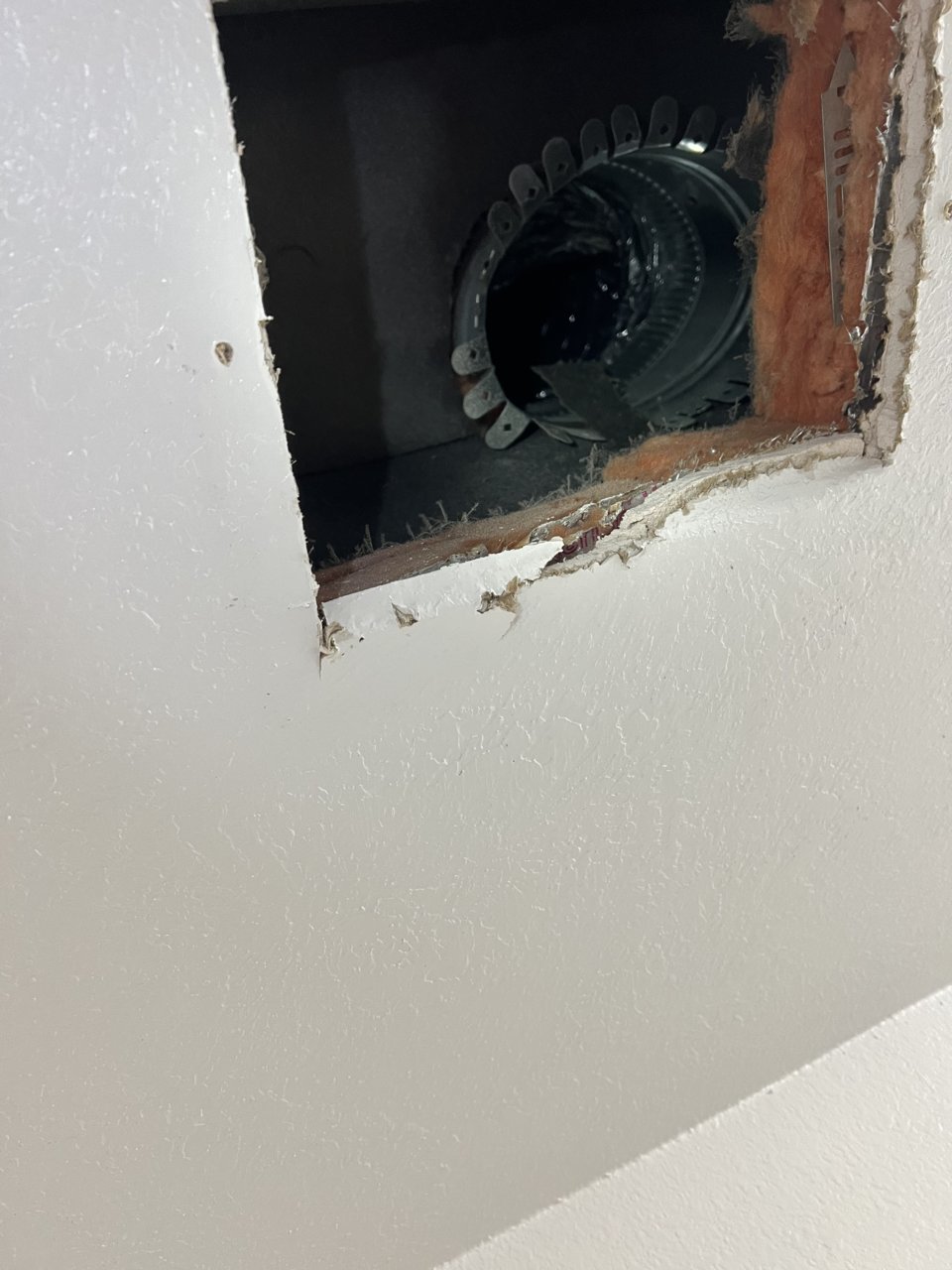

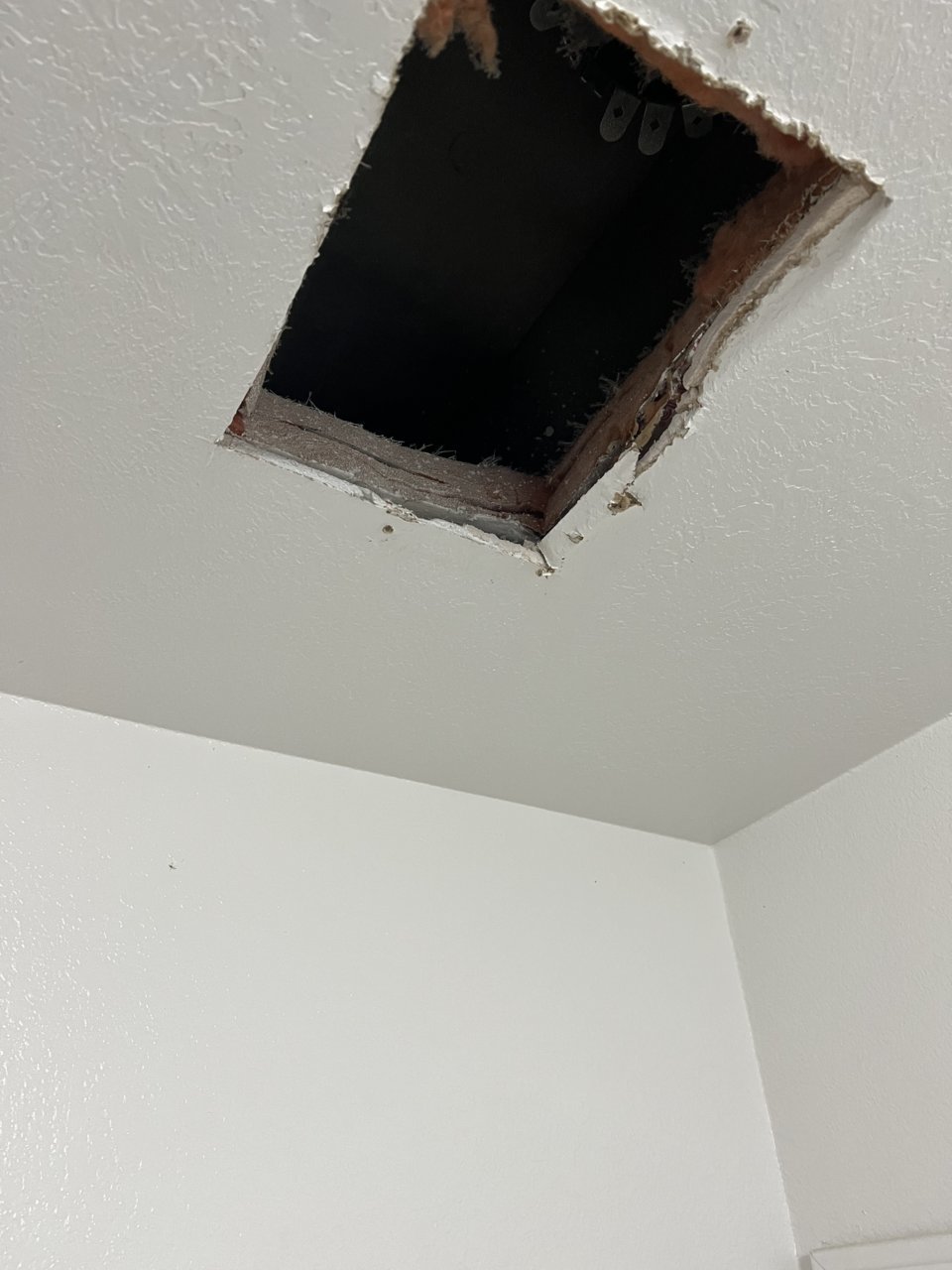

    No, you can see where the flex line connects to this box the register is screwed over. It's just a box with foil on the outside and some kind of foam on the inside. No metal, it's pliable. Looks gypsy as hell, but I'm no HVAC pro. Here's a better picture of the mangle I want to address:

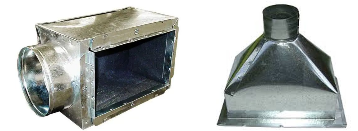

    These are the two I've typically seen in most homes I've had to deal with. The one on the left, I suspect is what yours is, but it's wrapped with foil insulation and the flange was cut out. Or it could be that they used a standard box and lined it with HVAC duct fiberboard. The one on the right is what is throughout my house, and I prefer, but it can rust out. I'm not sure what the benefit is using the one on the left. The one on the left, that outlet is what your flex should be connected to, and that outlet is what I suspect the fingers are in your picture.
    But they may've janked it together, using the typical insulated box you use at the air handler, cut their own hole, used their own outlet, and tossed some shit inside. You never know. Stupid shit like that is why I prefer to do my own damn work. Too many people are more interested in janky shortcuts than doing the job right.

    When I built this house, the HVAC installer did a terrible job. I have had hell with the unit since day one. They didn't hang the vents in the attic, just laying tangled everywhere. The inside unit was not elevated properly, rusted out and met an early demise. I recently got some of it fixed up, as I'm going to deck the attic and use it for storage. Here's the after, wish I would have taken a before picture. This is just one side above the living room.

    Not sure why there is fiberglass insulation batting inside the airbox.

    I'm pretty sure that's the 'black' fiberboard that's inside those baffle boxes. I see what looks like jagged metal just inside the sheet rock, and the 'fiberglass' is above that. I'm thinking someone cut the flange off the original insulated box in the ceiling, cut right through the fiberboard (which is painted black on the side you get to see) and you're seeing the midsection. Think medium-rare steak. Nice and brown with black sear lines on the outside, but perfectly deep pink in the middle.
    Why would anyone do that? Who the hell knows. Or maybe they totally cut the bottom out of the box, or built their own. People in any industry do wack ass shit to save a buck so it'll be one more buck in their pocket. Sadly, a lot of the people doing it are our (or at least my) generation, and they're teaching the younger guys to do the same.
    But I could also be wrong. It's tough to say, not being there in person. I bet @FrenchToasty has some fun field horror stories to share.

    I would find a way to cover all of that exposed fiberglass. Foil duct tape perhaps.

    That appears to be blowed foam in between roof rafters ? Are they not required to put bats or blown insulation between ceiling joists above living room or I’m not seeing what I’m seeing :confused:

    My townhouse was built in the 80s and has the exact same thing. Vent is hanging on by one screw on my popcorn ceiling. :rofl:

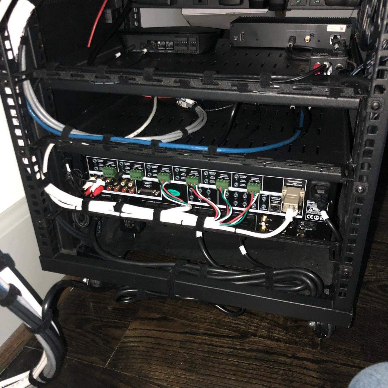

    my buddy that does home automation does that.
    the jobs he does now they prewire their racks so everything is labeled all ocd like.

    Yea, sprayed in foam is the ticket for metal buildings. Told the guys to spray it all, knowing i could cut it for some turbine vents, but havent needed em yet. But i put my doors where i can have a breeze no matter which way the wind is blowing.
    chrisb, NUDRAT[OP] and txagg like this.
