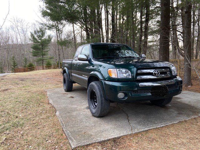

    I'm on stock wheels though, so I'm sure that factors in. I haven't got to do any real testing yet.

    That's about where my 275s sat. 8.5 at 0mm. Like a stock wheel on a 1-1.25" spacer.

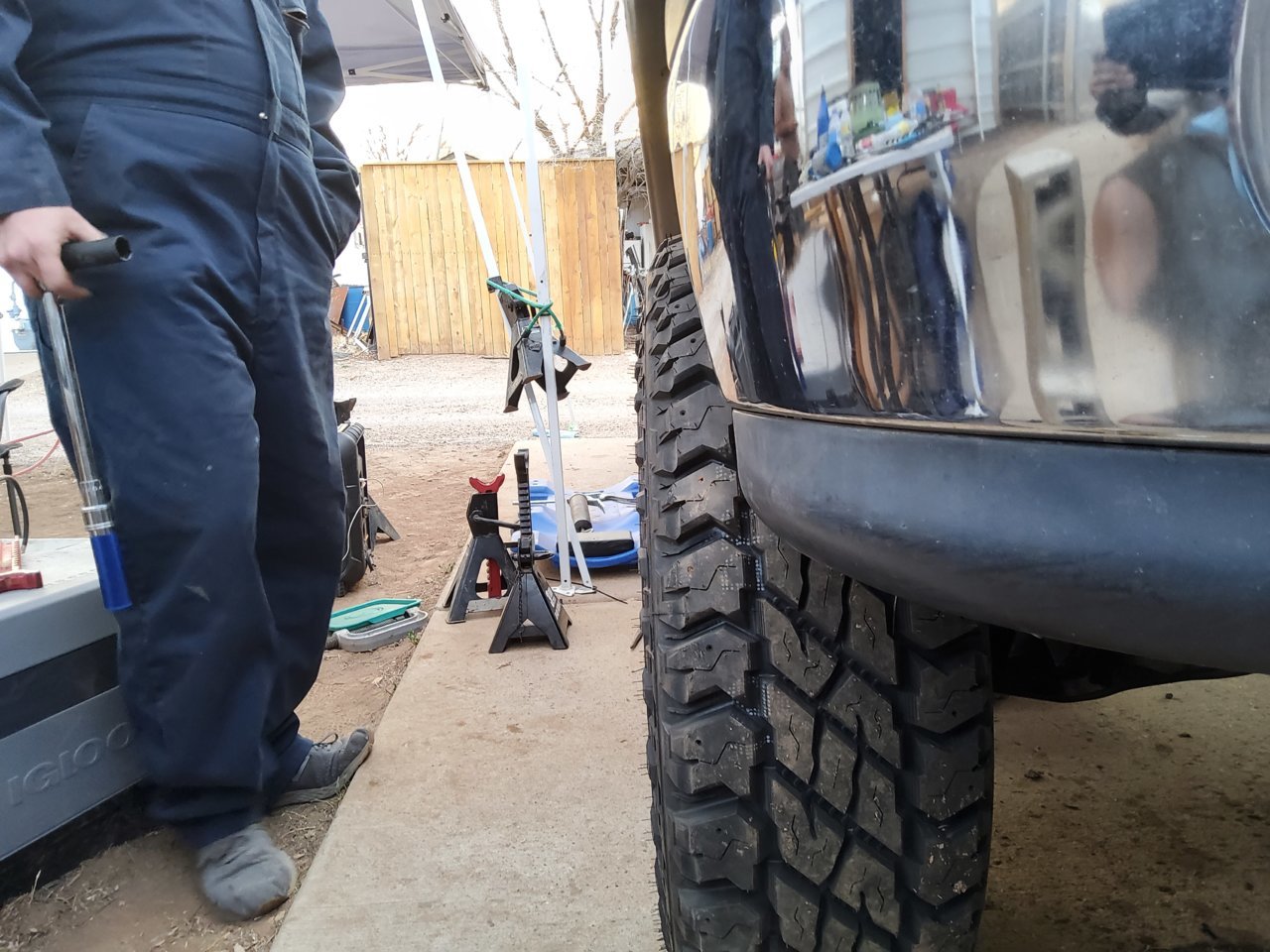

    My wheels are 17x9 et-12
    I only rub the edge of the bumper when I back up...since trimming the bumper a little bit and removing the mudflaps. Stock LCAs tho. I'm curious how it'd all sit with the new SOLO arms.

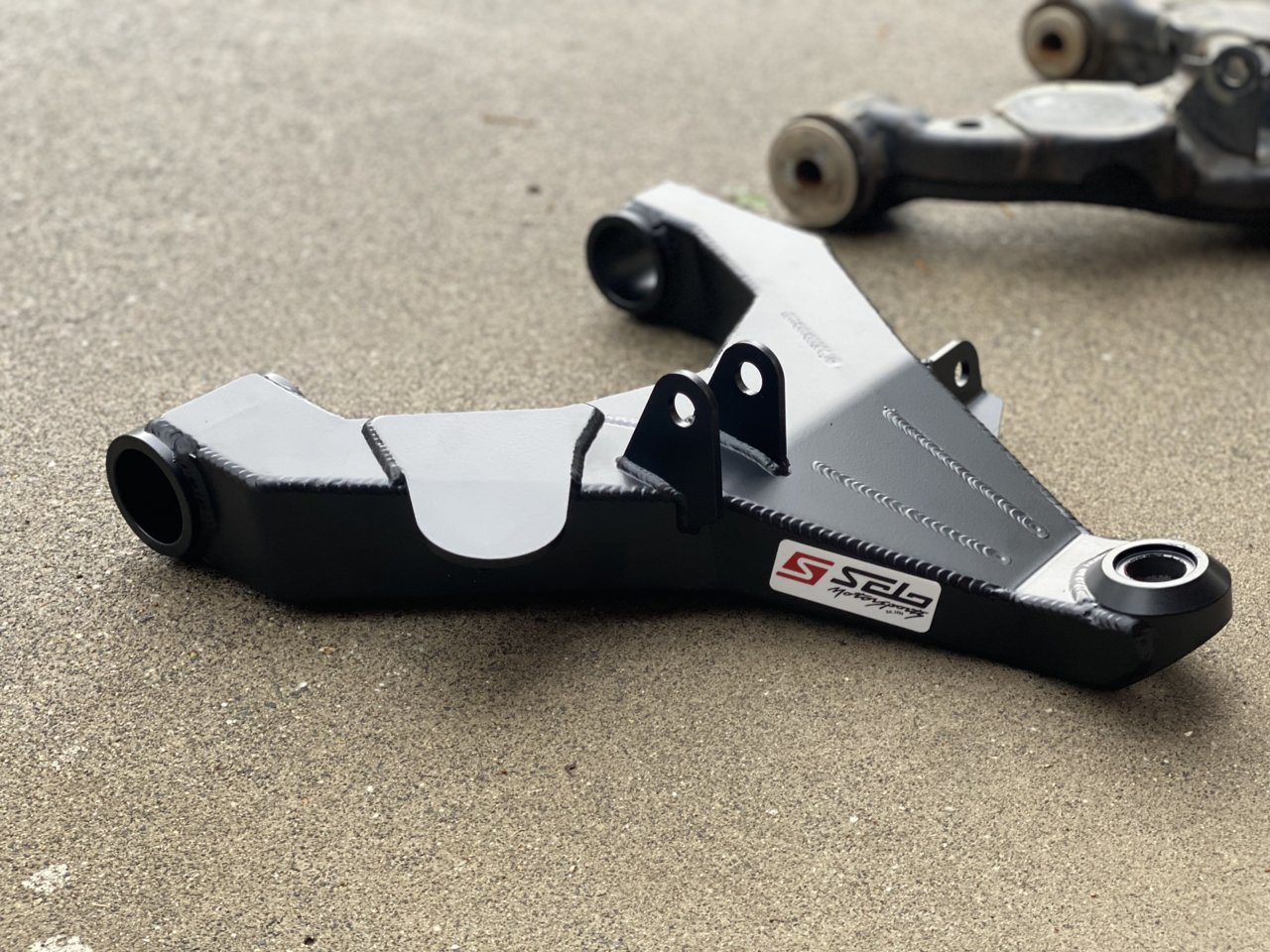

    They move the wheel forward, visibly so if you look carefully before and after.

    I have my adjusters pretty maxed out to get as much caster as possible. I reckon the SOLOs would be a better solution for my truck.
