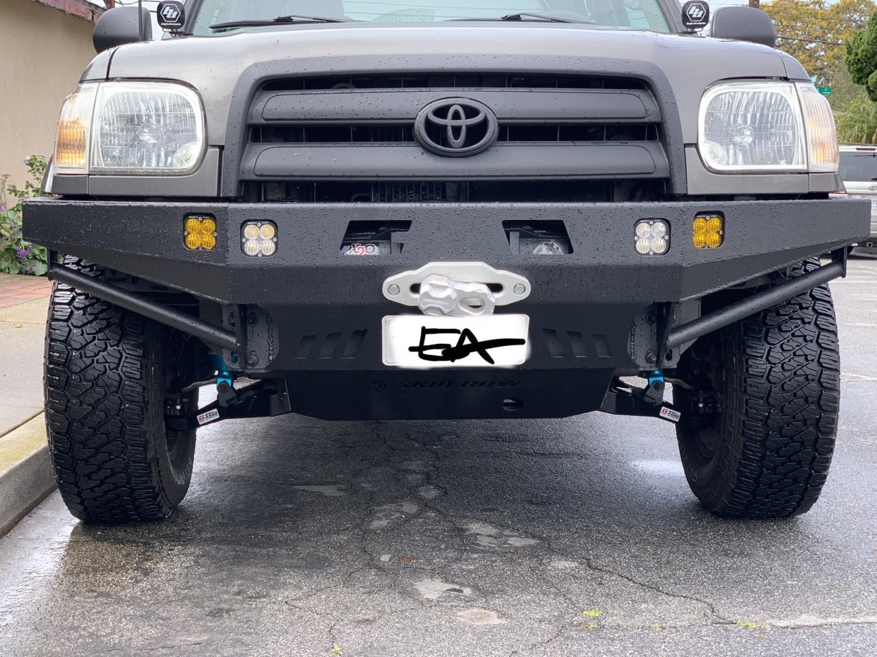

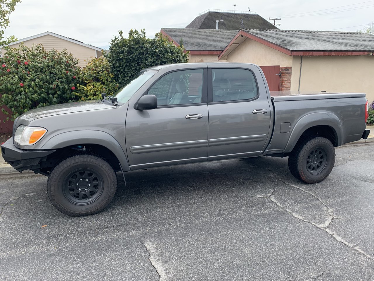

    So the Solo LCA’s are a go if you want or need them. Alignment took care of everything. I haven’t put a tape to it, but front looks like same stance. Turning radius is tighter. I gave the shop @assassin10000 specs and they got very close. Caster fell at +4.5. Drives great.

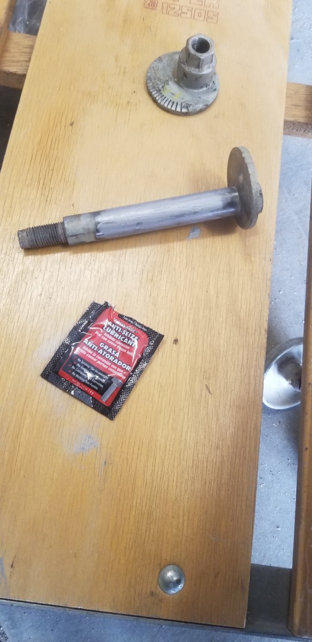

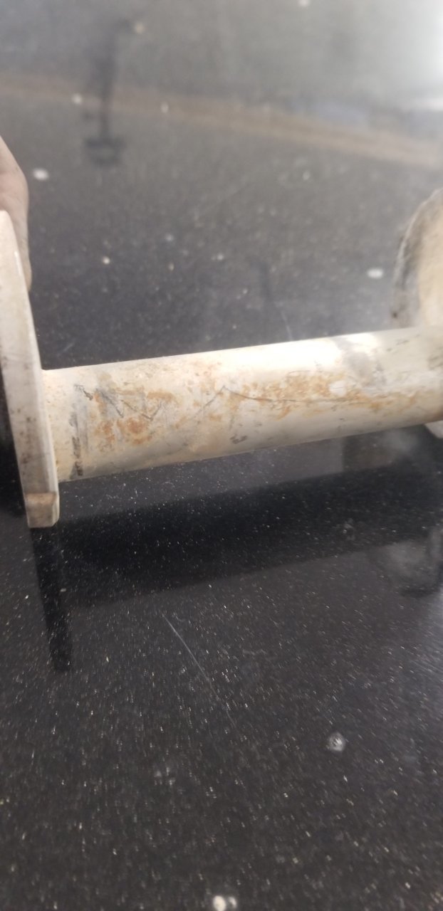

    Dave. Buddy, friend, my dude. Stop worrying about those damn bolts :rofl: One of the main reasons they are replaced is because they are physically seized and cannot be removed due to rust and they need to be cut off with a blade.
    Here is what mine looked like, I'm sure yours are not much different unless the PO after you drove into the ocean. This grinds off super easy and doesn't affect the integrity.
    Afterwards they can get a bit of anti-seize for good measure.

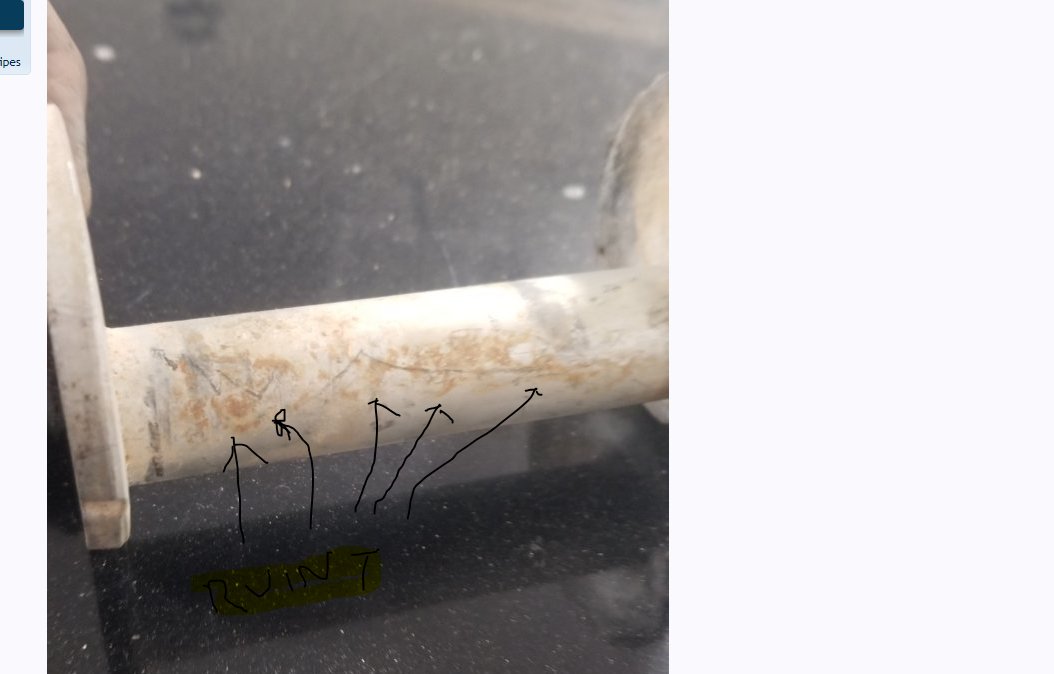

    IDK guys.
    I looked a little closer...

    The black marks? Those are probably from removal.

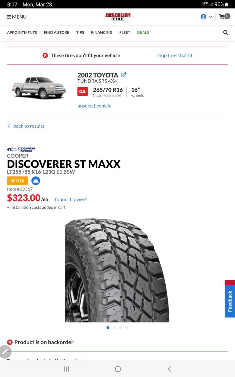

    Got the kerfuffle sorted out with discount. I ordered directly from the store. They'll be here Friday, but I had to go with Coopers instead of the BFGs. No biggie, my Coopers have been fine for almost 4 years now. $1500 doll hairs. Ouch.

    I meant this tiny tiny orange marks indicating the beginning of rust...and I was joking.

    I wish I could compare the skinnies with the fatties. I went 285/75R16 for mine. I could see 255/85R16 next time. Everyone raves about the skinnies.
