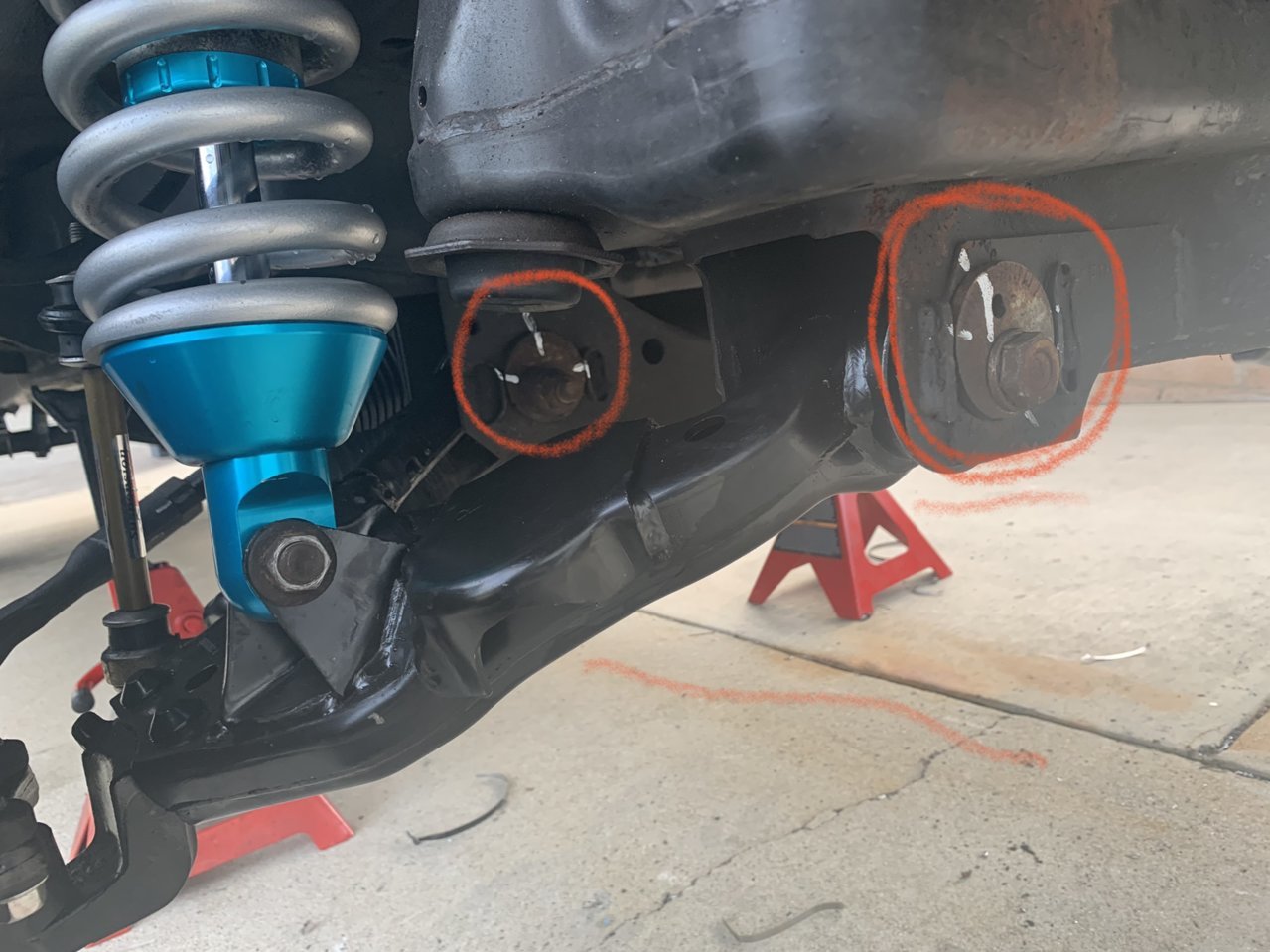

    I just did the lowers and the cams are good. I do have some new SPCs sitting in the shop I never used. I'm not familiar with the POS roady ones.

    Your upper control arms are fine unless they give you a problem. The cam bolts are the bolts and cams that attach your solo control arms to the frame, and also are used for alignment. I bought the SPC cam bolts in case I needed them when I first did my lower control arms for an stock replacement. My cam bolts were all good so I never used them.

    So I should buy SPC cam bolts for these just in case you think? Or bolts is bolts?

    I'll send you mine, if you need them, use them. If the originals are good, use those

    These are cam bolts

    SPCs have not given me trouble at all. Don't worry. One of the reason the cam bolts are replaced is because they're seized due to rust. I doubt that is the case with yours so I would leave them. They might have a very minor amount of surface rust on the sleeves, which can easily be ground off. Light layer of anti-seize and they're good to go.

    That's what I did, I had the aftermarket cam bolts in case I got in there and had a problem. Light surface rust on one only, cleaned it and re-used the OEM set.
