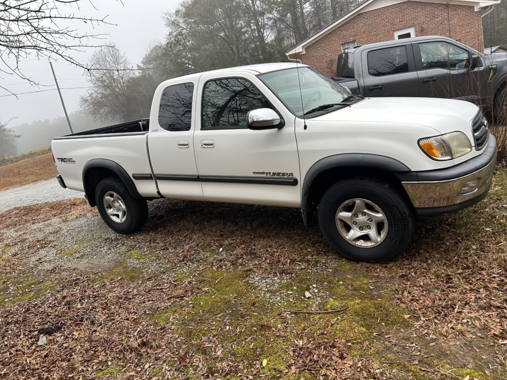

    Hey so I have a 2002 4wd tundra. And I want to get anywhere from a 3-4in lift in the front and around 1-2 in the back . I’ve been looking at the bilstein 5100s and I’m curious where y’all are buying these. I can’t seem to find a good place to buy them. From my understanding you buy just the strut part and you put the stock spring and top hat on. Let me know what yall would recommend and where I can buy it thanks.

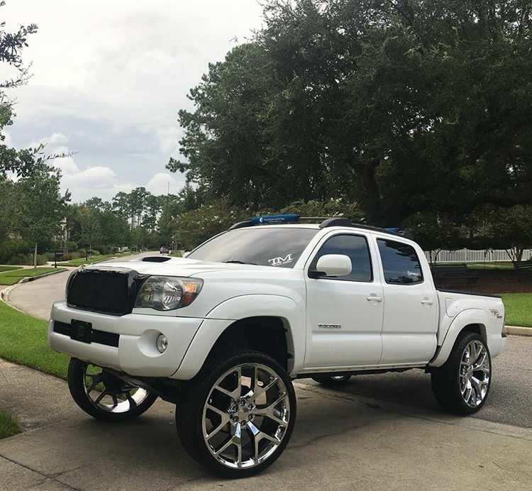

    Oh you're one of those BroDozers wanting the cali lean? Be prepared for any 1st Gen Tundra enthusiast to smote you. Freakin crackers.

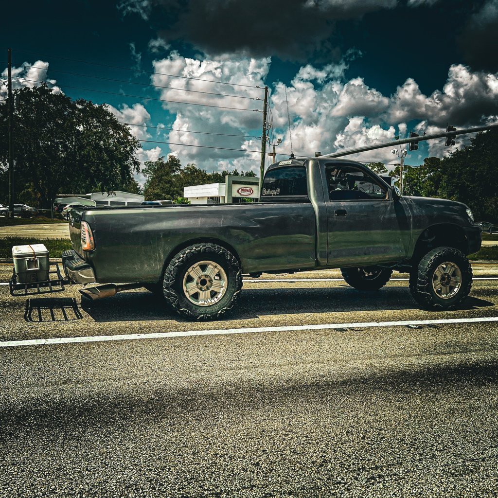

    OK guys, he did say "slightly leaning back". Not Squatted.
    I was thinking more like this kind of stance he was OK with if not completely level.

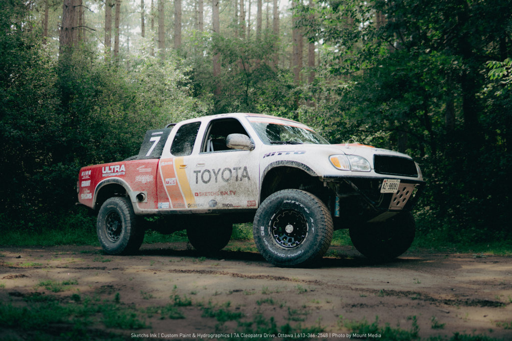

    He's not a pre-runner. And, he's not installing LT. 5100s are a long way from LT.
    But if I had an extra $10-20K burning a hole in my pocket, I'd probably do this too. Can't be all show, no go.
