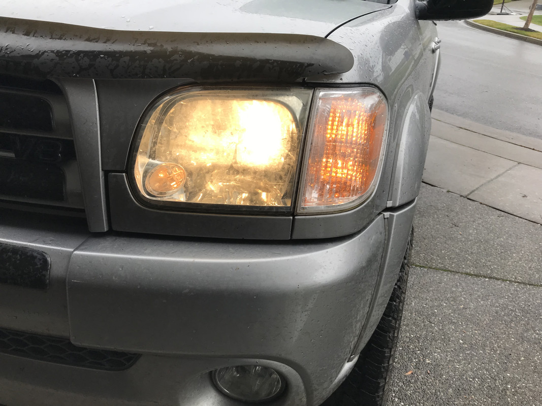

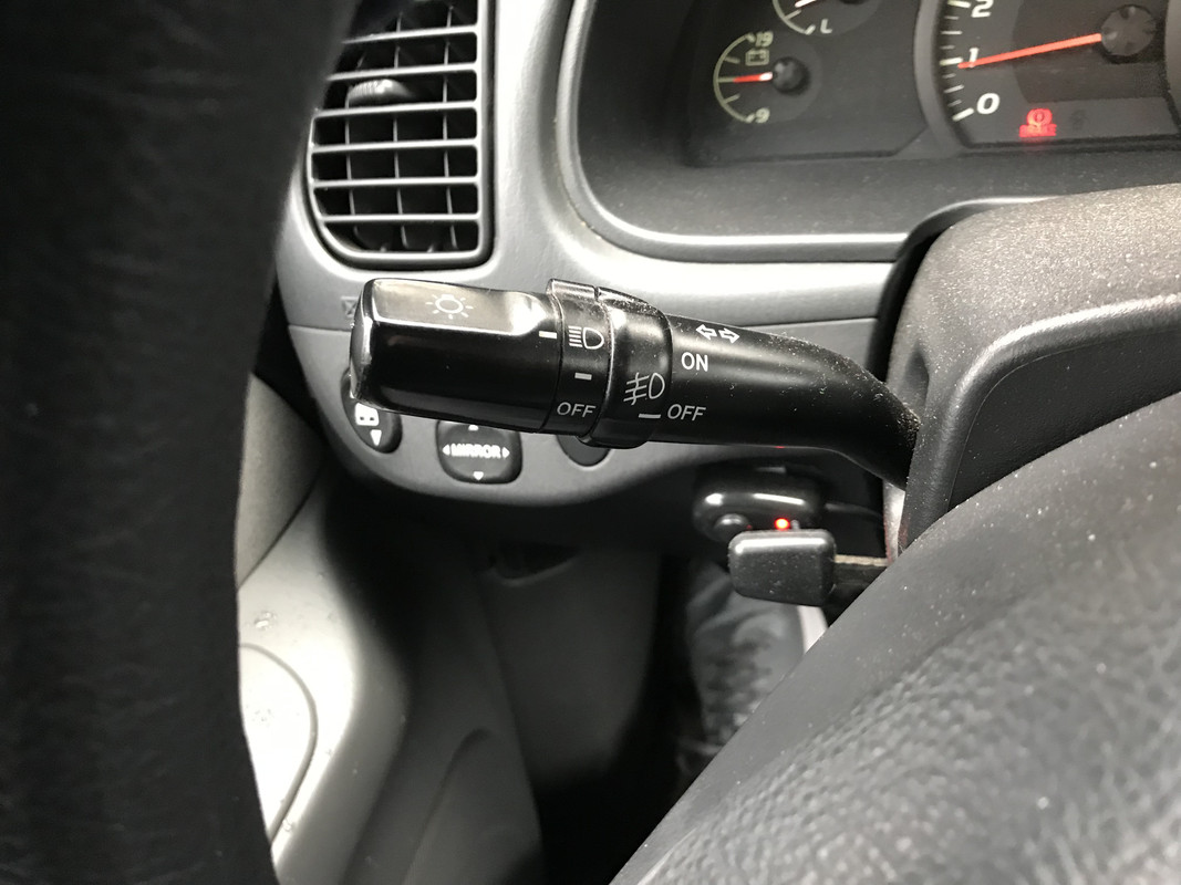

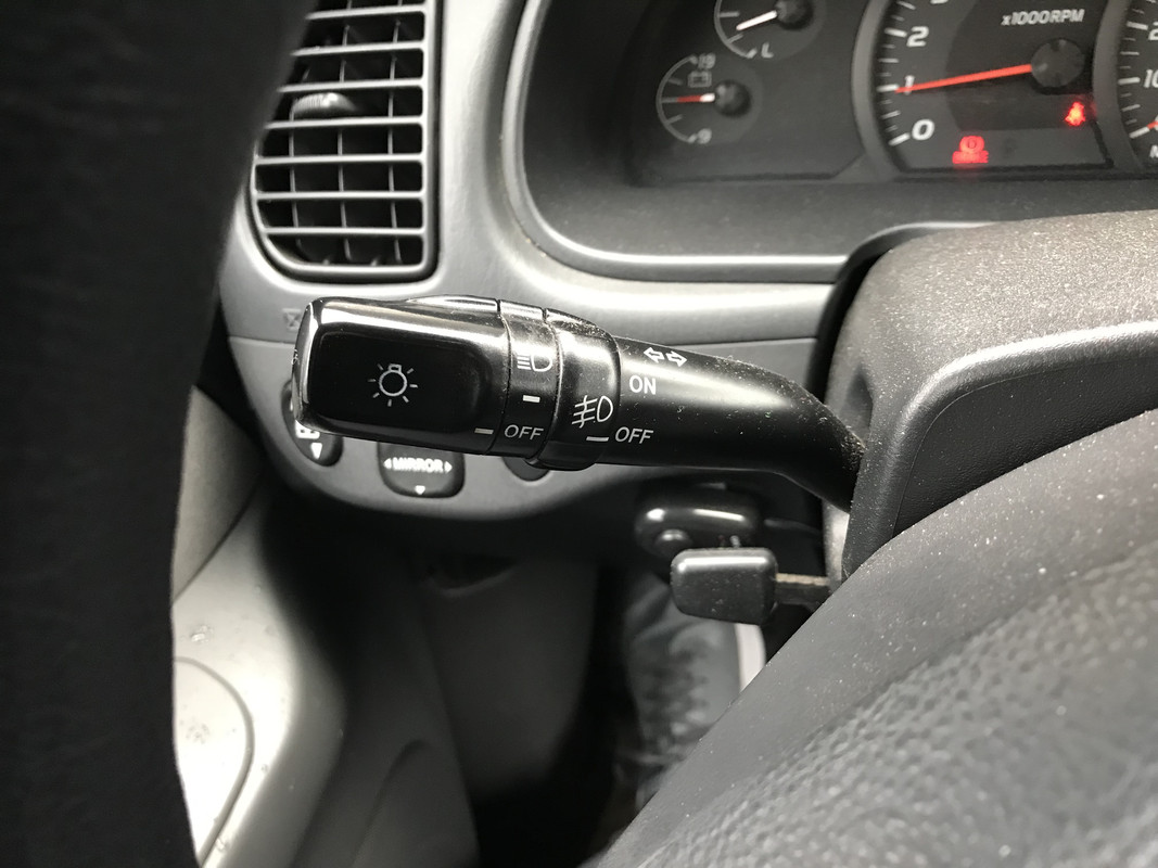

  5. Dec 14, 2018 at 11:00 AM
    #35
    Baller
    Baller New Member
    Jul 22, 2018
    #17275
    837
    '05 Tundra SR5 DC
    I had to look into this for myself. I've got an '05 and here's what I get.
    With this,
    I get this,
    With this,
    I get this,
    With this,
    I get this,
    Sunnier and FlightSimGuy[OP] like this.
  6. Dec 14, 2018 at 1:37 PM
    #36
    bmf4069
    bmf4069 WHO KEEPS CHANGING THIS!
    Sep 1, 2018
    #18880
    10,018
    Beau
    TX
    02 AC sr5 4wd v8
    Looks about right.
  7. Dec 14, 2018 at 1:40 PM
    #37
    Casper421
    Casper421 Toyota RidgeTrac driver!
    Jul 12, 2017
    #8530
    4,129
    In the woods
    06 DC
    I don’t see a difference in the last two pics.
  8. Dec 14, 2018 at 1:42 PM
    #38
    bmf4069
    Sep 1, 2018
    #18880
    10,018
    Beau
    TX
    02 AC sr5 4wd v8
    There's a leaf on the sidewalk in the last one.
    ColumbiaGorge, seth419 and Sunnier like this.
  9. Dec 14, 2018 at 1:50 PM
    #39
    FlightSimGuy
    FlightSimGuy [OP] New Member
    Sep 1, 2018
    #18872
    379
    2006 Tundra SR5 V8 DC
    ICON 2.5 shocks with King 14" 700lb coils, Camburg UCAs, ICON V2.0 rear shocks.
    Definitely a time lapse happening. :D
    Look at the switch position, yet the lights don't change. Same thing my truck does.
  10. Dec 14, 2018 at 1:53 PM
    #40
    Casper421
    Jul 12, 2017
    #8530
    4,129
    In the woods
    06 DC
    I don’t believe the “off” position should have any lights on.
    FlightSimGuy[OP] likes this.

  14. Dec 14, 2018 at 3:21 PM
    #44
    Baller
    Baller New Member
    Jul 22, 2018
    #17275
    837
    '05 Tundra SR5 DC
    It doesn't look like the picture relays reality perfectly but, with the switch in the lights "on" position, the lights are a bit brighter. Now that I go back and forth, quickly, between the pictures, you can appreciate the lights are a bit brighter in the last picture.
  15. Dec 14, 2018 at 3:24 PM
    #45
    Professional Hand Model
    #14878
    14,993
    Fred
    Hand Protectors
    Those lights are DTR in OFF position (half power). Lights in ON are full strength. He has DTR.
