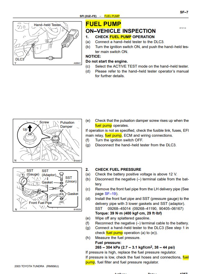

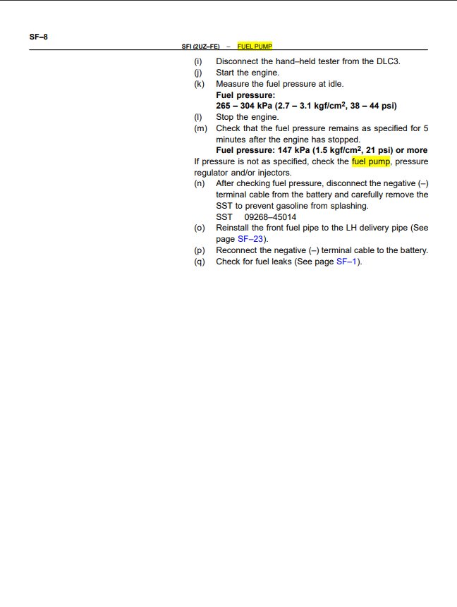

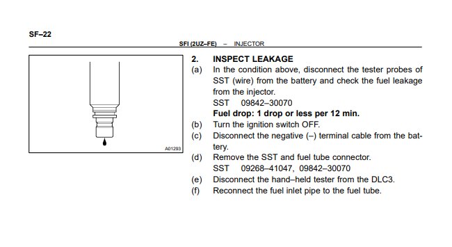

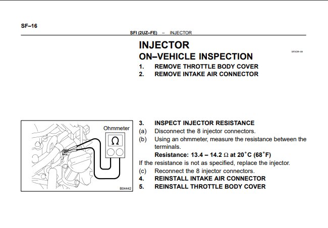

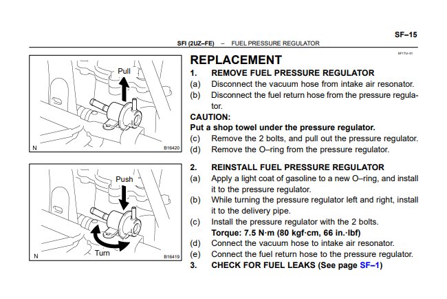

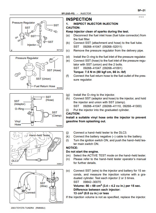

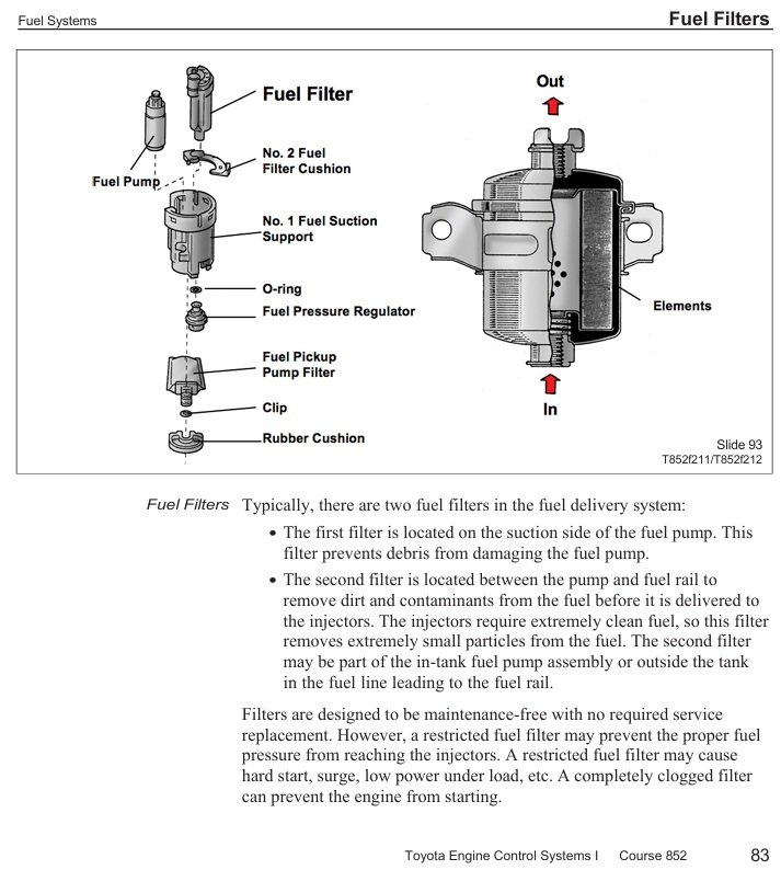

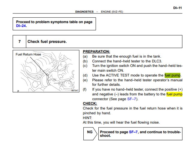

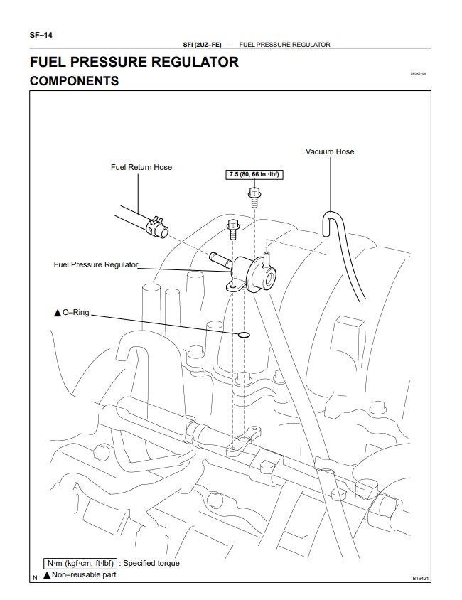

    Here are a few helpful references for you from the FSM (this is all assuming it's fuel related as your post leads to believe)
    tvpierce and Jack McCarthy like this.

    Right. Pull the timing cover first as shifty has suggested and check those wires and routing. Then get a copy of the FSM and start hunting. We'll assist along the way. Be sure to post pics, check for DTCs and update us.

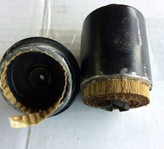

    While the Toyota Maintenance Schedule Guide that came with my 04 DC LTD does not address fuel filter replacement, anything I can do to keep contaminants out of my injectors, I have no problem doing that. They did not design them with filtering element just so fuel can pass thru freely as if they were wide open. Anything to help my fuel trims more the merrier. I was here a few years before I even knew there was one but changed it at 196K about time I did timing belt.

    It's true, it's not a direct pass-thru, but it's nowhere near the overly-pleated cluster aftermarket filters tend to be.

    I wouldn't know, never seen anyone post a cutaway of either.

    I'm tempted to buy one just to slice it open. IIRC, it's a perforated steel tube thru the middle, with filter material wrapped around it, similar to some mufflers.
