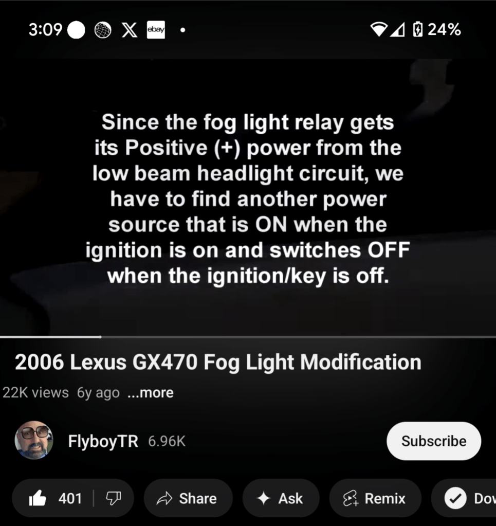

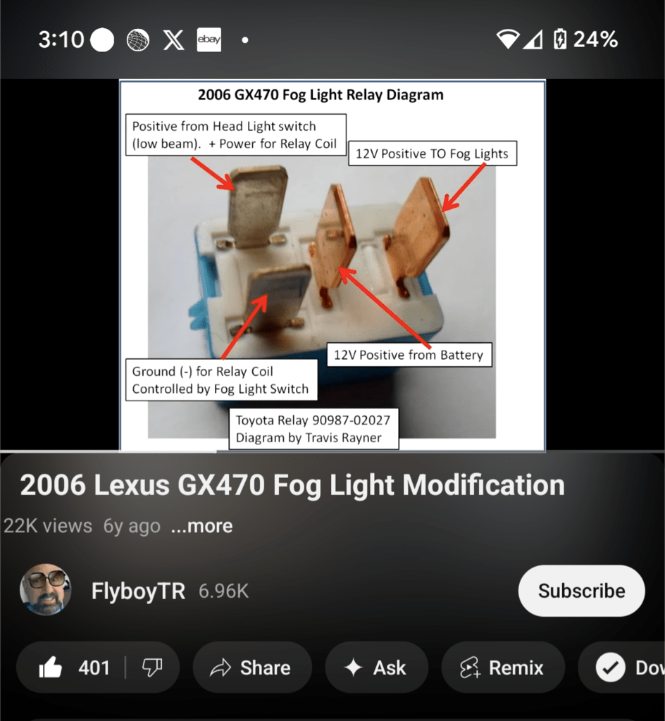

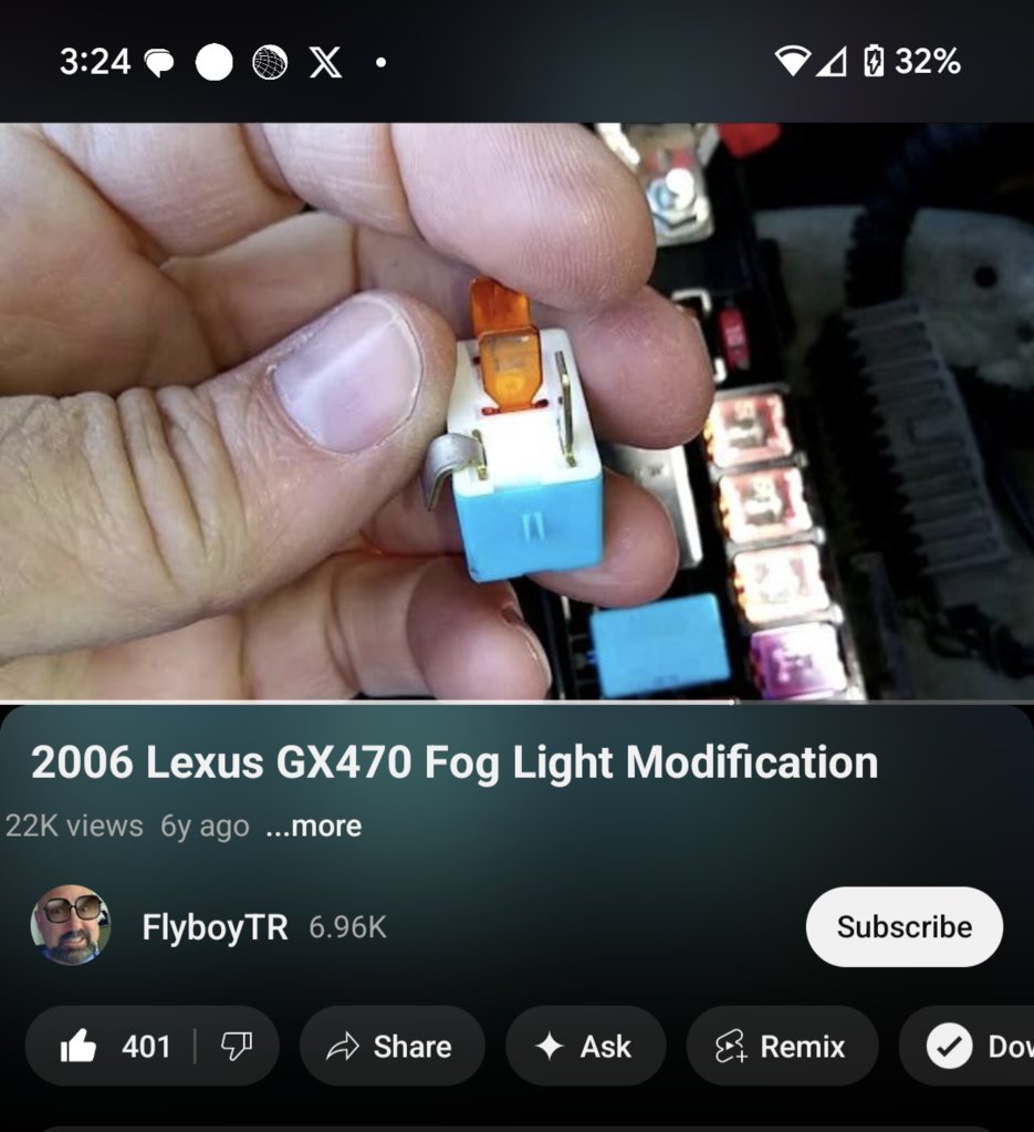

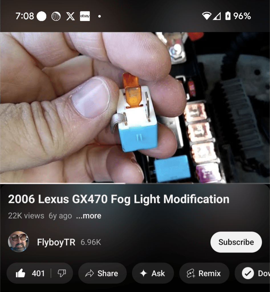

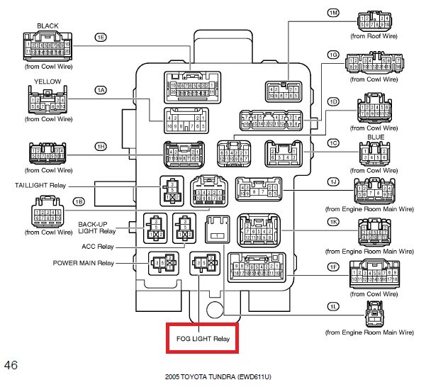

    I found this post on TS. I think it will be helpful for you, its an 05 DC with DRL. post #5 is more helpful. I will use this as a starting point for my 06 sequoia. Just not sure what the auto headlight function I have will do to this plan, hopefully it works.
    where do guys find the colored factory wiring schematics? searched all over and can't find them. I have FSM downloads but don't see any schematics in there.
