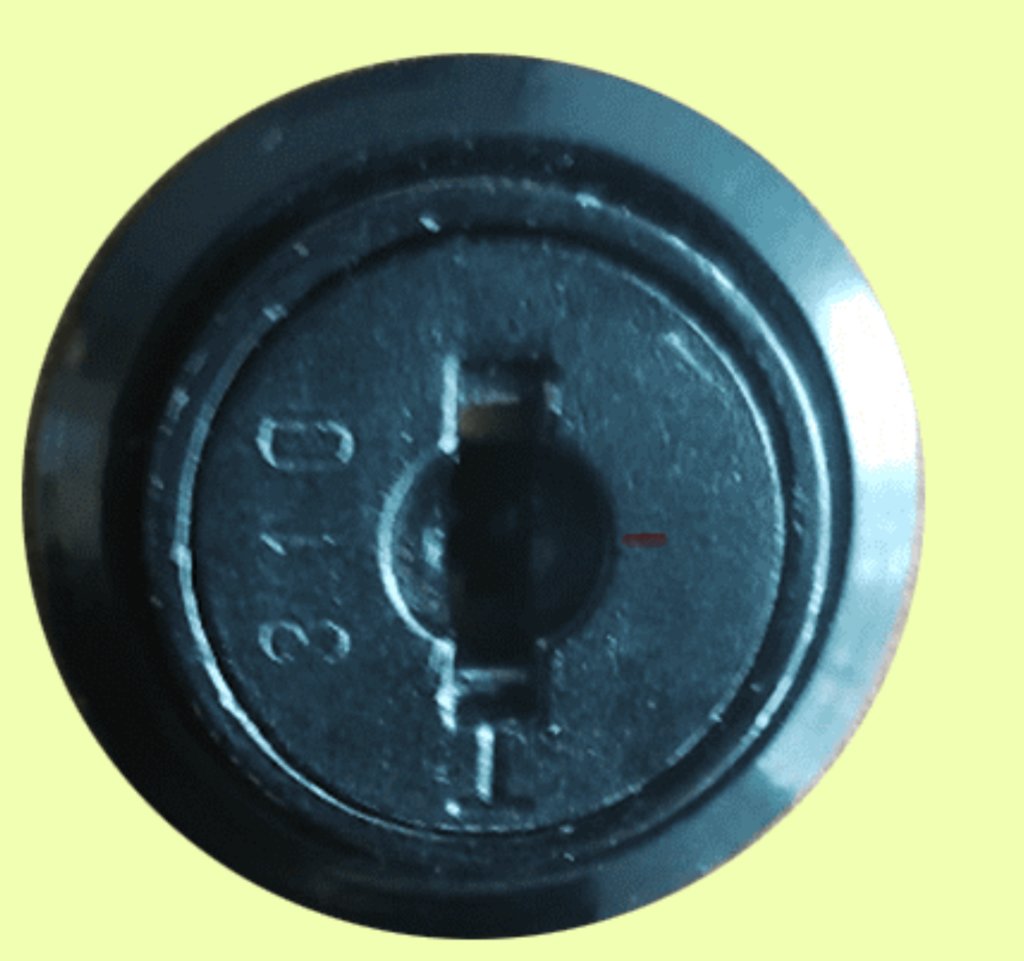

    Typically speaking the lock itself will have a number stamped in the face like this. That number is the key you need. Sometimes it’s prefixed with a letter and number. You don’t usually need to go thru the dealer to get them. Like, if your lock is stamped “K198” and you search the interwebs for “K198 key”, you can find them.

    J327 googling now
    Worse case scenario I know a local tundra guy who's a lock smith. He's going to check it out Thursday.

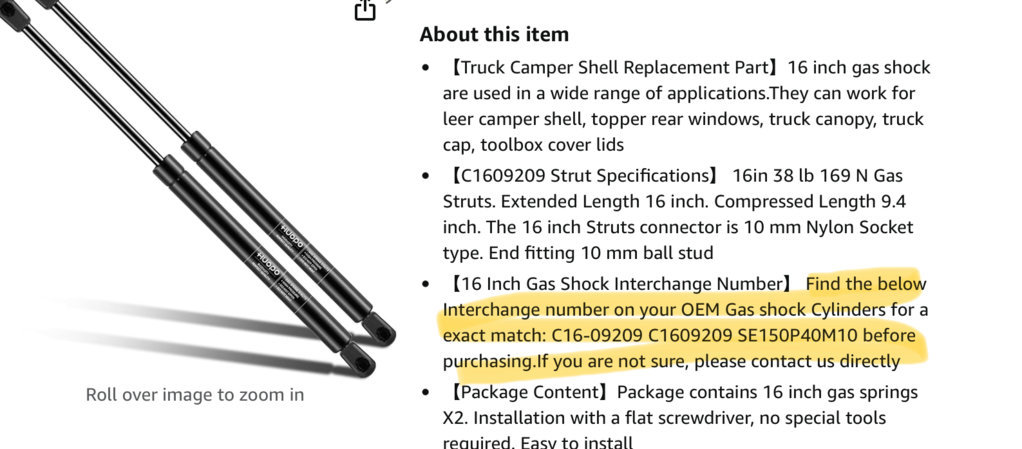

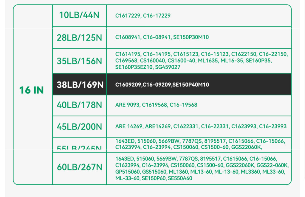

    There's also a number on the struts, and a lot of sites let you cross-reference. Even on a lot of the amazonian products, there'll be a list of compatible model numbers. I went through this. When I was working on replacing the rear window on my topper, I first wanted to order new, equivalent struts to what came with it. But the plexiglass sheet I made was so light, they were too strong. But then it shattered and the thick glass I replaced it with was too heavy. I bought three sets of struts over a couple month period.
    There's a certain length that'll work, and that, along with the end/connection size, seems to be the model number. Within that model number, there are often a few different weight options. I went with a far higher pound rating within the same strut length, and finally found the sweet spot for my heavy glass rear window.
    Just one example from the struts I bought.

    These struts don't have any identification. They're about 17" expanded and 11" collapsed. So I'll just look for that. But I have no clue what the poundage should be

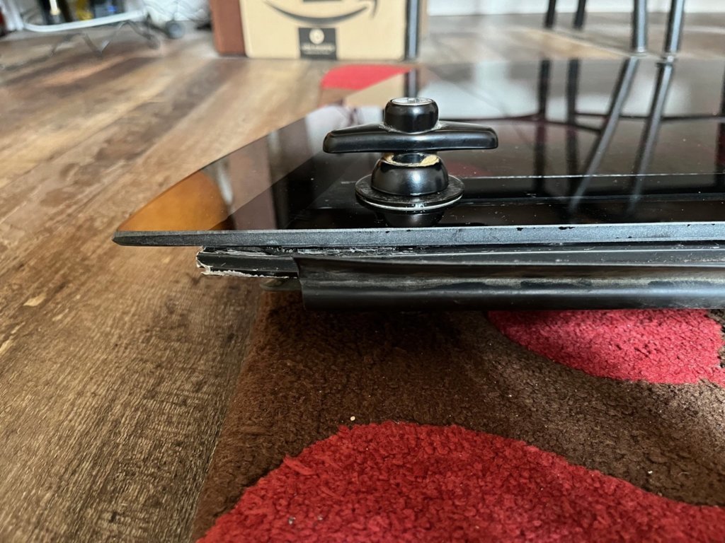

    38# seems excessive, but there's nothing wrong with excessive. I'm running 38# on my window with this glass:
    Heavy AF. Strut strength feels just right.
