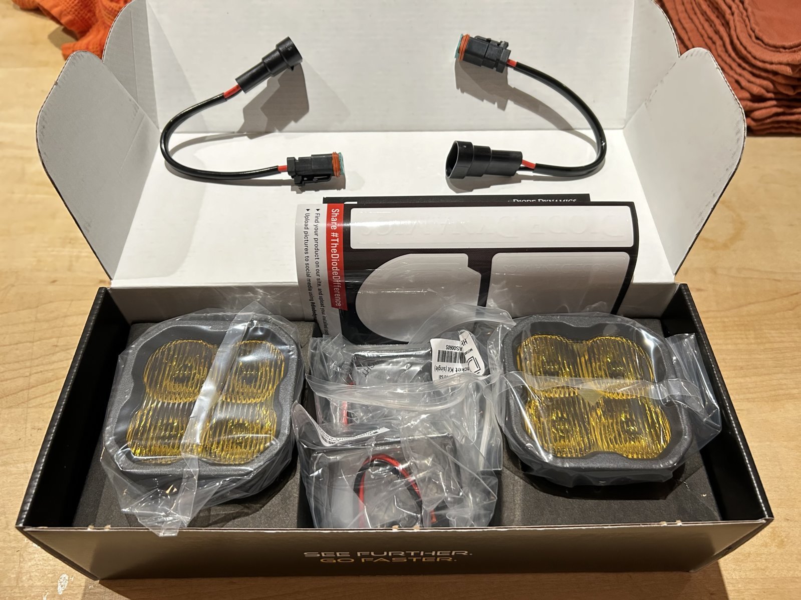

    2006 Tundra SR5 Double Cab - 4.7L V8 4x4
    I bought myself a set of underhood lights from YotaNation with the recent Black Friday pricing. My old truck had underhood lights, would like that feature on my Tundra.

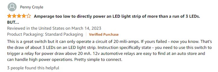

    This reminds me. I meant to look into whether or not the Taco or any of the SUVs pre-2015(ish) had switched under-hood lighting. This is also something so totally basic all my other trucks had, and I'm also disappointed without it. But I really hate reinventing the wheel, and if I can adapt something OEM that's suitable from an adjacent model, I'd love to do it. I guess on the later model Tundras they used an in-dash switch (pic), I'd prefer a contact switch/pin switch myself, something that automatically turns on with the hood opening. Matt Gecko makes a kit for the later model trucks (link)

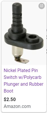

    I would probably prefer subbing out using a waterproof pin switch. This is potentially not waterproof, I'd prefer a rubber boot cover, but it gives you the idea. I'm not a fan of the metal switches, seen some nasty stuff with alarms using them over the years.

    Put a relay in it.

    I know I'm a bit late to this convo, but you could use a door switch. I've replaced the door switches on my truck and they were completely corrosion free. I'd personally trust a Toyota OEM switch much more than something else.

    Too much wire. I’d rather have a more streamlined solution.

    A year later, I went for the same black Friday deal as you! Got them with the brackets. How are you liking them? Otd was $282 bf sale on their website. They are backordered but they still allowed the order to be placed.

    I'm quite happy with them. I bought them direct from Foxbeam, but DD is selling the same kit.
    Install is easy. But I'll forwarn you. DO NOT attempt to force the light+bracket into the hole. Watch Foxbeam's install video online for 'how to build'. Before you install the light+bracket into the hole in your bumper, look closely at the tabs that'll hold the light in. Notice one side remains stationary and has a hole in it, and one is on a tab that flexes a bit.
    Install the bracket into the stationary one FIRST, then pivot the bracket in to catch the flexible one. Hopefully that makes sense? I did it naturally on the driver's side, but on the passenger's side, I think I tried to do it backwards and the damn bracket broke off. But he was cool about it and sent me a replacement bracket free of charge. I feel like the brackets need gussets for the two mounting ears/tabs to hold up to more abuse, but generally speaking, they've stayed aligned, and were super easy to dial in.

    what is your use-case for these? rain, snow, fog? or do you use them whenever you drive at night? what situation do you find them most useful?

    I’ve only used them in fog thus far. Spring and fall here we do get a fair amount of fog. They do a great job of catching road stripes. Not sure if they’d be good for ditch purposes, they don’t seem to cast wide enough IMO.
