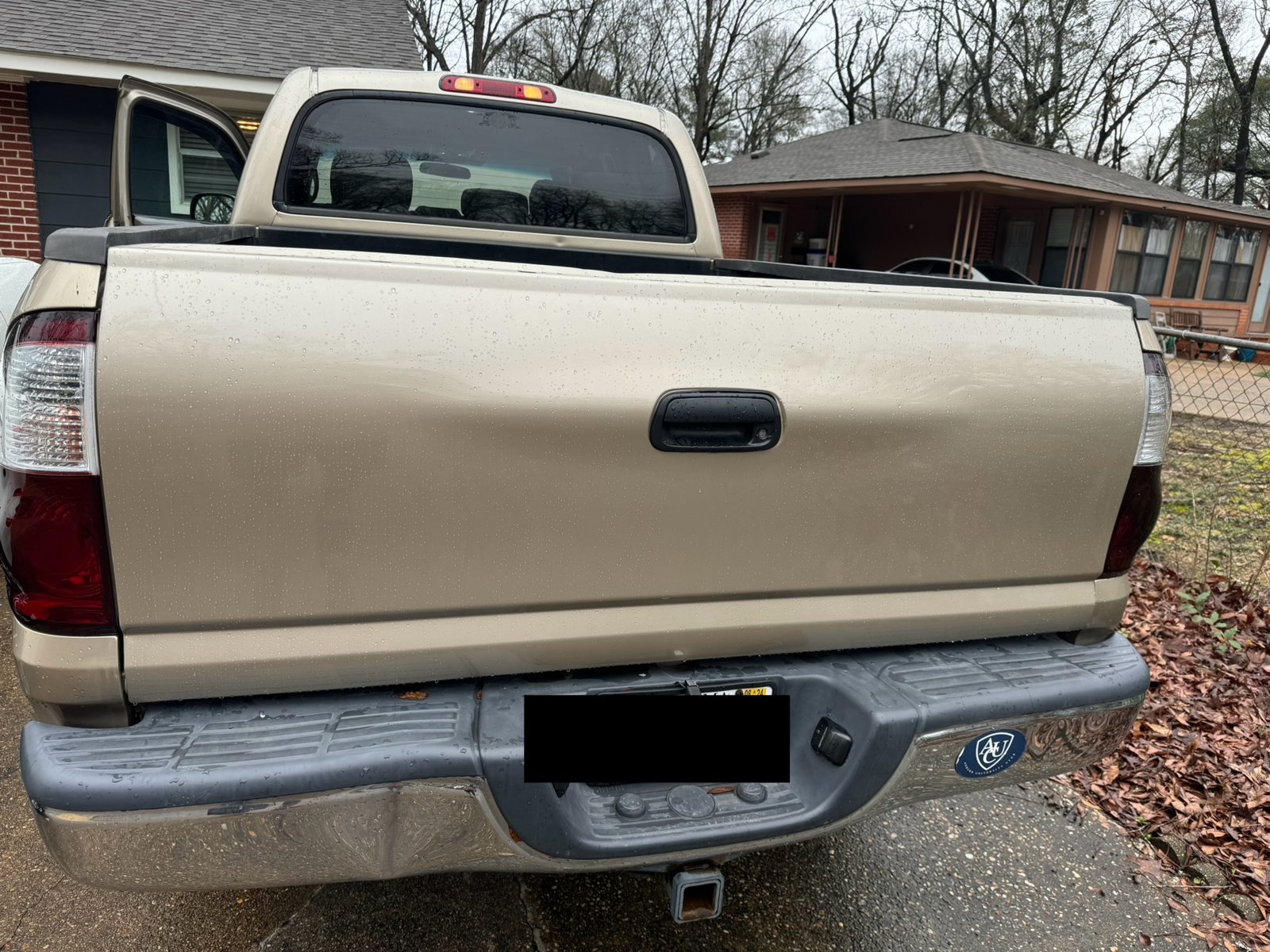

    Bilstein 5100's with 2883's - close to 2" Replacing the 2883's and going back to the bottom perch ASAP -mobile/apple play stereo with sub and backup cam -Power stop HD front calipers and rotors for towing -20" wheels with 32" tires (305/50's) Toyo AT 3's with no rubbing -Westin nerf bars -Detroit axle new (not rebuilt) steering rack with poly bushings, inner and outer TRE's -Suspension Maxx extended front sway bar links -Overland tuning - medium level -Power front leather seats and steering wheel from 06 Sequoia -fully de-chromed/blacked out trim -all light housings incl 3rd brake light and tag lights replaced with smoked lenses, LED where appropriate -mini projector headlights -fully rebuilt trans and new torque converter -new complete drive shaft with spicer u-joints and carrier bearing -all LED interior lights including backlighting -new lower window seals for all 4 doors -all new hardware and clips for tailgate Next: Dirty Deeds racing exhaust with LT headers, yellow box, 12 hole DD fuel injectors, redo or replace door panels
    Thanks for the write up. Although I replaced my latches I was still having a little difficulty opening. I've ordered some lube, and I also didn't realize mine was missing the stabilizer clips
    I always assumed mine was difficult to open because a city garbage truck backed into my tailgate years ago. It seems to have pulled the two sides where each of the hinges attached about half an inch closer.
    I may can use some sort of expander to push the sides back out 1/2" but I'm betting the biggest problem was lack of lube. And I'm sure the stabilizer clips will help a bit as well

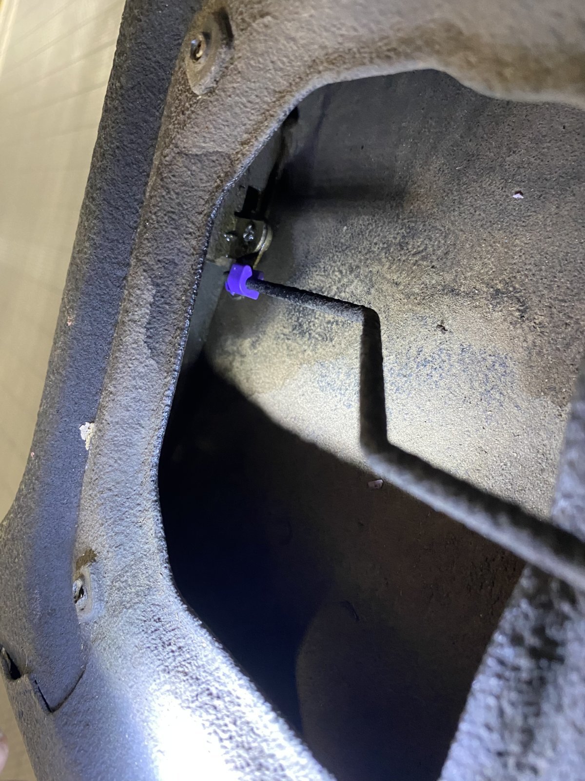

    wow i had a brainfart and ordered ONE of each. Just got home and was about to start. Few more days...

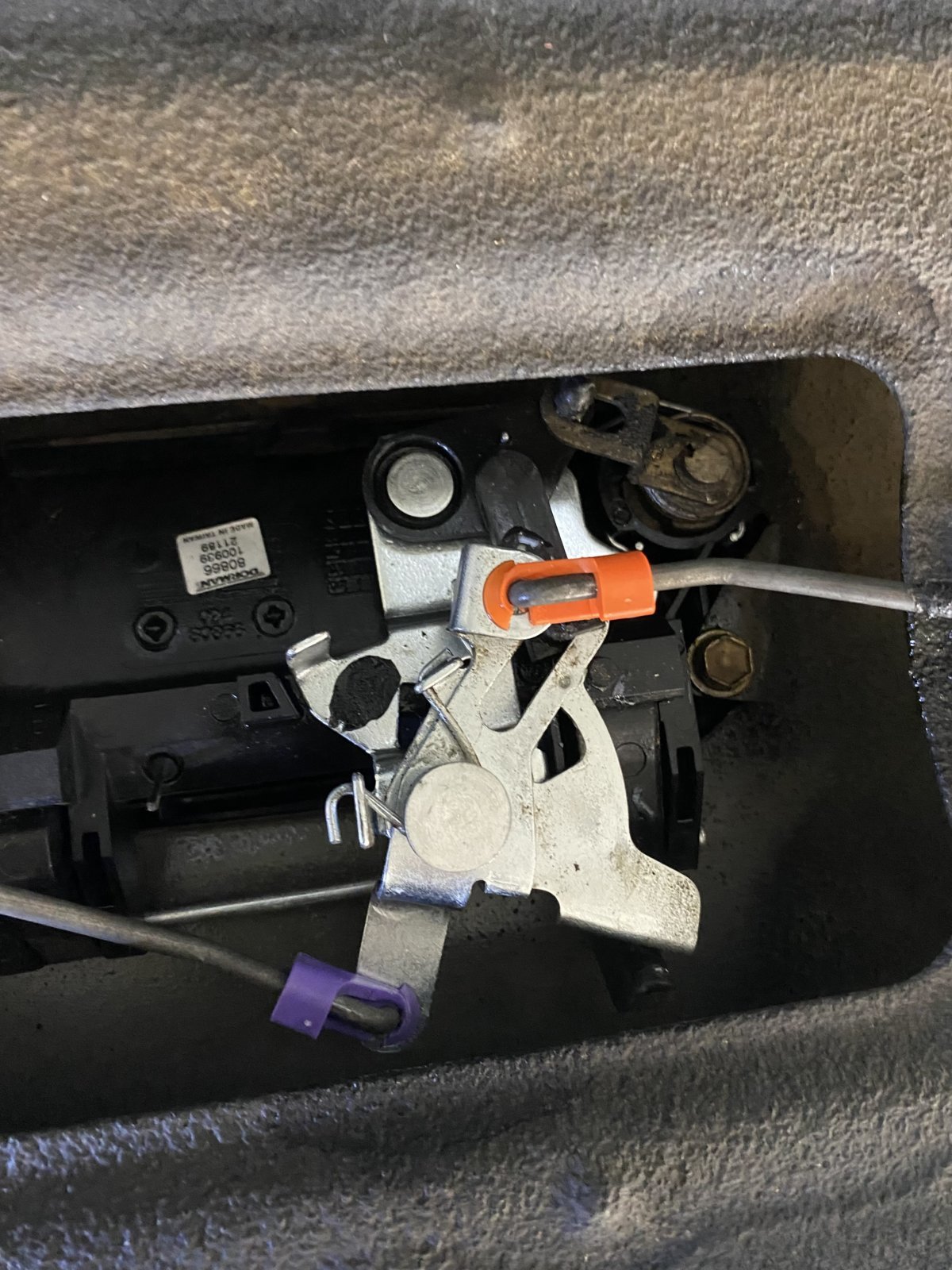

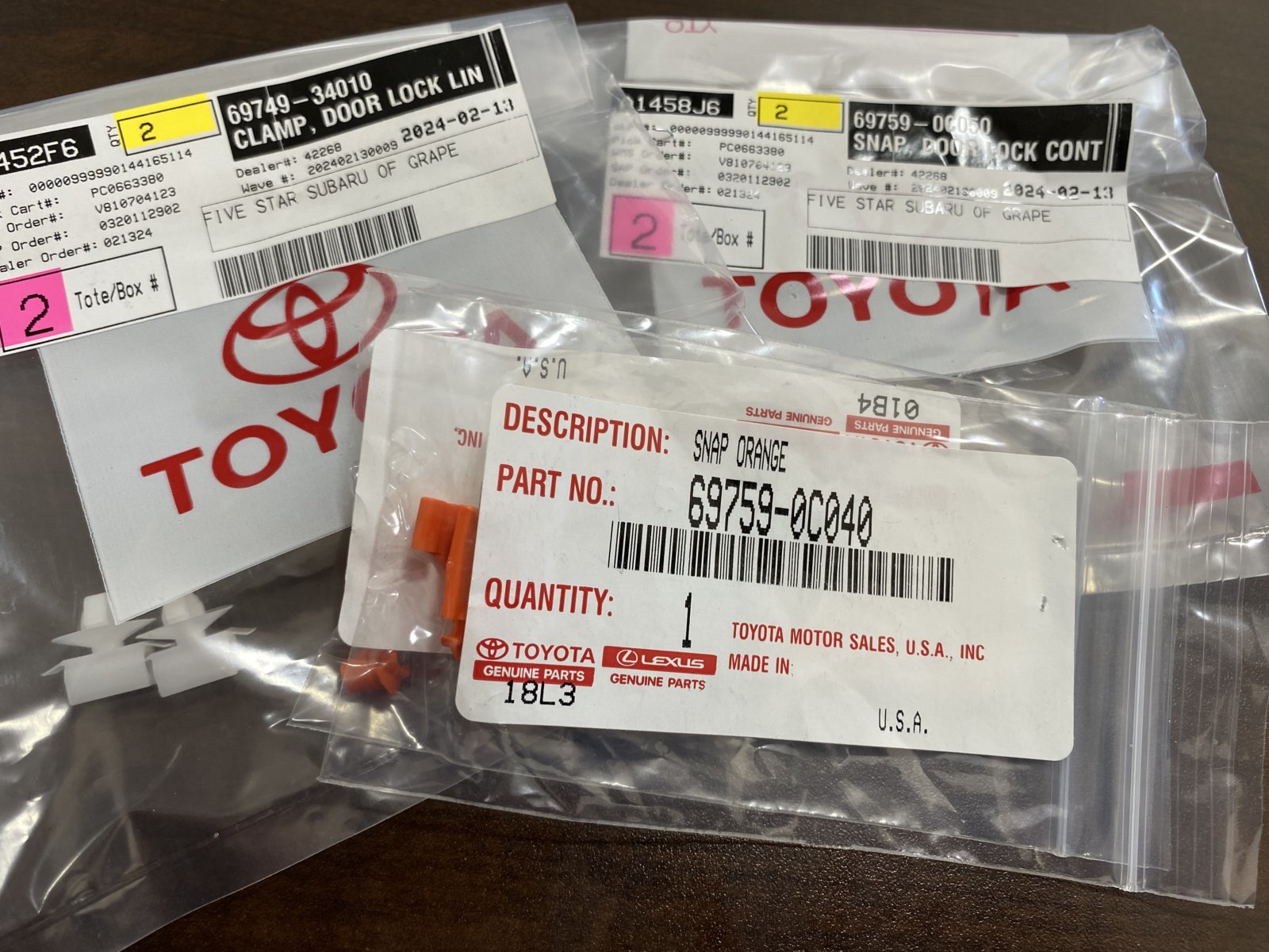

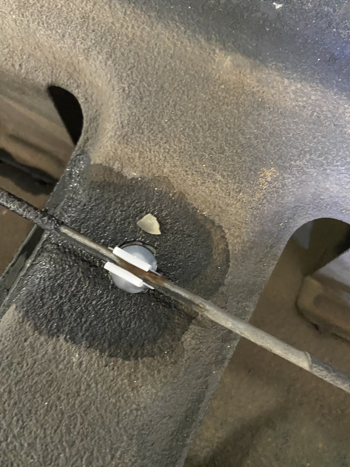

    I have yet to open mine up, but I will be ordering parts soon. Is there a part number for the mid-bar stabilizer?
  10. Feb 8, 2024 at 2:49 PM
    #40
    shifty`
    shifty` [OP] Waving My Dick In The Wind
    Jun 20, 2020
    #48239
    30,101
    ATL
    '06 AC Limited V8/4WD
    Right hand side of the 2nd picture in the 1st comment of this post.

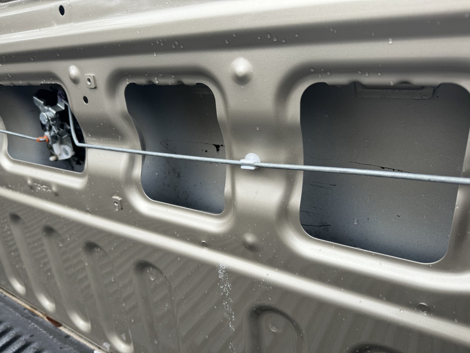

    @shifty
    another big thank you. I got the mid bar stabilizers today when I still had my covers off. That rattling have been annoying the piss out of me. Already had been trying to come up with another solution since I didn't even know the stabilizer clips existed. I suspect the body shop did not replace them when they replaced the tailgate many years ago after someone backed into me

    Tailgate looks good! You probably won't need it right away, but next time you're in there, lube up the bar and plastic at that spot so it's sliding in and out easily if not already done.

    Already did after reading this thread and also did all of the moving hardware - handle and latches.
    HUGE difference. Feels like new

    Did mine last night. Feels great now! Getting those old clips out was a pain. Ended up just destroying them with pliers until they came out. Thanks @shifty`

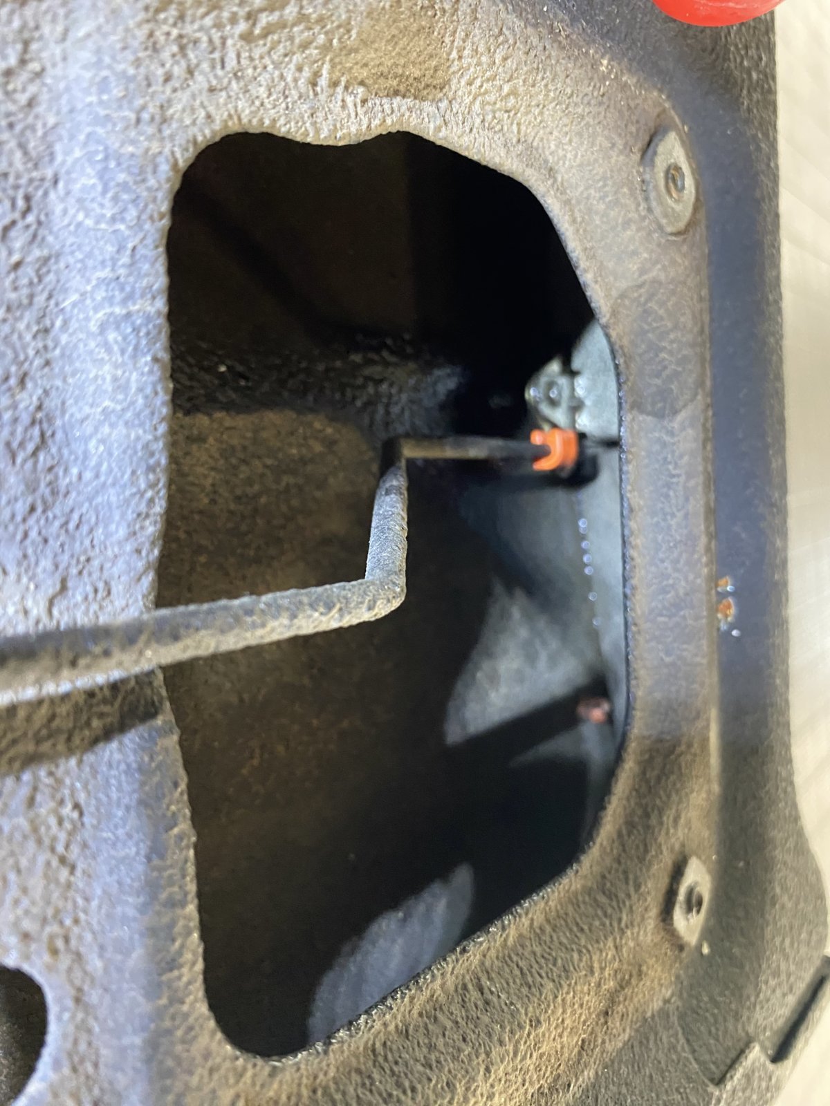

    That was easy. Damn thing finally opens with one hand and one pull! I found it best to remove the latches to access the clips instead of reaching from inside. I’d like to thank LineX of Charlotte for spaying EVERYTHING :mad:

    The orange and purple parts are for 2007+ but definitely fit our trucks, and they’re way more stout than the wimpy ones ours had from the factory.

    Everything fit my 05. The only problems were figuring out where to click the new handle assembly into place, and then getting the new end clips into place at the edges of the tailgate. They don't go in if you have the relay wire in them! Pliers helped with aligning them... just an awkward area to reach.
