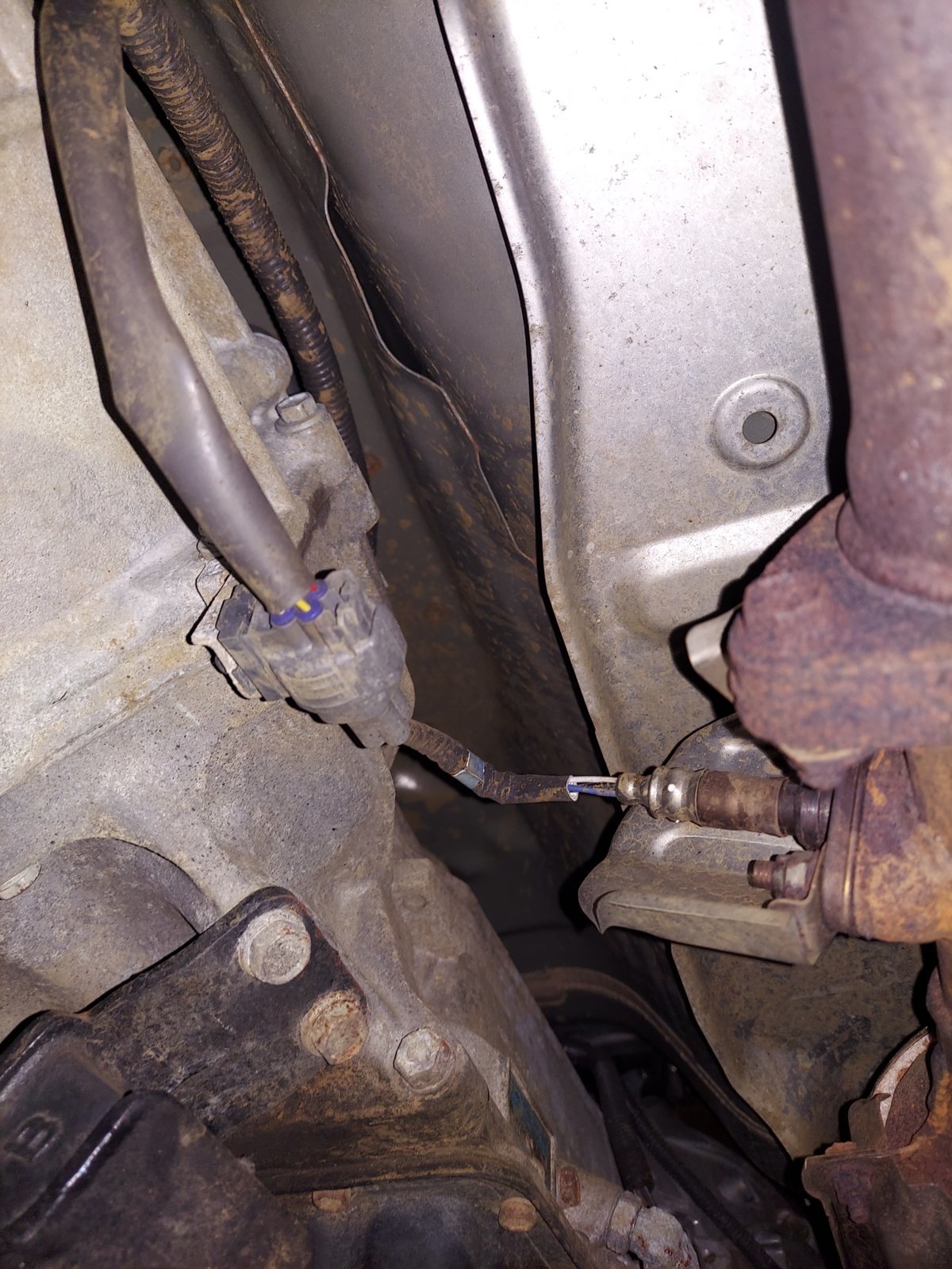

    Yes i will be installing them when I refresh front end. Keith "dirtydeeds" is correct. The " biggest" part of the header i stall is just the bitch of installing them. Unless you are a race only and truly race only. You keep these20231127_115550.jpg
    * keep the cats and you secondary O2 Will Be fine. Your primary O2 that determines fuel trim ect will be fine or require a " spark plug fouler" " upgrade" at most. You should not get any codes with Dirtydeeds Long Tube header upgrade. Keith- do you keep bung for primary O2 within lenghth of factory wires ? Or do you have to lenghthen. ?

    You have to lengthen. Your best option is cut and solder. Use shrink tube. 3m tape. Split loom 3/8” conduit. It’ll look oem and be watertight, unlike plug n play extenders.

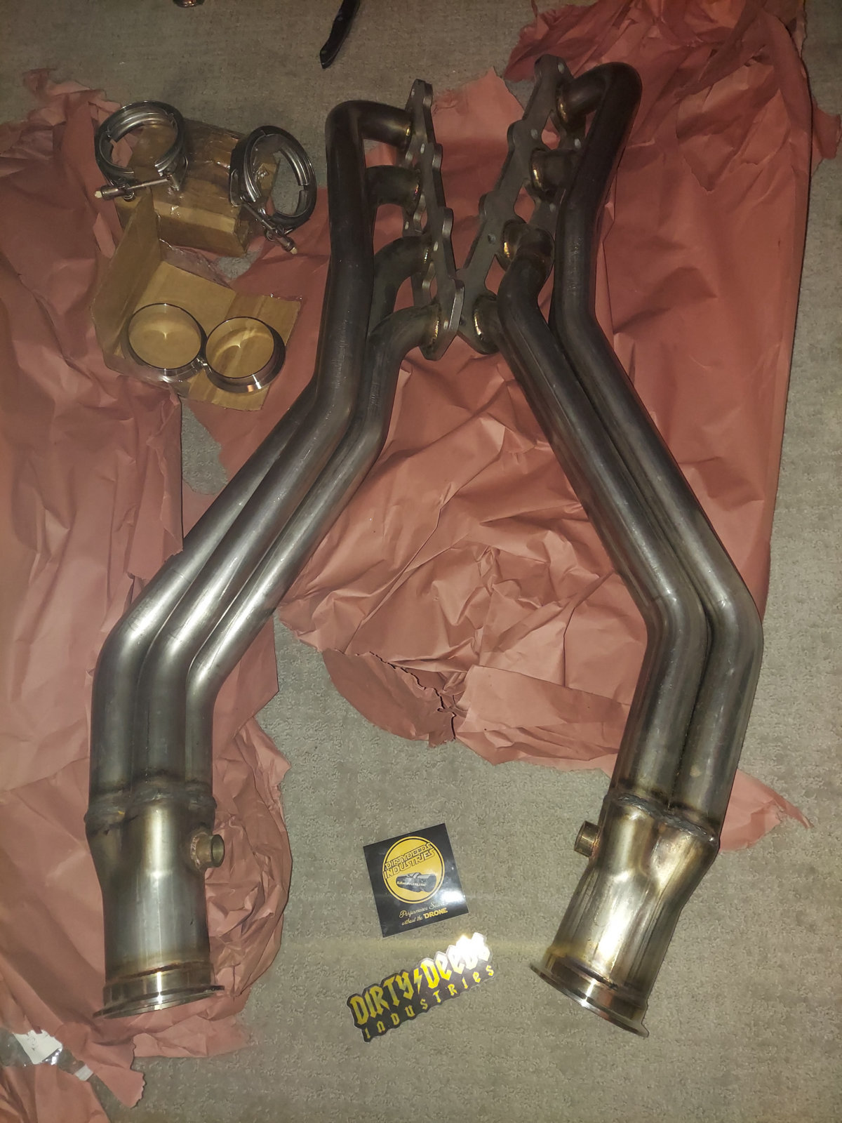

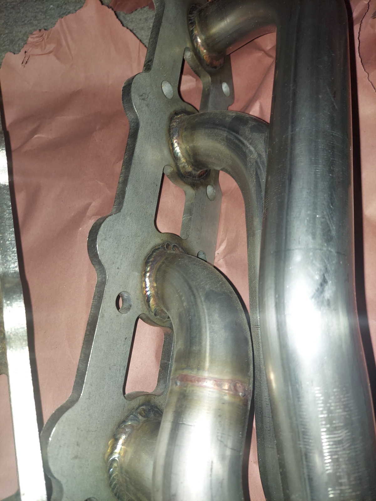

    Hey guys check first post for updates! Just received my set of DIRTYDEED's LTH's!
    - initial impression is they look solid and well built. Flanges are true and high quality V-bands!
