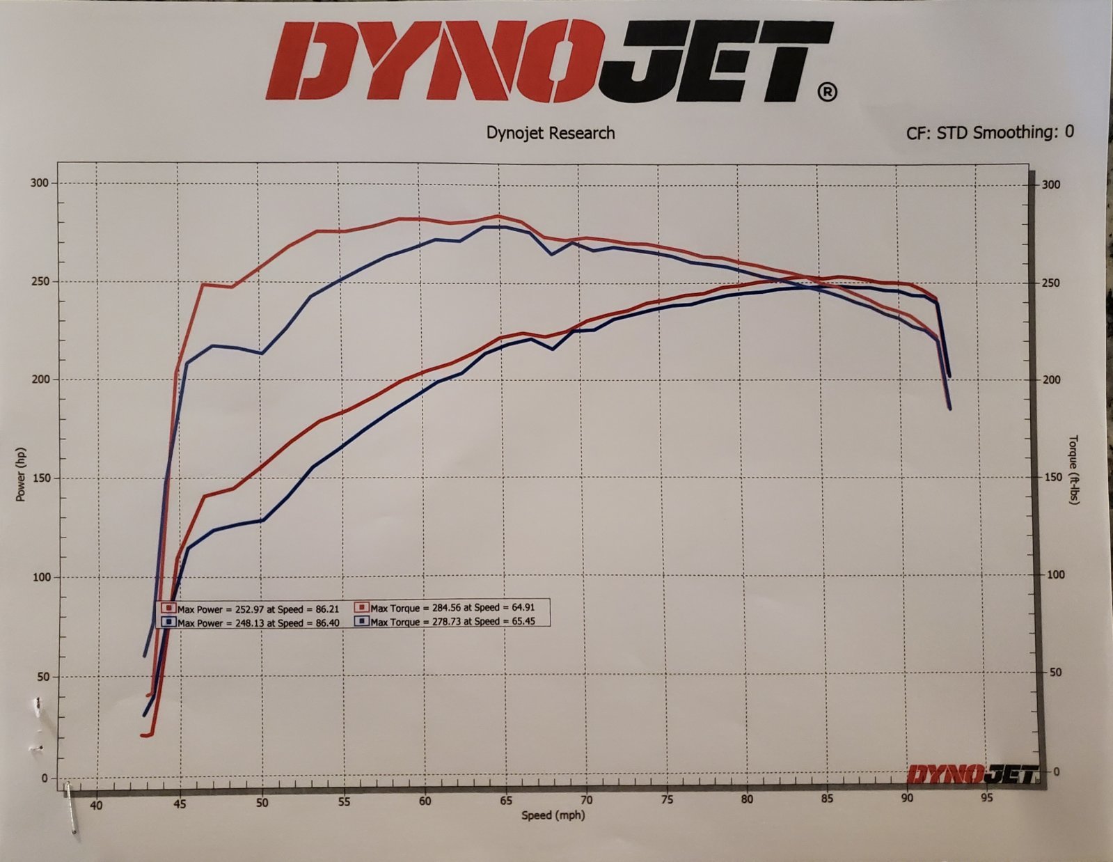

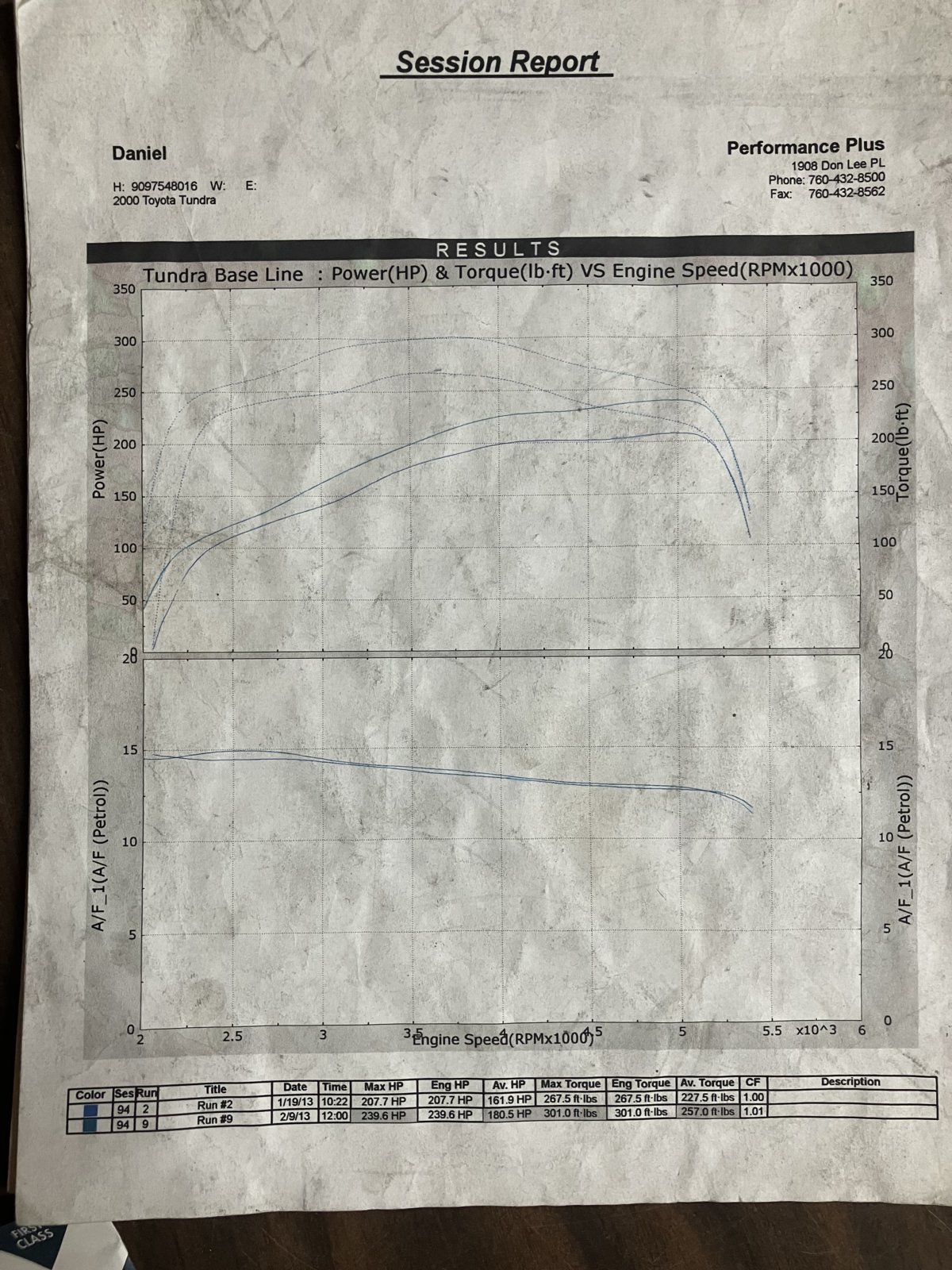

    I’ve been posting Dyno numbers on long tube headers for Tundras for nearly 2 decades. Look up my name on this forum and on tundratalk.net
    I still have the Dyno sheets in my office. I’ll dig them up;)

    Thanks - would love to see them. I keep dibs on the last 3-4 years of posts here, and want to support forum vendors. I haven’t yet found real-world dyno results for the 12-hole injectors, and haven’t seen anything for the long tubes yet. I’m not doubting you, but money is hard to let go of these days so I’d love to make a calculated purchase decision, see how many HP/TQ per dollar I’d be getting.

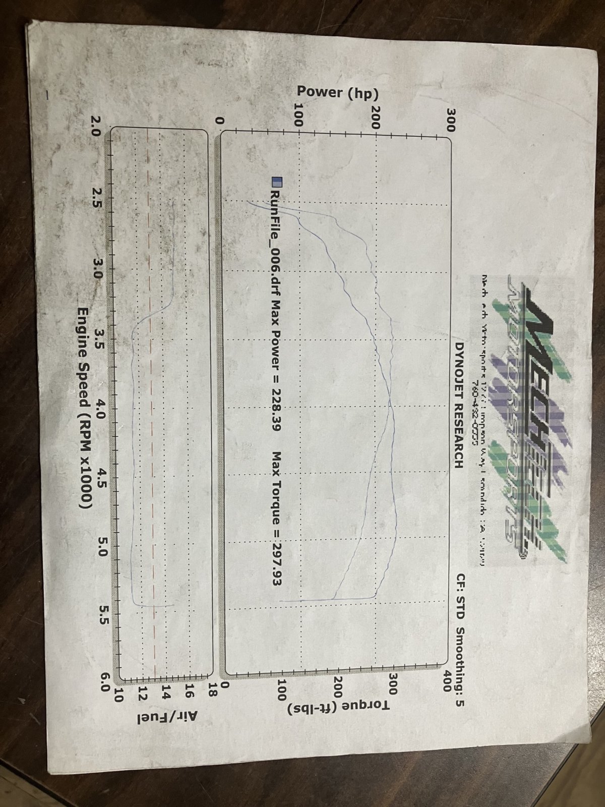

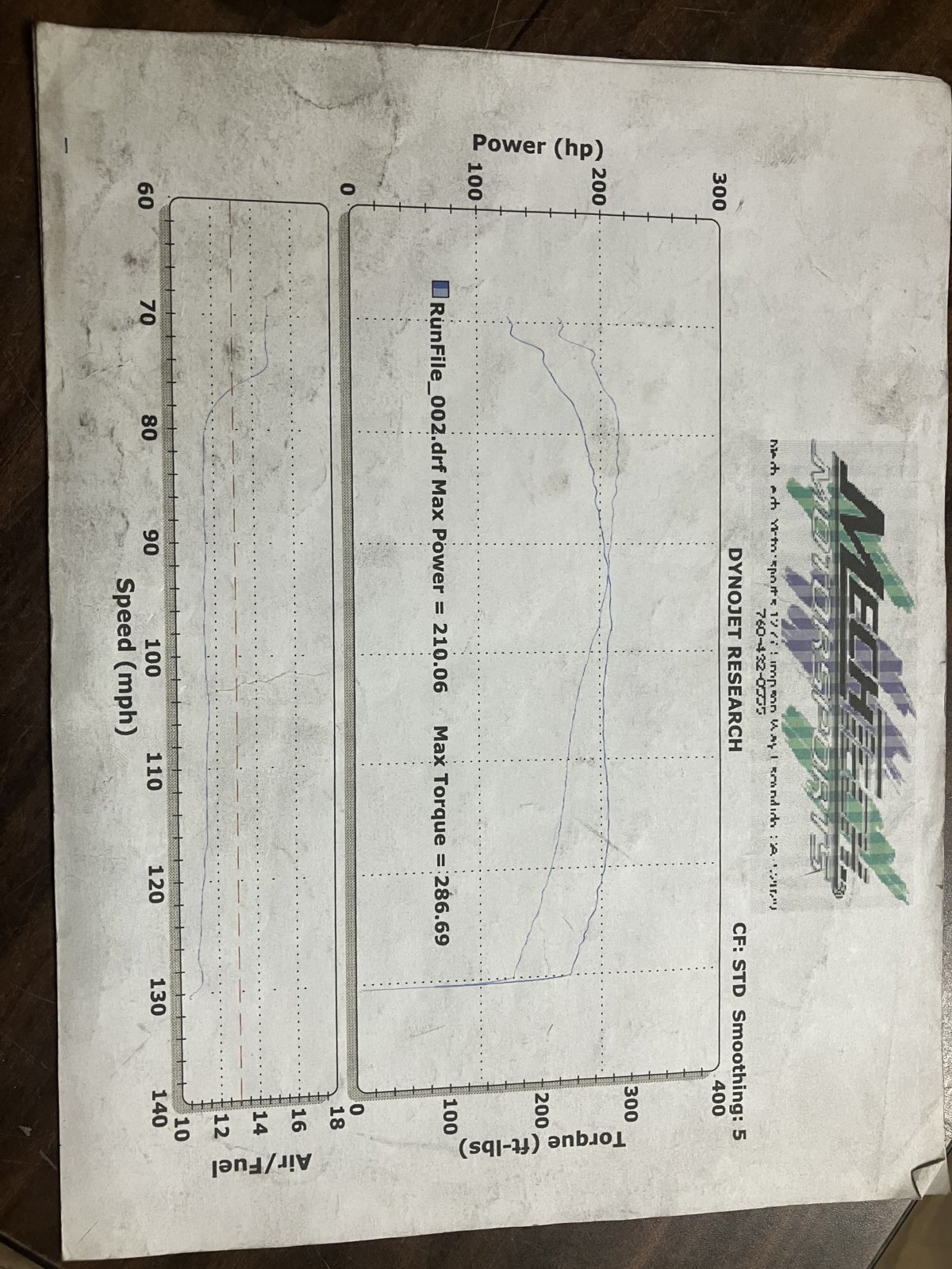

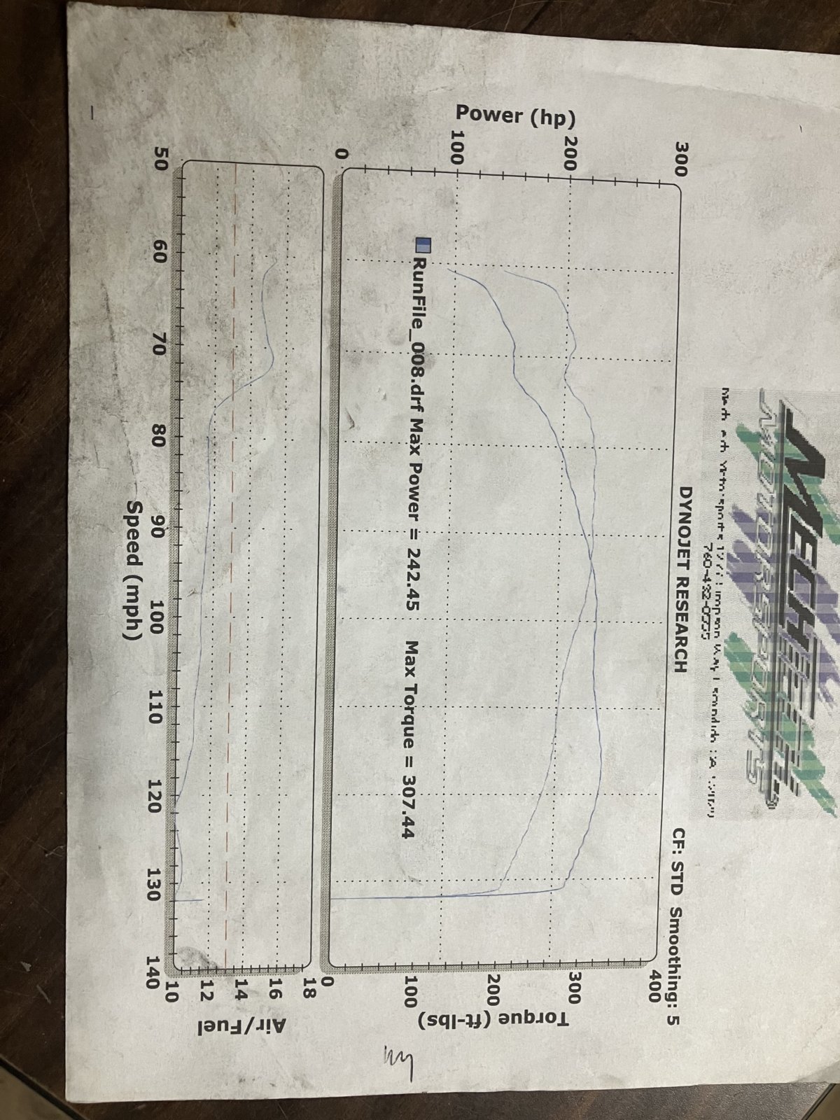

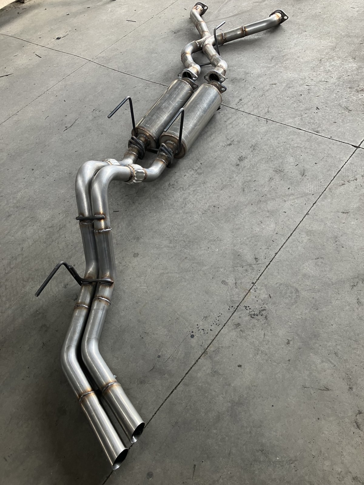

    this is before and after with Pacesetters on a non VVTi truck. It also included our dual race exhaust system. 2.5” stainless steel mandrel bent, similar to the system I’ve posted in a previous pic.
  18. Nov 18, 2023 at 8:04 PM
    #108
    dirtydeeds
    dirtydeeds Exhaust Fabricator Vendor
    Dec 19, 2015
    #2282
    3,332
    Keith
    USA
    2003, 2006, 2013, and 2023 tundra
    more than I can list here
    210 baseline
    228 with single 2.5” exhaust
    242 with dual 2.5”
    I apologize but I don’t have time slips from back then. But the dual exhaust with headers was good for 1/2 second in the 1/8 mile.
    assassin10000 and FrenchToasty like this.

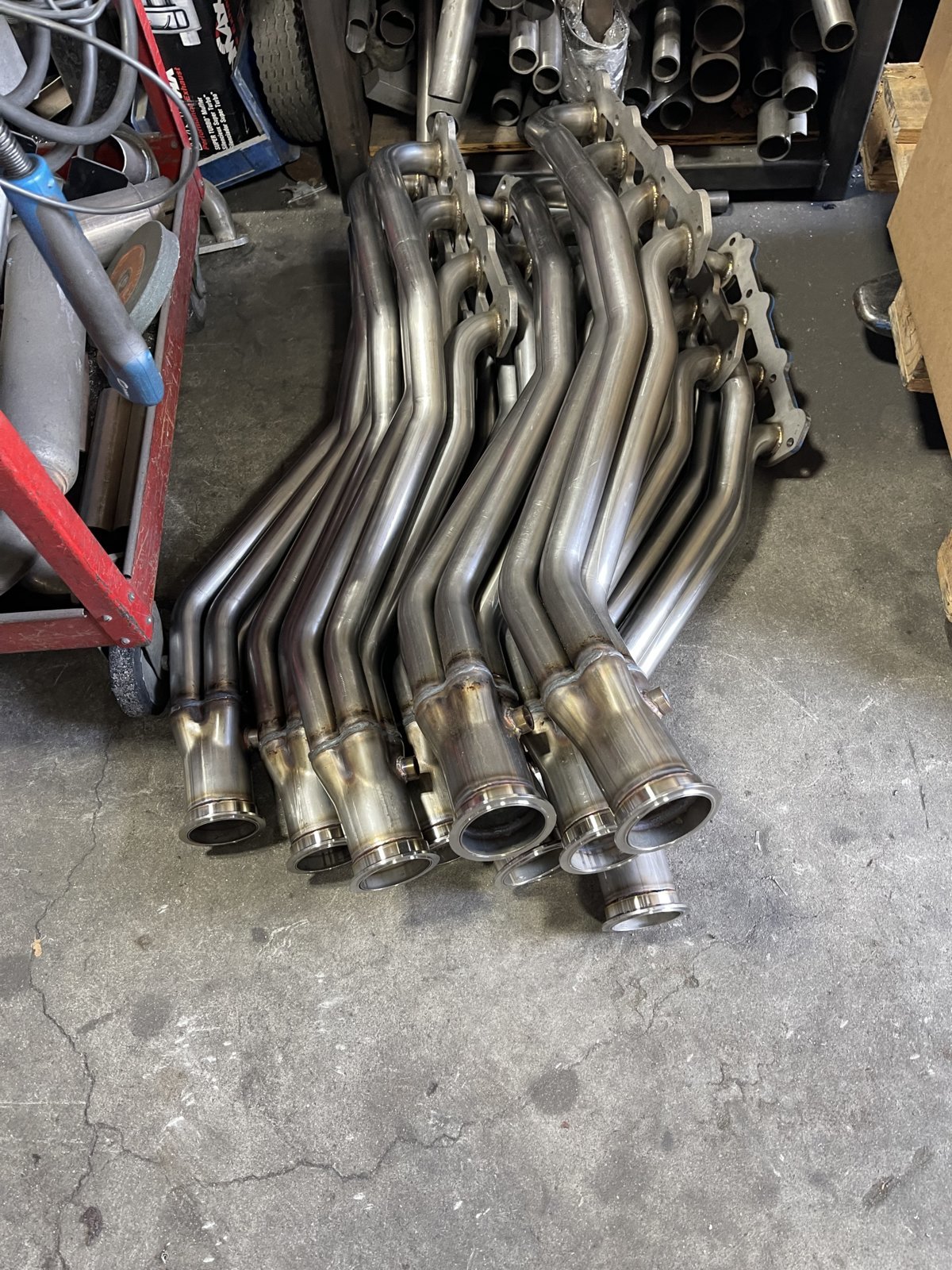

    I’m sure you can find a ton of stuff if you dig back looking at tundratalk.net
    my name there is DirtyDeeds
    also check out tundrasolutions my name is escondidotundra
    also search a thread I wrote: how a properly built exhaust system works
    You’ll see I’ve been creating exhaust systems for tundras for a long time. I have prototyped literally thousands of systems for tundras. I’ve built tens of thousands of systems for tundras.
